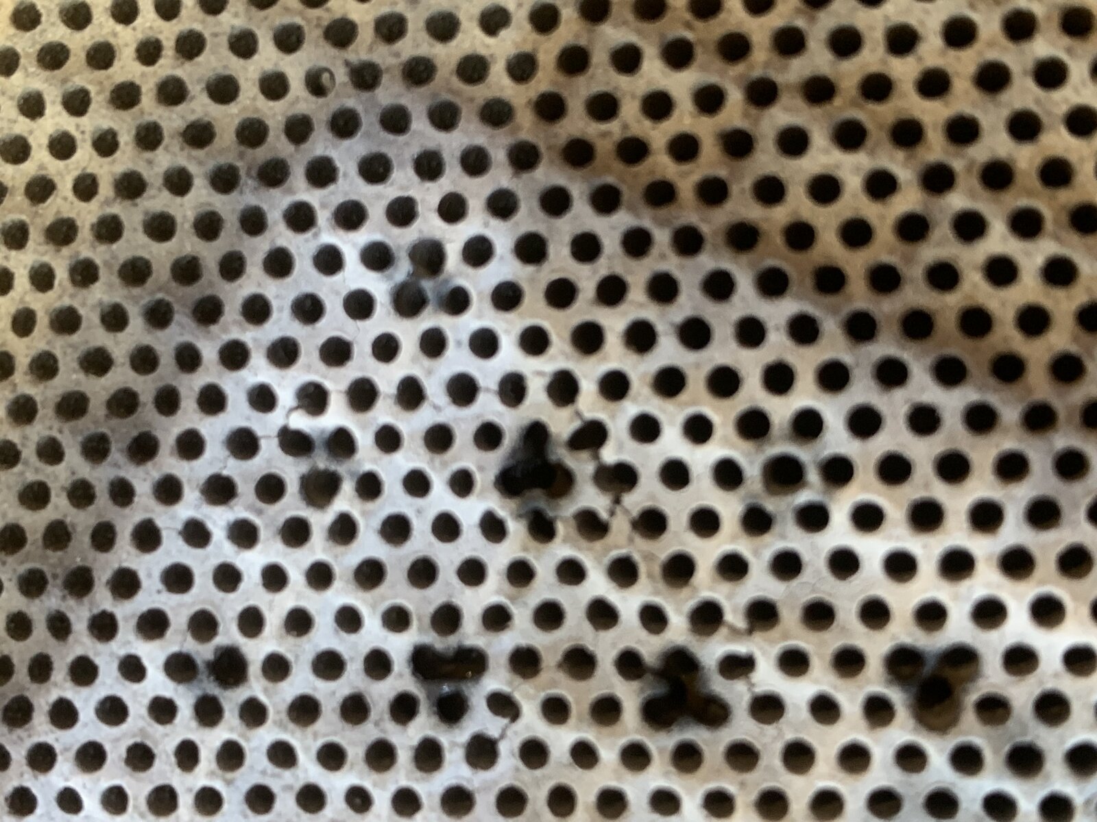

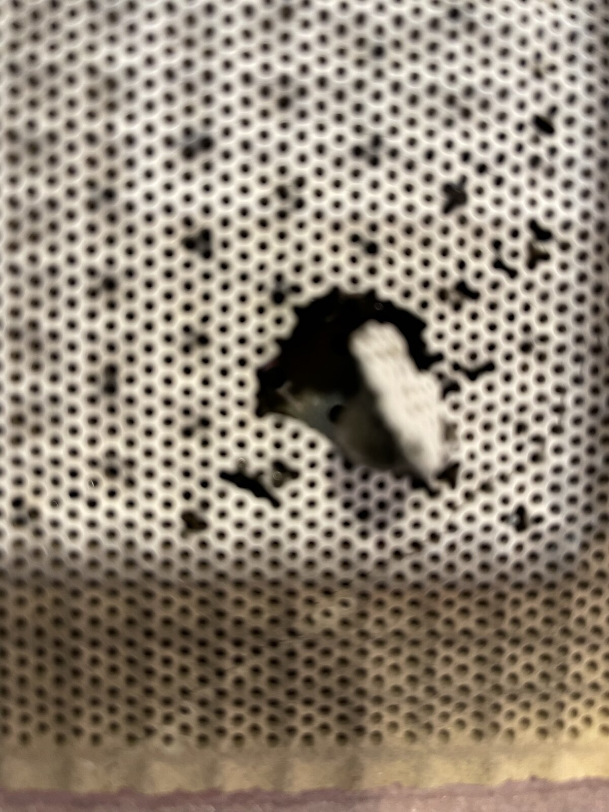

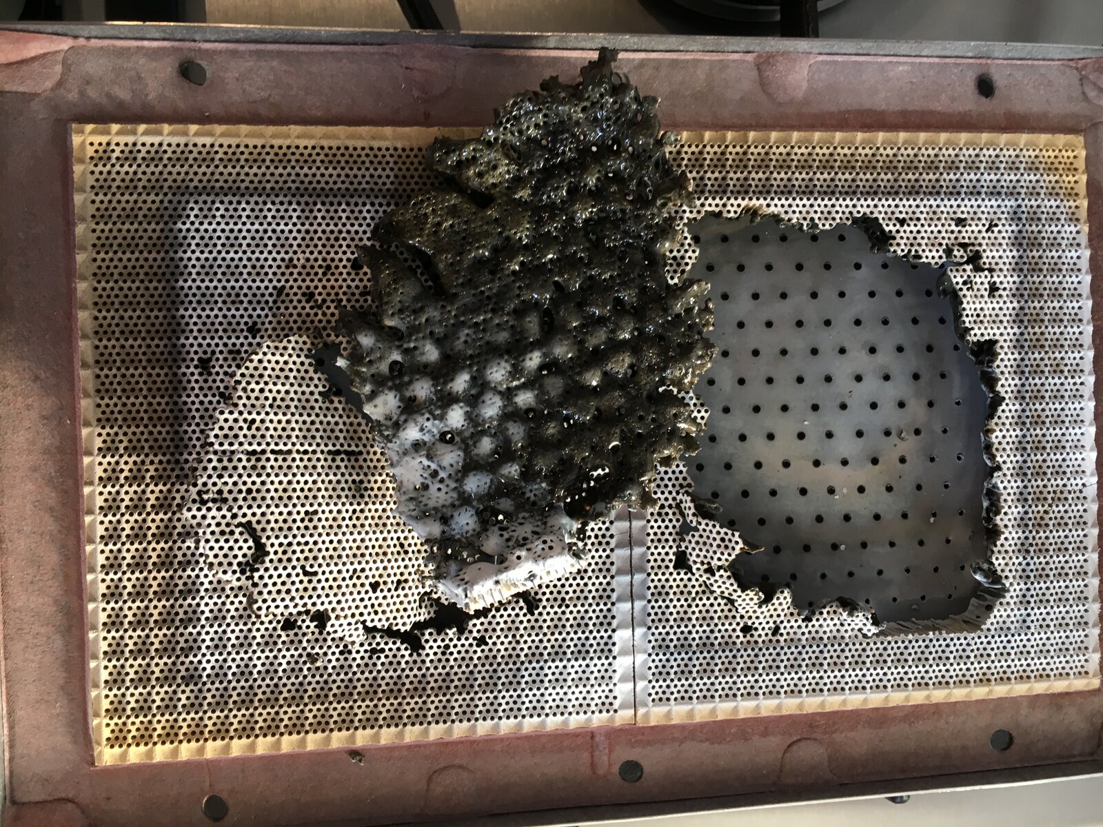

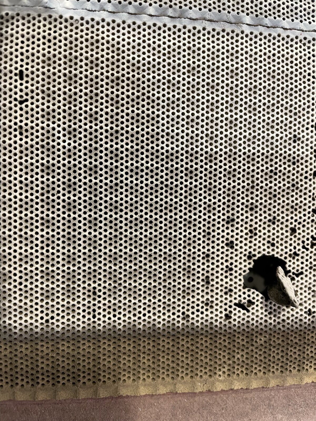

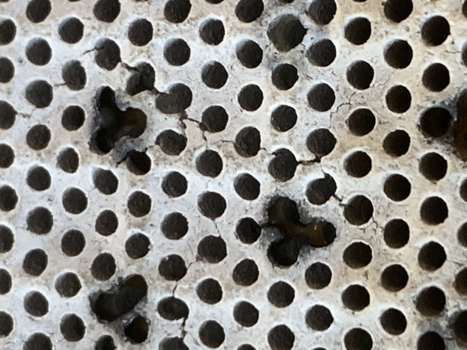

Boiler is trying to tell you it needs looked at.
Better get it done like yesterday before you end up causing some serious damage
