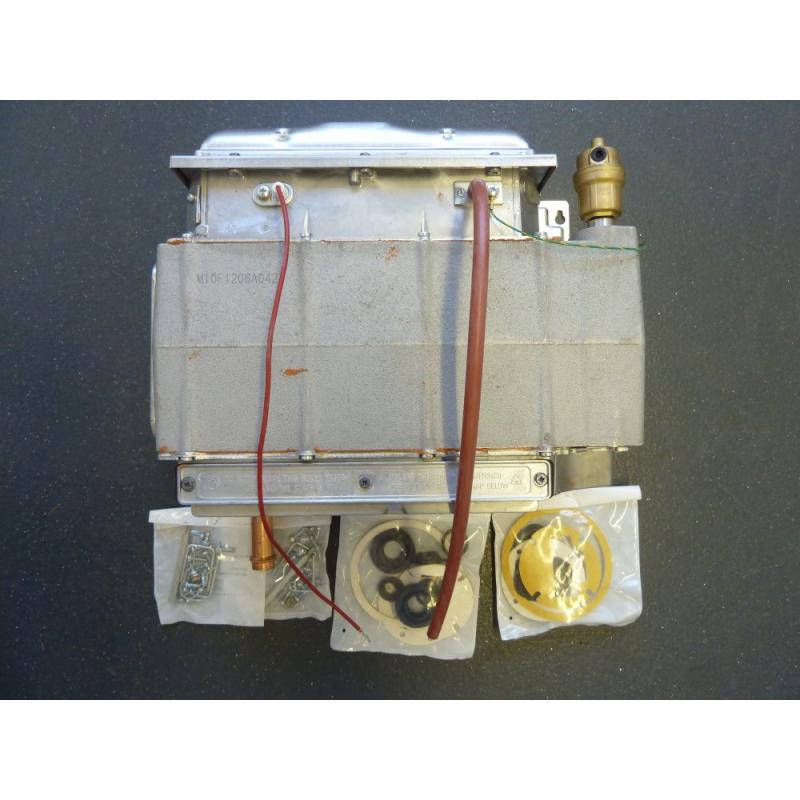

Ps the main heat exchanger will be gubbed if it hasnt been serviced in 10 years so good luck.
£400 part on this and a guarantee its gone.
