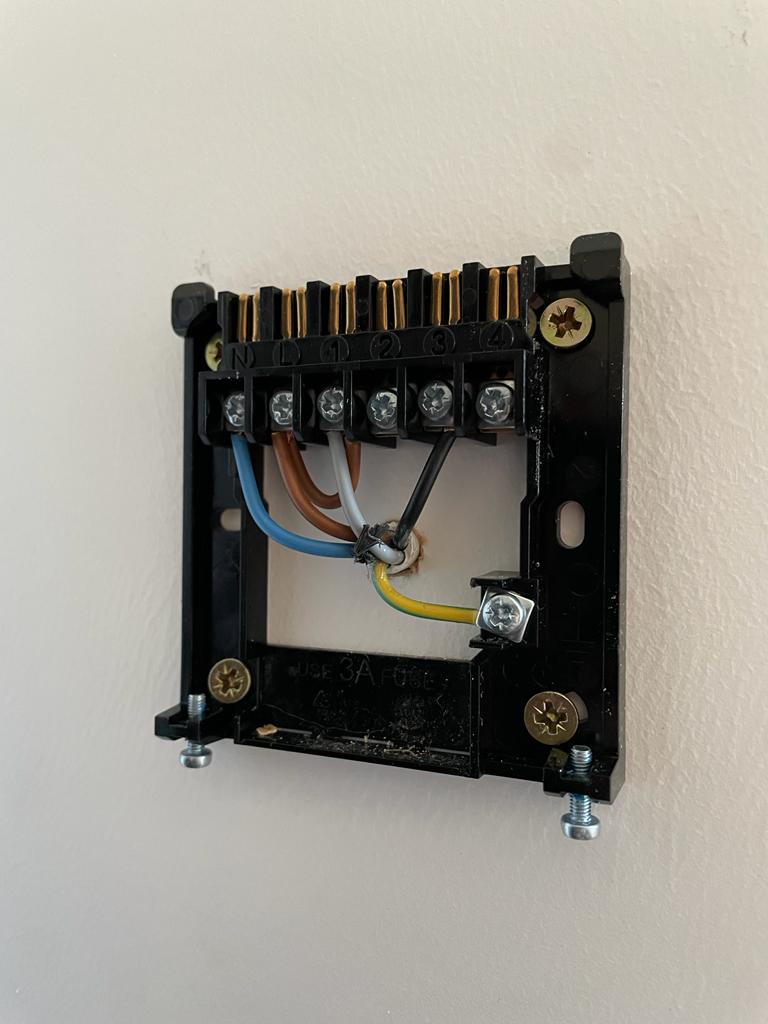

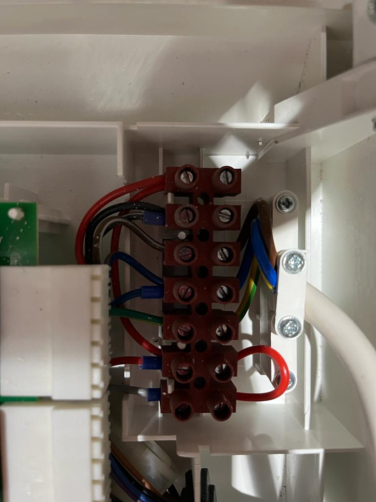

Could my wiring of the Drayton controller done it? This is what I had. Live coming from the brown and the two switching wires going to the room stat terminals on the ideal boiler. I have seen one picture of a single switching wire coming from the Drayton but their instruction seems to suggest there should be a switched live and return
that link between L&1 should not be there, in pic one you have the N coneected to a grey wire then in pic the grey wire is connected to the live wire, when did you move them ?
Are you sure? The instructions state "Power needs to be put on to terminal 1 either by linking from L or a sperate supply". The supply comes from the boiler so my understanding was that it should be there
The link between L & 1 would only be required if there was a similar link on the Salus. Do you have a picture of your Salus wiring. Note your comment "Power needs to be put on to terminal 1 either by linking from L or a sperate supply", that's the grey wire for your system which is the separate supply.
So the live is coming from the grey switch wire? There was no link on the salus RF itself. There was a link between the room stat terminals in the boiler
This was original wiring
The Wiser installation instructions are not very clear for a 1-channel installation. Often a Combi boiler will have voltage free switching which I suspect is your situation. In your case the function of the 1-channel Wiser hub is to "join" terminals 1 & 3 together when on and "disconnect" when off. The Wiser itself needs 240V power but that only goes to L & N. Effectively there is electrical isolation between L/N and 1/3.
