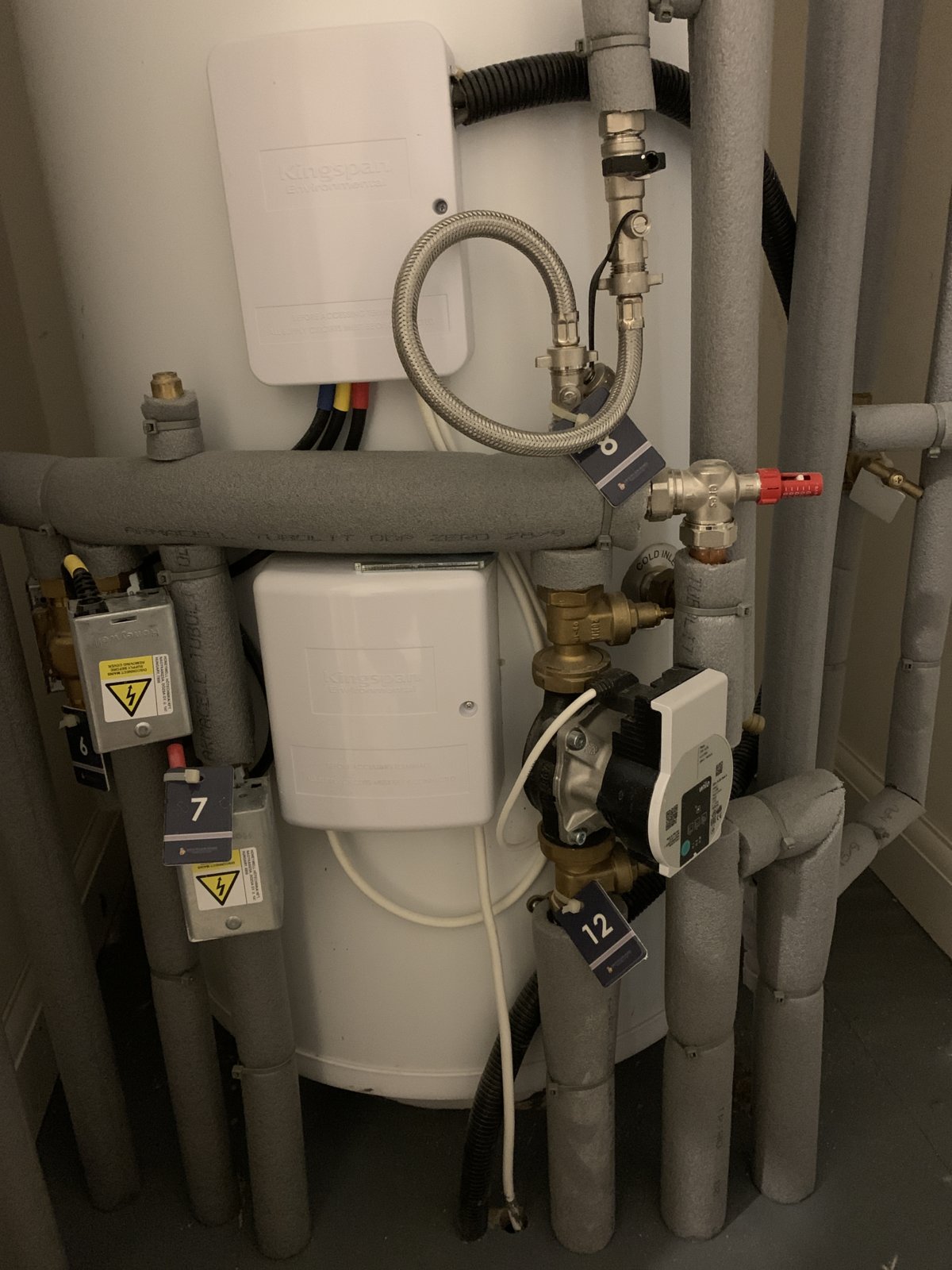

I see 2 motorised valves attached to the KingSpan upstairs and a pump. Image attached if it helps.
From picture I can see three motorised valves and a pump, but not sure if the tank is a heat store? With a heat store the boiler runs at most efficient rate for a long burst rather than needing to modulate, and the variable speed pump can supply radiators as an when required even if only wanting 2 kW I have never worked on a system like this, I only know they exist.
My brother-in-law had it with his old house, main advantage was 4 heat sources all running one central heating system, back boiler on wood burner, solar panels, immersion heaters connected to solar panels, and a LPG boiler all fed in as required.
There are many reasons for having motorised valves and pumps, one house I stayed at had circulation pump for domestic hot water so you did not need to wait for hot water to arrive at taps.
It does seem from the instructions the boiler does not have an internal pump, so to be a heat store I would expect at least two pumps. So I may be completely wrong, so I suggest you wait and see what others say who may recognise the system. Personally I would not fit any replacement thermostat without being totally sure what I have.

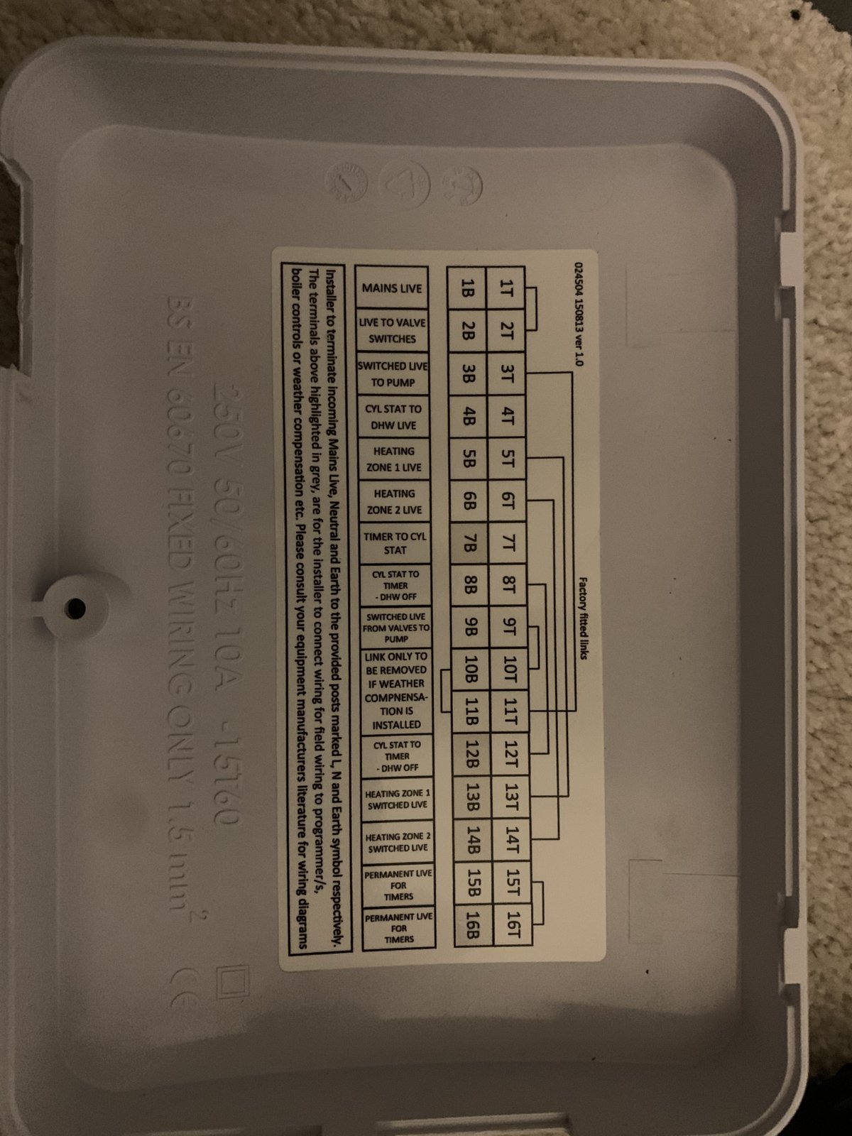

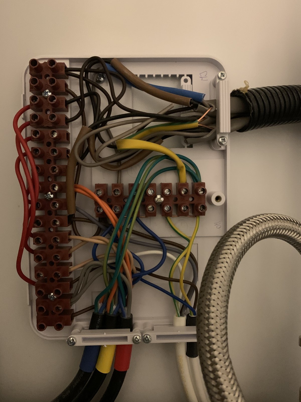

It appears the Heatlinks fit in at the top control panel on the HW cylinder.
Just need to decipher the attached photos to figure out where the 2 Heatlinks plug in.
