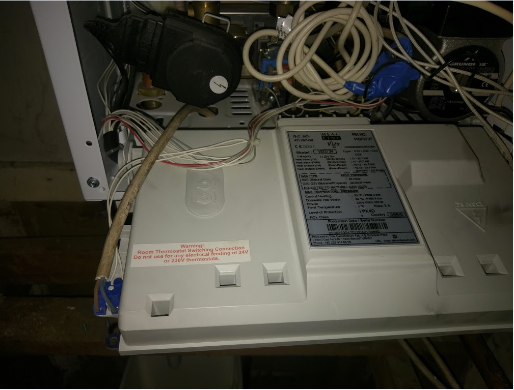

Ok so i have now traced the cabling to see how the boiler and existing thermostat connect.

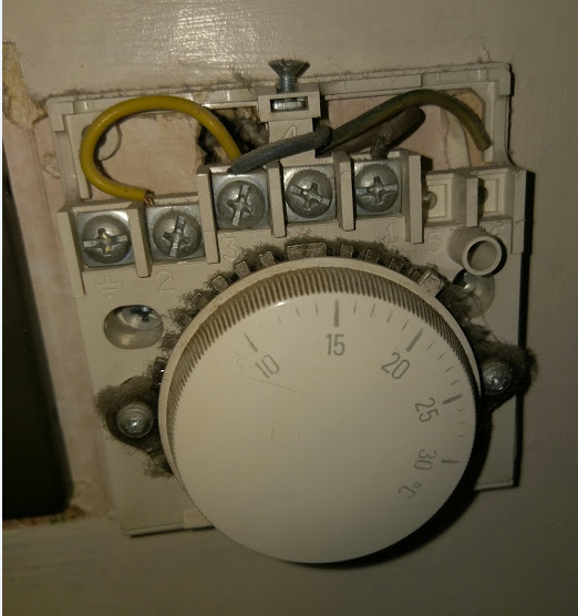

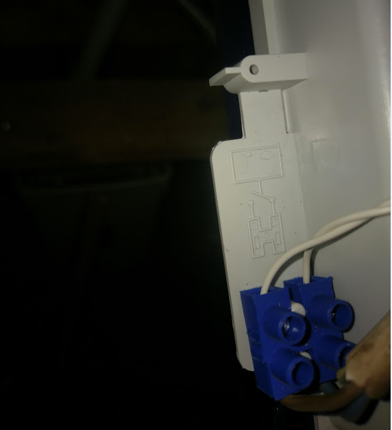

There are 2 connections coming from the boiler in the below image. Brown and blue going to the thermostat (honeywell t40)

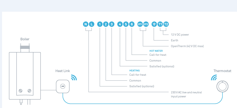

what im thinking is connect the N and L on the nest heatlink directly to the fused spur to power the heatlink separately. Then connect the brown (1) from the old t40 to the (3) connection (Call for Heat) on the nest heatlink and the blue(3) connection from the t40 to (2) connection(common) on the nest heatlink.
The nest thermostat will connect wirelessly from another room powered by usb.
Does the above sound about right?

With the right model of boiler the new Nest can produce quasi weather compensation. That means increasing rad temps when its cold outside and vice versa. That can increase boiler efficiency by achieving maximum condensing.
Unfortunately on your model, all the Nest can do is to turn the boiler heating on or off at whatever flow temperature you have set on the front panel knob.
An expensive toy just for the fun of talking to an on/off controller!

I just registered on this forum to thank rjp90. I just got a nest with a Heatline Capriz 25 and was completely confused by how to power the thing off the 240v supply. The pics and diagram you posted helped me and it's fully working. Saved me £90 on the quotes I was getting.
Thanks!
