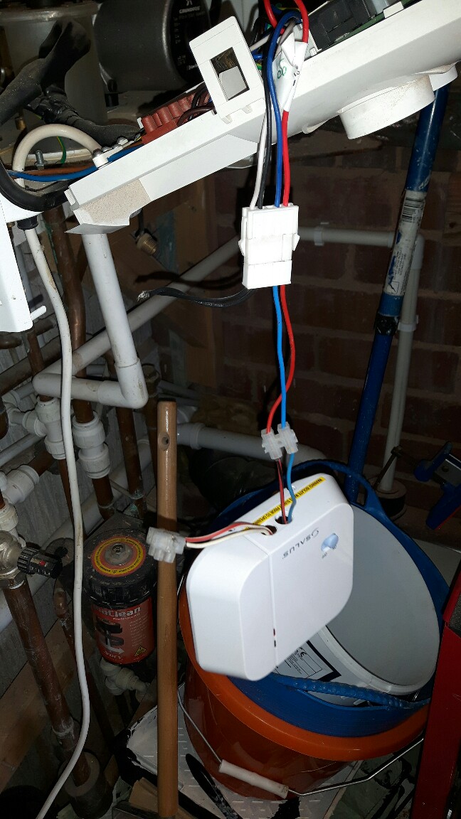

Ideal Logic 30 combi - not switching on
I’d call someone out to have a look. You’ve got blue and brown coming out the stat connections.
I suspect you’ve got an open line
Just removed them and replaced them with a loop, the display showed rad temp and said central heating.
Just switched it back on and will test and get back to you
We appear to have heating, i'm assuming that the blue and brown went to the old wall stat, has not been in use since this boiler was fitted about 4yrs ago
Not even on the wall, very strange
