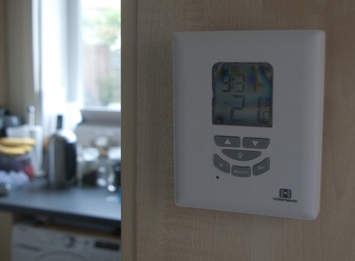

I have 'something' in the boiler cupboard that's linked to the Danfoss wireless panel downstairs. The boiler and thermostat are currently behaving which is so frustrating...yet nice too....but I know that it'll go wrong any moment. Here are the pics of the thermostat and the one located by the boiler. I may have to wait a while for things to go awry with the heating. It was fine last night and then just decided to heat up in the middle of the night.

No. When it's running the CH1 lights up and I normally get the flame icon on the thermostat. Although the flame hasn't been showing the past few nights when it's been showing as 17 degrees yet the room is like a furnace. It's running well right now, so I'm keeping an eye to see if it goes wrong.
That is why I asked for pics of everything at the same time when the boiler should be off but is actually running, only way we can tell you if it is the controls or the boiler
Yep. That's what I have resorted to over the past few nights. Thanks Polesapart
If the light is on at the receiver then it will fire the boiler, regardless if the receiver is sending it or not.
If the light is not on but the boiler is running and heating the rads then the boiler is getting a live supply on its switched connection from "somewhere"!
And as you said earlier the relay could be sticking - the LED wouldn't illuminate in that case.
The OP could give the RX1 a sharp 'tap' and see if the heating switches off.
Otherwise, the RX1 could be removed completely, if the boiler is still on, then there is definitely an issue elsewhere!

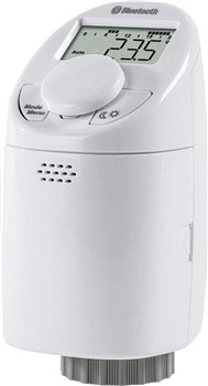

Two things, I had this IMGP8037.jpg thermostat which gradually lost the RF link, and would not always fail safe, this
was designed to fail safe, and if no signal received every ½ hour it would close down, not read instructions for your thermostat.
But the second is, even if it does stick on, the TRV's should stop any over heating, the boiler may start cycling too much, and unless using a programmable type EQ-3 Bluetooth Smart Radiator Thermostat.jpgthen they only have one setting night and day, the one shown however can be programmed, and at £15 each in 2019 it seemed the sensible thing to do.
But for rooms to over heat there must be at least two faults, as well as wall thermostat the TRV's and/or lock shield valves must also need adjusting or renewing.
I am not saying the wall thermostat does not need fixing, as in the summer unless fixed the boiler will be cycling all day, but there must also be a secondary fault.
