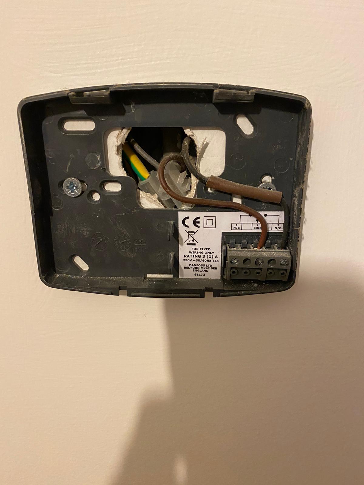

Hi,

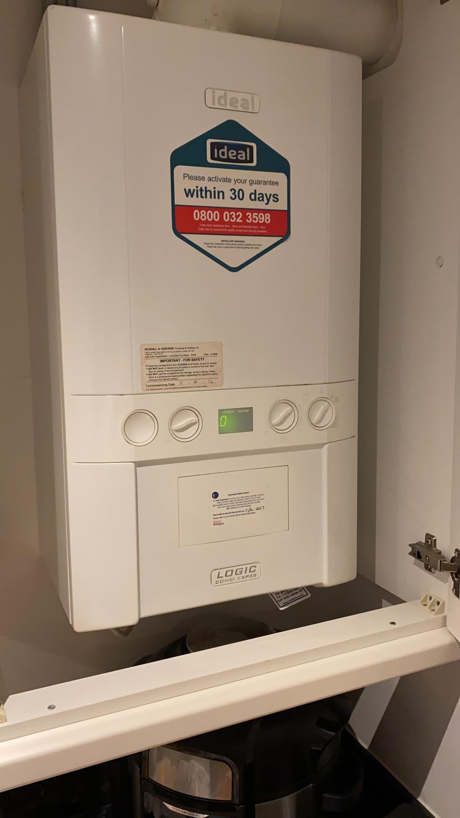

Hope someone can help me. I want to instal a Hive for a friend.
I’ve got an Ideal Combi ESP35 with a Danfoss programmer. The wiring doesn’t look quite as it did for mine. Not sure what I need to do / add. Please see the pictures attached
thanks I’m advance.

Brown and black is your call to heat. Likely brown is live, black is switched live. Or it could be a completely different switching voltage from the boiler. You will also need a power supply for the hive. You best to find the other end of that cable and see if the grey could be used for a neutral for supply.

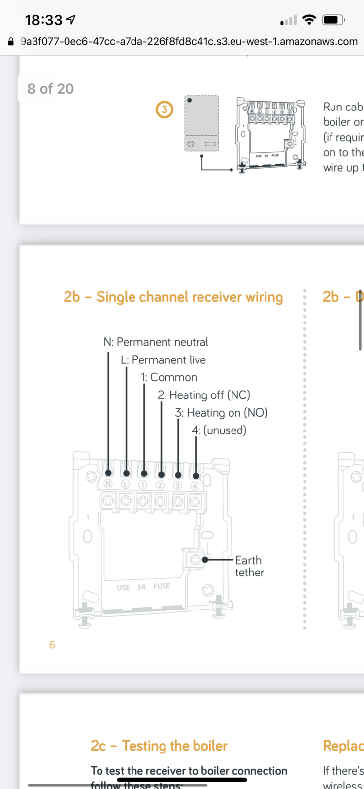

Ok thank you... so going with the hive wiring diagram...
N - possibly there?
L - brown
2
3 - black
4
Brown to 1 (com), black (sleeved brown) to 3 (NO). But you need to check what voltage the existing is switching and if a neutral is present. If so then link the brown also to L and the grey sleeved blue to N. It is important to check the boiler wiring or risk damaging the boiler.
I would do a search for name of boiler followed by installation instructions.
Then see what the standard connections are for the thermostat, there are three common methods, 230 volt, 24 volt and ebus, most common ebus is OpenTherm. Clearly at moment simple on/off.
Often you can select which option, so check if sealed cover for electrics and if not have a look on how already connected. Many boilers have 24 and 48 volt one side and 230 volt the other, so simple looking which side cable enter may help.
The Hive base unit should be fitted near the boiler or wiring centre where all required wiring will be available and the Danfoss cable will then be redundant.
A shame to fit a Hive to an OpenTherm-compatible boiler, it'd be much more efficient with an OpenTherm stat such as Nest or Honeywell T6 (although that would require you to remove the boiler casing, which you shouldn't do unless you're Gas Safe Registered, but it looks like you might need to go down that road anyway...)
