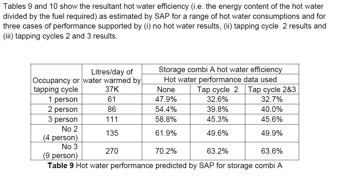

There are two types of test result.
(1) The results obtained on a test rig that the manufacturers use in marketing
(2) The results that affect the running cost in normal use of the equipment.
Manufacturers get the highest efficiency rating by running the boiler continuously for a prolonged period.
This table is the independent test results by the Building Research Establishment operating the boilers in the various ways they would be used in a domestic installation
Is the Building Research Establishment (who found efficiencies as low as 33%) owned or run by the manufacturer ?
I've told you before how little my regard for the BRE is. I was referring to the test house that have the 122% rating you have a bee up your arse about.
