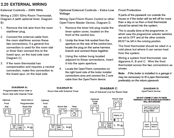

The instructions for "pro setup" are well hidden; but I managed to find it. It says you have to enter your "Pro ID number" to gain access; presumably to prevent "unapproved" installers fiddling about. It doesn't mention Opentherm and the wiring diagrams are USA orientated, so it may not be the UK version - which I cannot find anywhere.

It was the setting as per Paulj48's post. Turns out the term used by Nest is "Supply Temperature" so the installer thought that was referring to the main water supply temperature and entered something like 7 degrees. As a result, the Nest put the boiler on its lowest possible setting and that's where it stayed.
Also, the red link does have to remain in place, Ideals instruction that it be "must be removed when adding a Room Thermostat/Timer" is wrong when the aforesaid Room Thermostat/Timer is wired to the OpenTherm terminals. It didn't work at all with the link removed.

That’s because you aren’t adding a 240v room stat or timer are you?
You are adding opentherm controls to the low voltage side of the boiler, so Ideals instructions are in fact correct.
Once you know, it's easy to say that, but the Nest is definitely a Room thermostat/timer, and the instructions state that; the link creates a 'permanent call for heat' and must be removed when adding a Room Thermostat/Timer.
So if the link's in place it says that there would be a 'permanent call for heat'. The 230V terminals you refer to aren't mentioned, and that is the problem. There should be some differentiation between the two methods of connection. It would be better to say that ..the link must be removed when adding a Room Thermostat/Timer, except where the Room Thermostat/Timer is connected via OpenTherm.
Sorry, I mistakenly thought the product was marketed as a 'Nest Learning Thermostat', not a 'Nest Learning OpenTherm controller'.
Isn't just a case of following the relevant instructions?

If you have a 230V thermostat, you follow those in the first column headed "External Controls - 230V", and diagrams A, B or C as appropriate; and if you have an OT controller you use the instructions in the middle column and diagram D.
