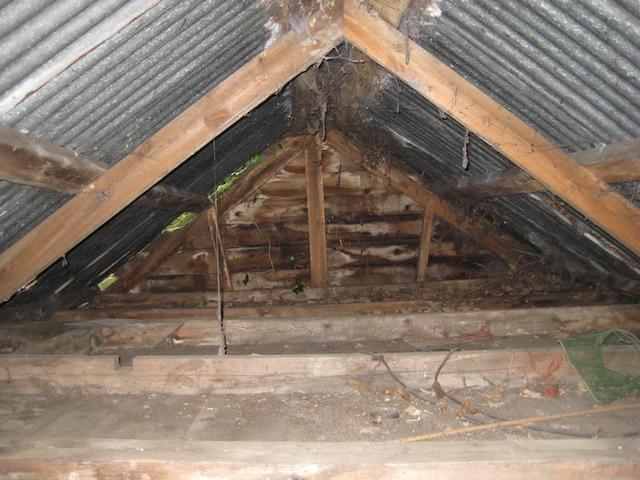

Here are a couple of photos of the current Summerhouse that I want to rebuild/replace.
Does look as though its reached the end of its life, I think the undergrowth is whats holding it up ;)
