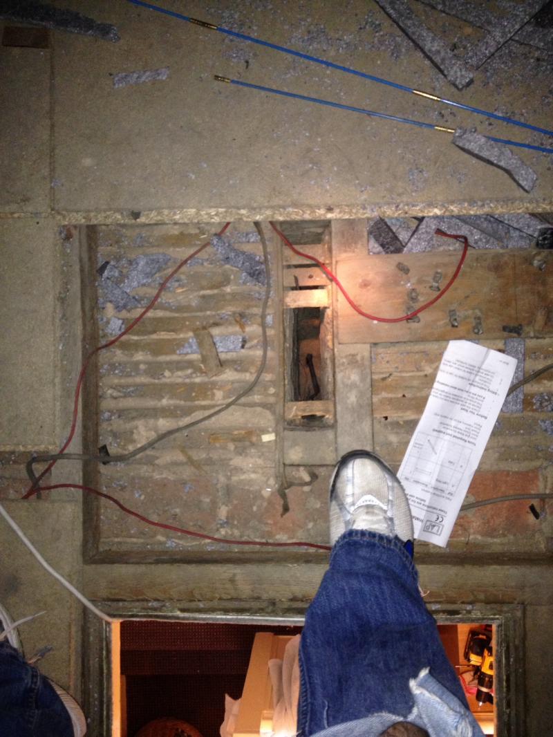

I'm trying to run some 1 mm T&E from the loft to to CU.
Just struggling to work out the easy way to get the cable routed.

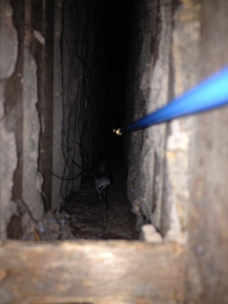

I have located and sorted a route down the middle of a stud wall, through the first mid-beam but then there seems to be a blockage.
So really old electrical wire exists but this will not come out even with brute force, the cable just shreds if pulled.

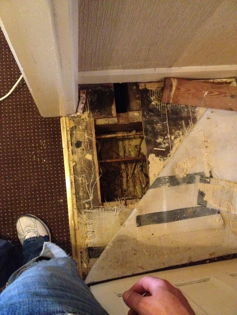

I can drill a hole from below as there is not enough space below the floorboard for the drill, and drilling downward would need a 3 meter drill bit!
I've added some photos but not sure if they help. Any ideas?

Do you mean you can't drill a hole from below?
If you can get through from the top, and through the middle noggin...
... can you cut off that old cable at the bottom, push the end into the void, and fish a new cable/draw wire out of this hole at the bottom?

Yeah I can't drill from below, it's 3 m to drill from top.

These types of walls usually have some diagonal studwork - dropping down through the walls vertically can be challenging depending on where in the wall you are.
Similar to this, although this seems to show "let in" timber, not occupying the full depth of the wall.

Right angle drive could be an option. It's hard to work out how far I'd have to drill through and to check exactly what it is going through.
