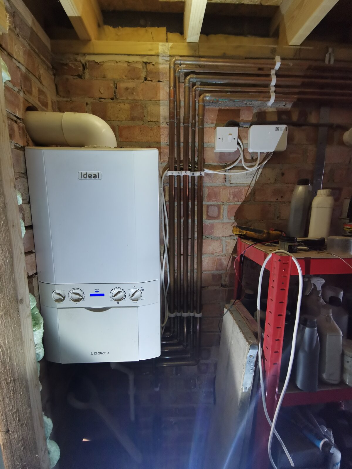

Hi all,
Above is a couple of pictures of my boiler and it's pipework, in the first picture I've labelled the pipework on it clips, from left to right it's marked 1, cold, gas, hot, 2.

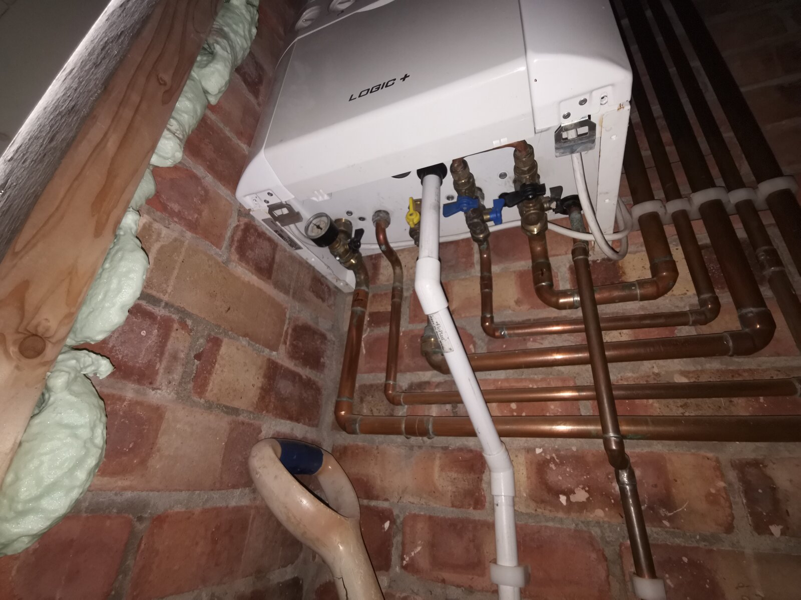

I know the cold, gas and hot are all correct as they were labelled further along the pipework by a plumber, 1 and 2 I'm assuming are for the radiators, is one a feed and one the return and if so which is which? The second photo shows under the boiler I've marked the pipework with 1 and 2 respectively.
The reason for asking is I'm getting ready to extend the plumbing into my new extension, gas engineer is sorting the gas pipe tomorrow. The pipe marked hot I'm assuming is the one to use for the hot taps?
Cold I'll be taking from the water main as it enters into the extension.
That leaves me with pipes 1 and 2, I'm assuming the feed goes on the trv side of rad and the return the lockshield side? Does it matter where I tee into 1 and 2, do I need to be doing it off the last rad in the current circuit or will anywhere convenient do?

Flow is the one which is hotter than the other one, which is the return. It is even more obvious the difference in temperature, when the heating first fires the boiler.
2 is the Flow, 1 is the Return.
Is doesn't really matter which way the TRV goes...far more important is that it can sense the airflow returning the radiator ie. don't jam it in a corner or behind a sofa.
Assuming the heat load is miniscule in the new extension it shouldn't matter too much where you tee off the Flow & Return...modern boilers like a wider delta (temp drop) so
the pipe friction is much lower today, but obviously don't extend an already excessive length of 15mm with large rads on it.
More importantly why are the 2 front casing screws missing? You can't rely on those silvery clips for security.
