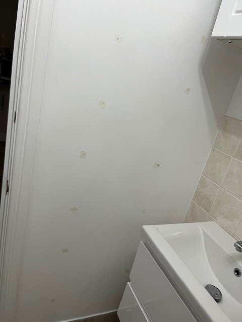

Hi
I have a small partition wall of 810mm wide and about 2400mm from floor to ceiling. I identified screws locations using magnet, pls see photo attached. The distance between column 1 and 2 is about 350mm.
1. Can I assume there are 2 vertical studs?
2. Is there any horizontal studs, where?
TIA
Hi
1. Can I assume there are 2 vertical studs? Yes, there will (or should) be a stud at each end too.
2. Is there any horizontal studs, where? Noggins is the term you're looking for, probably but impossible to tell without opening up the wall, typically there would be one around half way up the wall.
