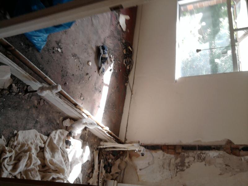

Done and dusted with the knocking of the wall. It was much simpler than I thought. It was down in two hours with a chisel drill.

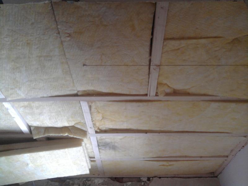

Mineral wool minimum 25mm thick but I usually use 4” cavity bats fixed with spray on adhesive. If you use polystyrene you must protect cables or it’ll attack the insulation.

You can use rockwool, celotex/kingspan etc for insulation, if the space in the wall is 100mm. I would use at least 50mm insulation.
One other point electric cables should not be totally surround by thermal insulation or the cable size may need to upgraded to a higher size, to do with disapation of heat from the cables. As well as avoiding contact will polystyrene, which has been pointed out.

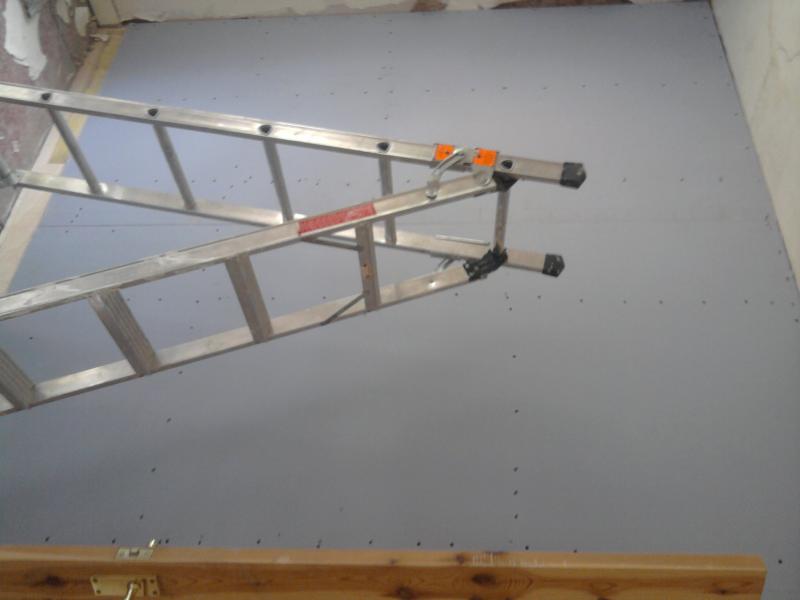

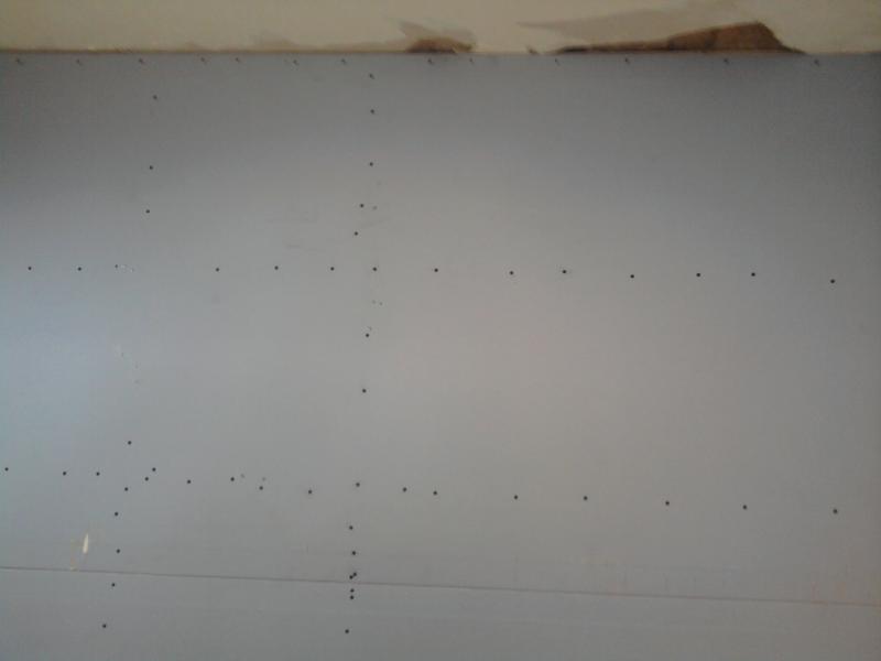

Also best to use dry-wall screws for fixing the plasterboards, not just any old screws you have. Screw the boards along top and bottom plate and down each vertical stud, spacing the screws about 150-200mm of each other.
The spacing there is a bit longer than the spacing I used (Wasn't enough space for two studs), But I have used 3 noggins to strengthen that section.
never stretch the spacings.. if needs be you can shorten the spacings of one to make the difference.. ( ie a 600mm gap then you put 1 to start, 1 at 400 center and the last one 200 from the middle one..)
Sideways photos drive me nuts!
You should have kept to 400mm centres, it does not matter if you last stud is only 300, 200, 100, 20mm etc......to final wall stud.
and make sure you get some screws in the joints, where the boards but up.
Yeah I've added stud behind the joint and screwed them in. I'll try to stick noggins in the wider spaced area.
Oh I did learn a good lesson, always have the plaster board in the room before the studs are up. I had to cut one noggin, to get the boards in the room.
