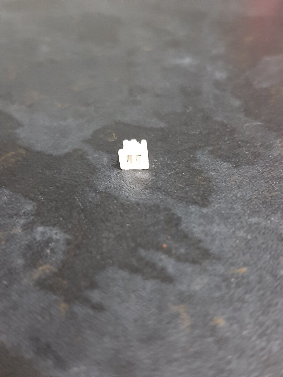

Can anyone tell me what type of connector this is and where I can get one and the metal pins to go with it please?
Not sure what its called but RS or CPC Farnell would be my first port of call
Looks like Molex 51021-0200 to me, this one most likely produced in Oct 2018. Would need straight on shot of the terminal holes to be sure though.

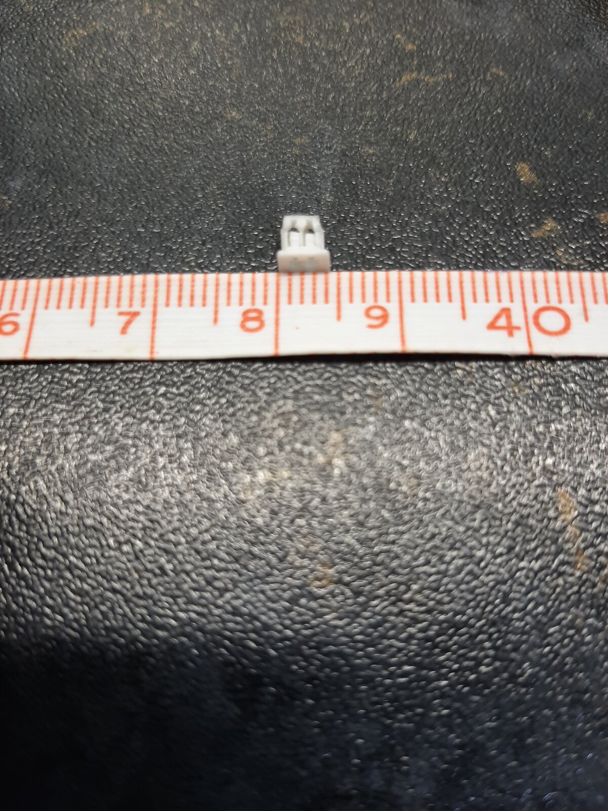

Definitely a Molex or Molex style. I think Swwils has it right, but do measure and inspect it very carefully as there are dozens of subtly different types that look similar at a glance.

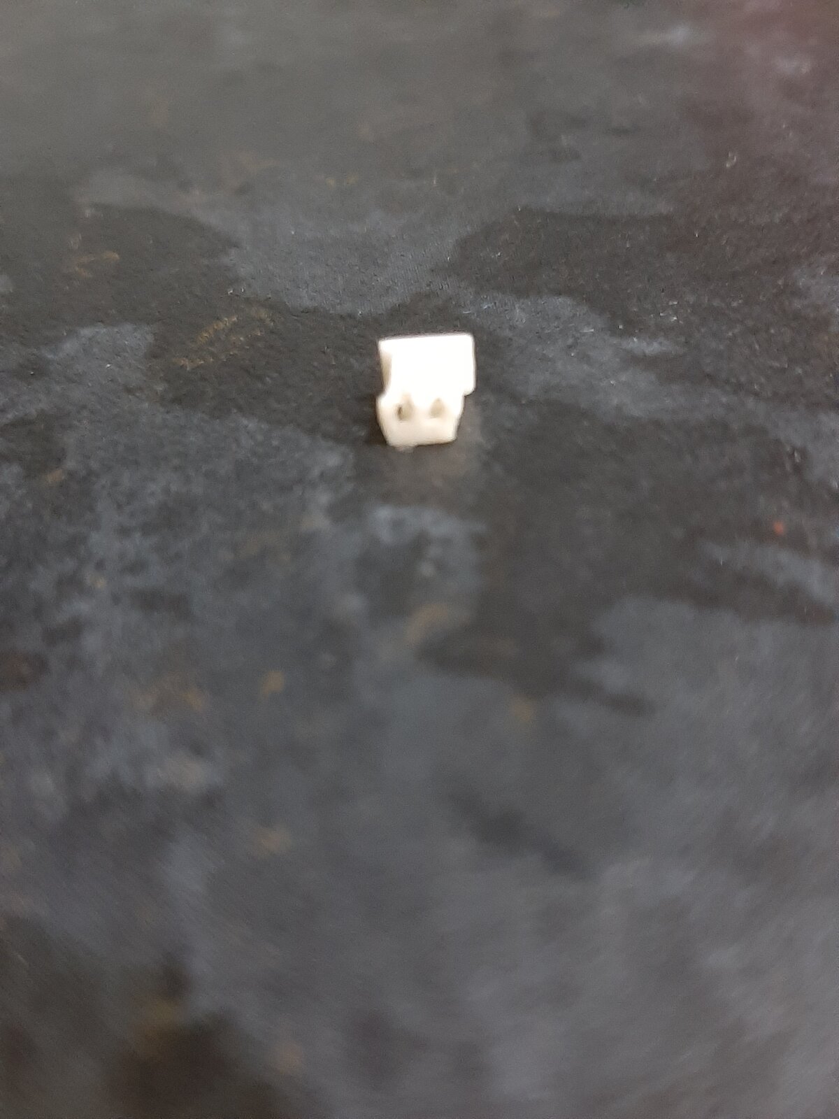

There should be numbers on it, you may need a magnifying glass to read them.
Failing that, can you give a better quality picture from side on without flash and glare? Perhaps put it on a non shiny surface first, not a white one.
Thanks guys, my photographic skills have always been appalling!!
I'll see if I can find any numbers on it if there are so many types out there.
Well after many futile attempts there's no way I can see the unnecessary numbers on the connector. Is there anywhere I could buy a small pack of mixed sizes that would likely have the one I need?
JST ZH or Molex Picoblade. Difficult to tell with the blurry pics.
Sorry guys, my phone camera isn't great coupled with me being no David Bailey!!

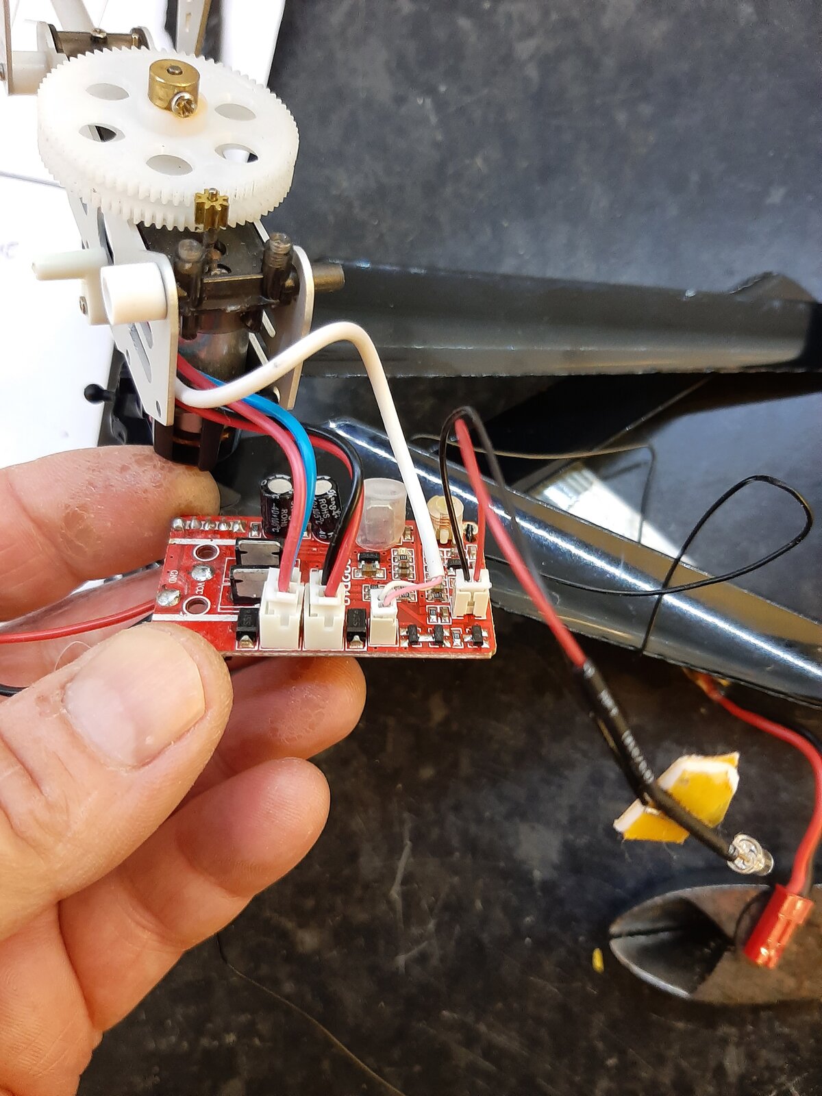

This is the connector in-situ, maybe more clearer.
