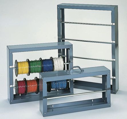

OOI - does anybody know if you can get reasonably priced cable stands/dispensers for reels of T/E? i.e. like this, only designed to take 1 or two heavier, larger reels....
It'd need a pretty big and/or heavy baseplate to avoid tipping over when you're tugging on a the cable....
I have many toolboxes.
No two are both close enough in size and small enough to lug around for that to work.
The key thing is for the reel to turn - I guess there's no reason why the axis should be horizontal - vertical would work just as well, so a bit of broomhandle fixed to a base:
might do the trick.
