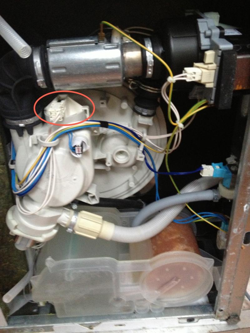

Just wanted to add my thanks to you all, especially Sleepyhead. I didn't get my dishwasher from Ikea; mine is a Bauknecht GSFS 6420, but I guess they all share the same basic parts.
I had the same 11-flashes situation, which gradually intensified meaning the cycles would get shorter before the flashes started until finally the cycle would just immediately stop.
I was surprised not to see any photographs of the internals, so I made one myself.
Again, this is a Bauknecht, so YMMV.
I fixed the issue by following the instructions from this thread on removing the water pressure sensor and cleaning the black grid under strong water. I could not remove the grid from the 'lid', but the water and tapping the grid removed all the junk. If you hold the piece with the grid-side up under running water and remove it you can feel the black sensor plate jumping back up.
