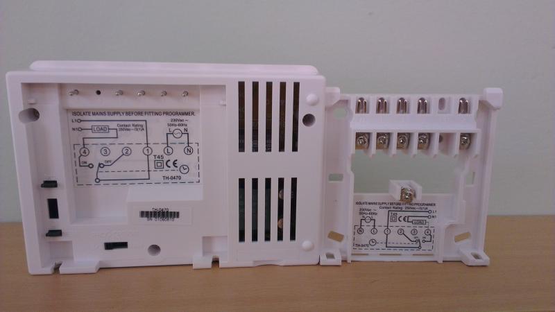

I'd like to connect a new digital timer/thermostat to my Ikon-t boiler but need help with the wiring.
The timer I was recommended has a backplate with

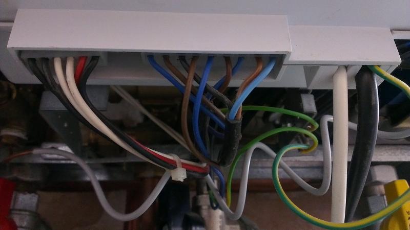

Below is a pic of the boiler wiring.
[/img]
So basically, what wiring should go to where in the timer and do I need to disconnect or bridge any connections in the boiler ?
Many thanks.
Do you have a thermostat at present ?
If so, can we have a picture of its wiring?
If not, What is make and model of boiler and thermostat?
The boiler is a Hermann ikon 23t. It currently has no independant thermostat only a white cable (next to the black mains cable in pic) marked as thermostat with a sensor on.
Give us a clue.
Boilers come both with all stuff built in and as a plain heating unit with all the controls outside of the boiler. Looked on line for your model but nothing to show what type it is.
I would guess the second type and as far as the boiler goes again two types.
One which is just switched off and on, and
One where a cool down time is required and so has both live supply and a control wire.
With the latter the control can need to be controlled by a volt free device (likely 24v control circuit) or where it used 230v for control so volt free contacts are not a requirement.

The boiler does heat the domestic hot water, not to a tank but as required when a hot tap is turned on. There are no controls outside of the boiler. On the boiler I have a domestic water temperature control a central heating temp control and a old type pin selector clock timer. The domestic water temp control works fine but as for the central heating controls ( temp/thermostat and timer they ar not at all accurate and ar inconsistent).
The new timer/thermostat is to serve the central heating only.
I've searched the net high and low to find the boiler manual but am unable to find one.
So, you mean, this could be a thermostat? :rolleyes: Show us a picture of it! You are not helping yourself here. We can only give information based on what you tell us! Nobody can find info on your boiler, and the stat instructions are only good if we know whats at the other end!
And what you have is called a COMBI BOILER, due to it being a combination of heating and hot water.
Can you identify the two terminals marked TA? (top right of diagram)
If so, is there a connecting link between them?
