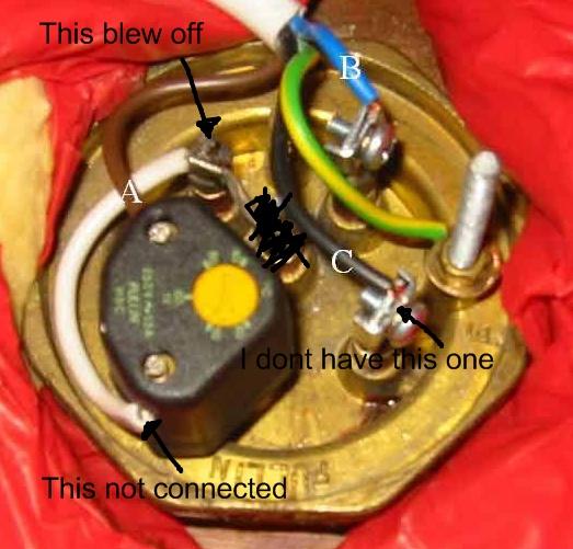

Hi everyone, I just moved into my new house and noticed that the immersion heater does not work, I have had a look thru these forums at the other posts about immersion heaters and they are different to mine, I found this picture and altered it a little to try explain:-
Only thing is I have only 3 core wire going to the box on top of the tank, also as explained in the picture the white wire was not connected and when i connected it to the other side of the thermostat and flicked the switch which is just a single switch with a light on, I got a massive spark and the bit labelled popped off???
Any ideas guys?
Any help will be greatly appreciated.
The bit blew off because by connecting up to the thermostat you have caused a direct short circuit to earth. No disrespect intended , but you do not appear to be competant to rectify this problem & I would suggest you call out an electrician to establish why the thermostat was disconnected & rectify the fault.

P.S that is not an actual photo of my element + thermostat I found it on the plumbing forum, just thought it might help someone to help me if they could see what i was on about.
sounds like the element was faulty before.
That fault may have been why someone disconnected it before.
It is possible you reconnected a faulty element and the fault current when you switched on blew the cable of the element terminal.
Sounds like you need the water drained down and a new element fitted.

Just get an electrician or plumber to change it for you... if it looks like that on in the pictre then it isn't to regs as it doesn't have a secondary safety stat.

Get a multimeter, turn off the power to anything feeding the element, test the element resistance, and post the value here.
It would be better to post a photo of your own element.
