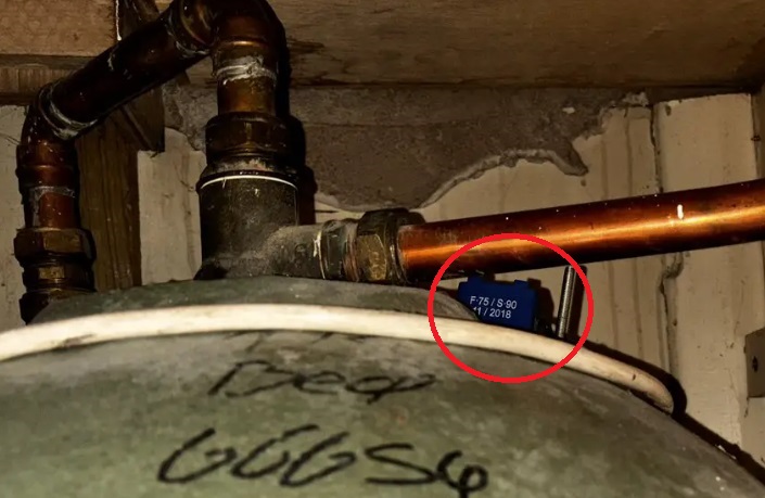

There are a few things I notice from your photo and the first is particularly worrying.
1. The lid appears to be missing from the immersion heater which means live wires are exposed. :eek:
2. As @Bod ... there doesn't seem to be a vent. That's nothing to do with the electricity consumption, more of a plumbing issue to do with venting air bubbles from the water before it gets to the taps.
3.
Cylinder insulation looks OK but no insulation on the hot pipes :rolleyes:
Oh god! That doesn’t sounds right…. I’m guessing I need someone in to have a look asap then? Is it a plumber or an electrician?!

I would consider (if possible) investing in a good plumber & a new unvented hot water cylinder.
This will heat up your water and keep it hot more economically. It will eradicate the poorly fitted noisy pump. Give you great showers and water pressure.
A good plumber will size the cylinder to the cupboard to incorporate that all the pipework and valves are maintainable and well insulated (saving more energy)
Then you may be advised to get a good electrician who can wire a programmer that'll heat up your water in non peak times (Dead of night) and while he is there advise you on the electrics and hesting on the rest of the flat.
You have made a big investment with this flat. Do your research in finding a good plumber who is registered to fit unvented cylinders and a good registered electrician.
