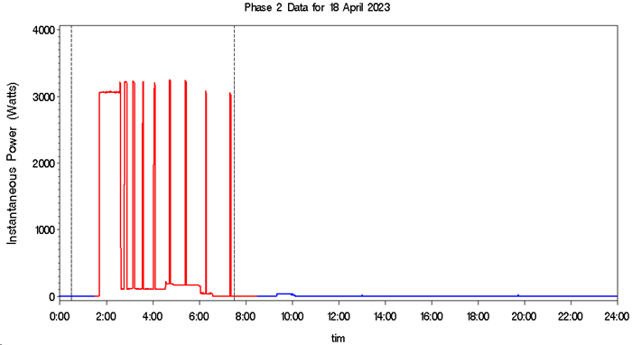

May seem odd, but often better if not switched off, reason is time the immersion is switched on for, clearly we use kettles every day with 13 amp plugs and 3 kW elements, but with the immersion it can take a few hours to heat the water, and a fuse is designed to melt, so must get hot, that's how they work, so must be a way for that heat to dissipate, so black plugs are better, and the larger the plug the better, but once the water is hot, the time the immersion works to re-heat water is shorter, so plug heat wise leaving on is likely better.
If plugged in where there is free air not so much of a problem, the problem is were inside an airing cupboard.
May seem odd, but often better if not switched off, reason is time the immersion is switched on for ..... once the water is hot, the time the immersion works to re-heat water is shorter, so plug heat wise leaving on is likely better.
Indeed. People tend to forget that when we're having these discussions about the potential problem of having an immersion fed via a plug socket, when many people seem to think of it as a 'continuous' 3kW (about 13A) load.
The reality is, as you say, that, particularly if one never switches the immersion supply off, the immersion will never be powered for a very long continuous period. Even in my case, with the (admittedly very well lagged) immersion only powered ('continuously') for 7 hours per day (the E7 off-peak/cheap period), it is not usually 'on' for much more than an hour, and only on for a total of a couple or so of those 7 hours (so, roughly less than one-third of the time). Even if the cylinder starts off totally cold (very rare), it only takes about 2.4 hours. Here is a particular day, picked at random:
