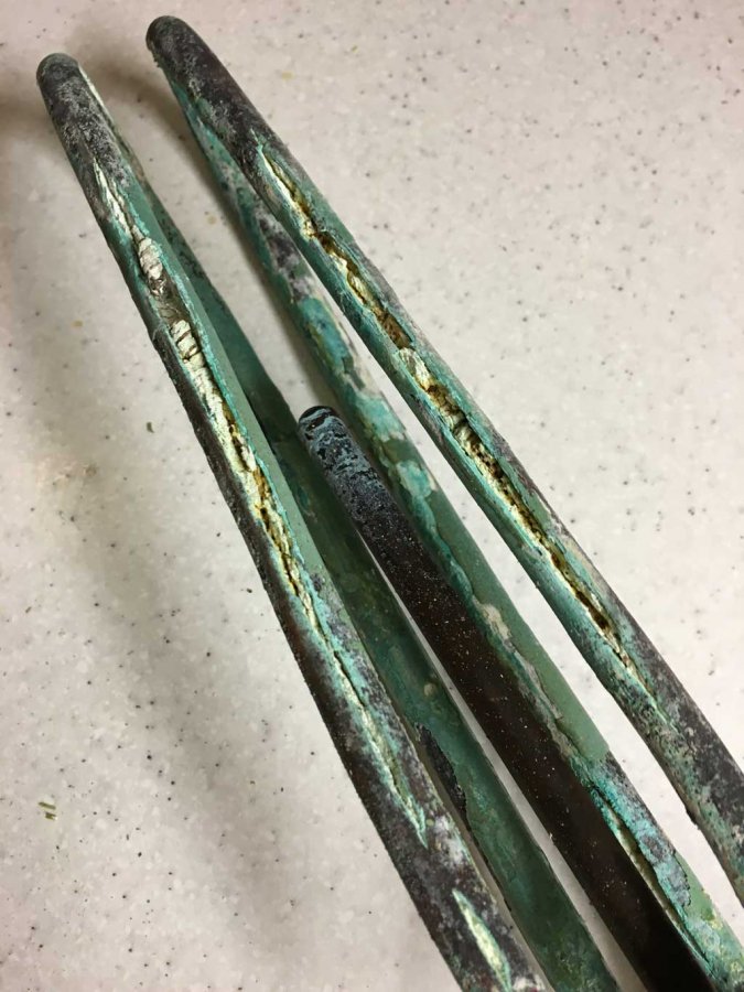

My immersion heater stopped working recently. I measured 240V across the ends of the element so I knew the time switch and thermostat were OK. The immersion heater (a 14" Gold Dot) had been in the combi cylinder for at least 11 years. I got a plumber to remove it and found it had split along its length, so I got a new one fitted.
I have a Wylex 604/N consumer unit and the fuses have been replaced by plug-in Wylex MCB's during its life. The immersion heater is on its own 16A MCB within the consumer unit.
I am a bit surprised that the immersion heater could fail in such a way and yet not trip anything. Is this because I don't have RCD protection and is it an indication that I should get an electrician in to inspect / upgrade the electrics?
In real terms assuming every thing earthed as it should be the immersion heater caused no danger, it would be simple to swap the fused connection unit (FCU) for a RCD FCU and then it would trip with that fault.

Also even with a 30 mA RCD this does not limit the current to 30 mA it only limits the time to 40 mS it does very little to help with direct contact. Any item going faulty like you immersion heater it will disconnect before any one has a chance to get a shock be it washing machine or dish washer it will trip first, however so would the 100 mA version in most cases.
