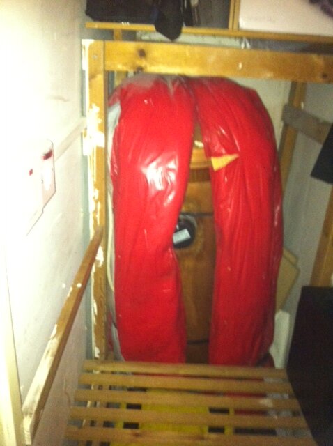

Before you had both elements changed, which was the first element to go wrong, in the beginning?

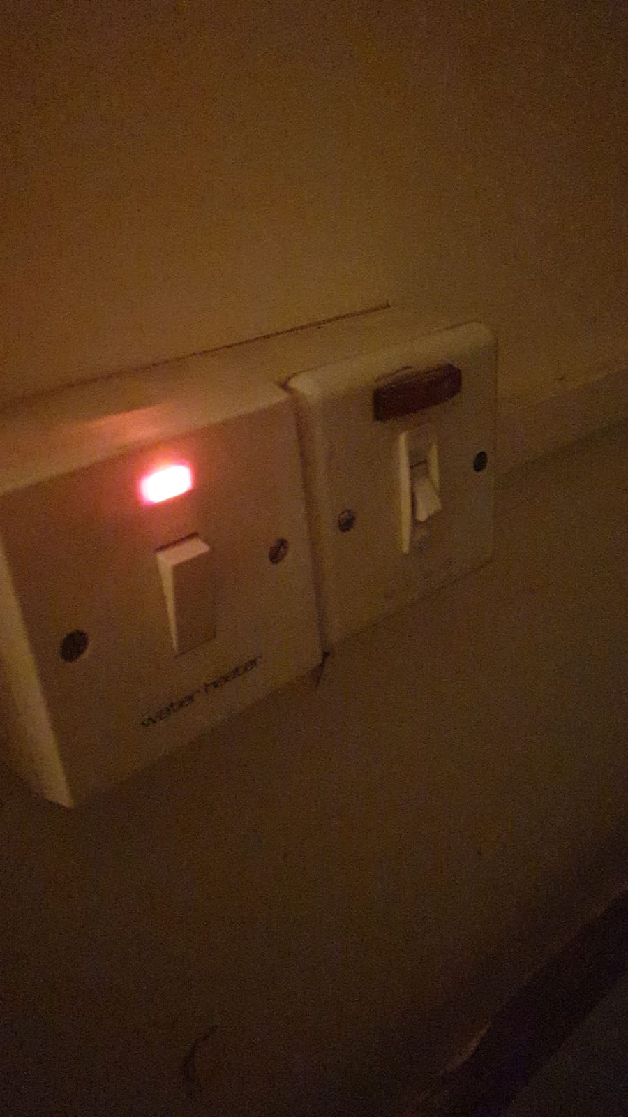

yes, you could only test the night time one at night as there is no power to it. the day time one (24 hour) trips at any time it is switched on as the power to it is constant.
power supply to the flat between 11.30pm and 6.30am is on the lower rate cost as far as i understand. before dynorod changed the immersion heaters, the night time one had already packed up and only the day time one (the constant one) was working.
A flat.
Are the two immersion switches by the cylinder right next to each other?
Is the wiring single core wires in concealed round conduit?
A flat.
yes the two switches are next to each other on the wall.
the feed to the two switches on the wall are run inside a pvc trunking

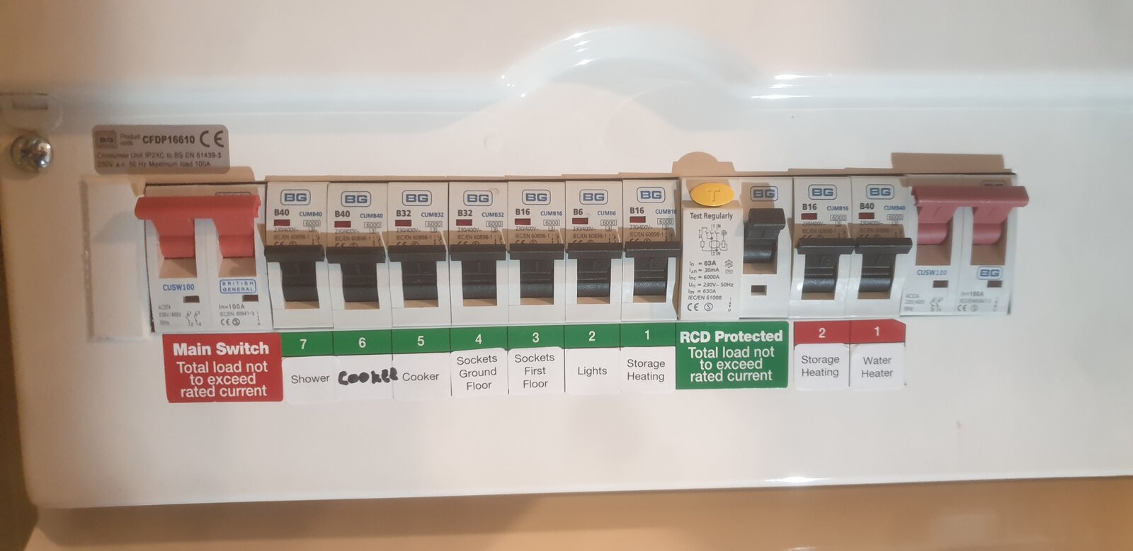

Which breaker or breakers trip ?
Is it only the 40 amp mcb ,marked 1 on red background ,and water heater? And only that one that trips?
I was just wondering if the neutral feeds were mixed up at the wall switches, this would only be a problem if you have RCDs, a picture of the consumer units may help.
Seems such a coincidence that the both heaters appear to be faulty.
EDIT - only just seen consumer unit pic.
If both Im/ heaters are wired to that 40 amp mcb ,It's odd to say the least ,and if it is that tripping there is obviously a dead short.
the 40amp is the night immersion heater and the 16amp, labelled 1 storage heating in green is the day immersion heater. the electrician labelled it wrong. they don't trip, only the main RCD trips.
The main RCD should only do all the day time circuits.
Does that RCD trip when ONLY the night time heater is turned on, at night?
Has anybody worked recently inside the consumer unit ??
only when it was installed earier this year. at that time only the day immersion heater was working so I wonder if having both immersion heaters connected is causing the trip as the night immersion may be working as well even though it is only meant to come on at night.
I think your problem is within the consumer unit . Was it the same electrician that supposedly " tested" the circuits recently ,that installed the consumer unit earlier this year ?
And please confirm that he tested the circuits recently ,without removing the cover of the consumer unit .
