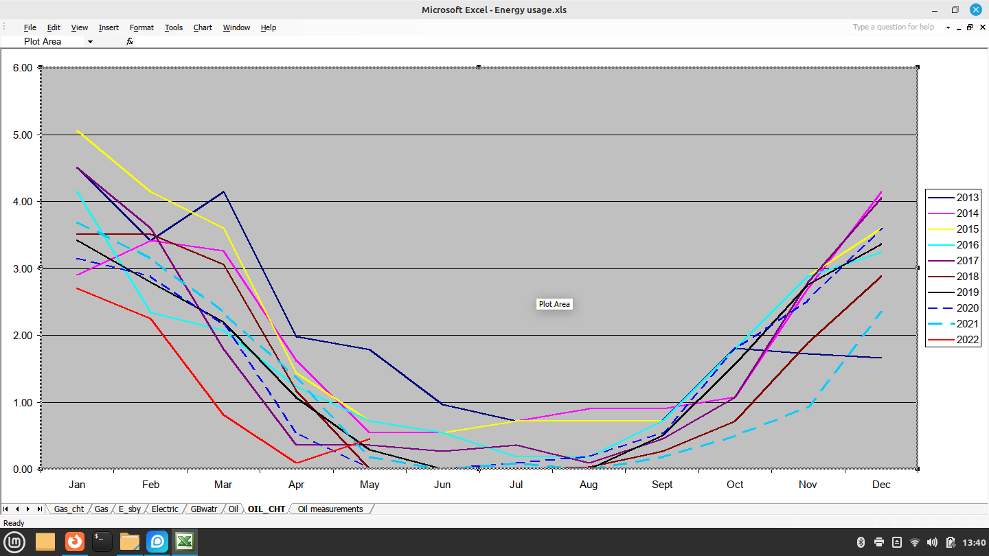

It might be worth you thinking about solar panels depending on how much hot water you use. We had an old oil boiler in our last house, method of measuring oil consumption was tape measure stuck up side of sight glass on side of tank and a spreadsheet. We had a 1Kw PV array that was enough on most days to provide enough hot water (via the immersion) and only had to run the boiler if we got more than a few cloudy days in a row. As can be seen we ran oil free for quite a few months most summers. Vertical axis is Litres/day, PV was initially 500W installed late 2016 then extended to 1Kw mid 2019. We moved out in mid 2022 hence end of figures.

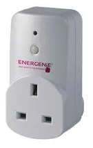

I use a computer linked energy monitor 1678459971409.pngit does not show power factor, but it does form a graph of usage. I also have a non linked, and one which includes a switch, but to use it would need the immersion turning to plug and socket.

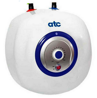

I have considered a under sink unit, a unit like this 1678460401176.pngwould likely remove the need for the immersion or boiler to be on at all in the summer. But it only serves one tap, and my upper floor bathroom does not have a direct water supply, both hot and cold come from the header tank, and I have four locations where I would like hot water in the summer.
It would likely save money as no need to run off cold water, but also takes up room, it still has an immersion heater inside, but only heats 10 litres of water, needs 2 kW, and since directly under the sink it supplies, does not heat up pipes.
But is it worth £100 plus to fit one, and loose the cupboard space?
How long does it take for the sum costs of standing losses of a tank of hot water, pipes to the tap, plus a need to run off X litres of cold down the plug hole before the hot arrives to breach £100? And what's the convenience of instant hot water worth versus the inconvenience of losing under-sink cupboard space?
