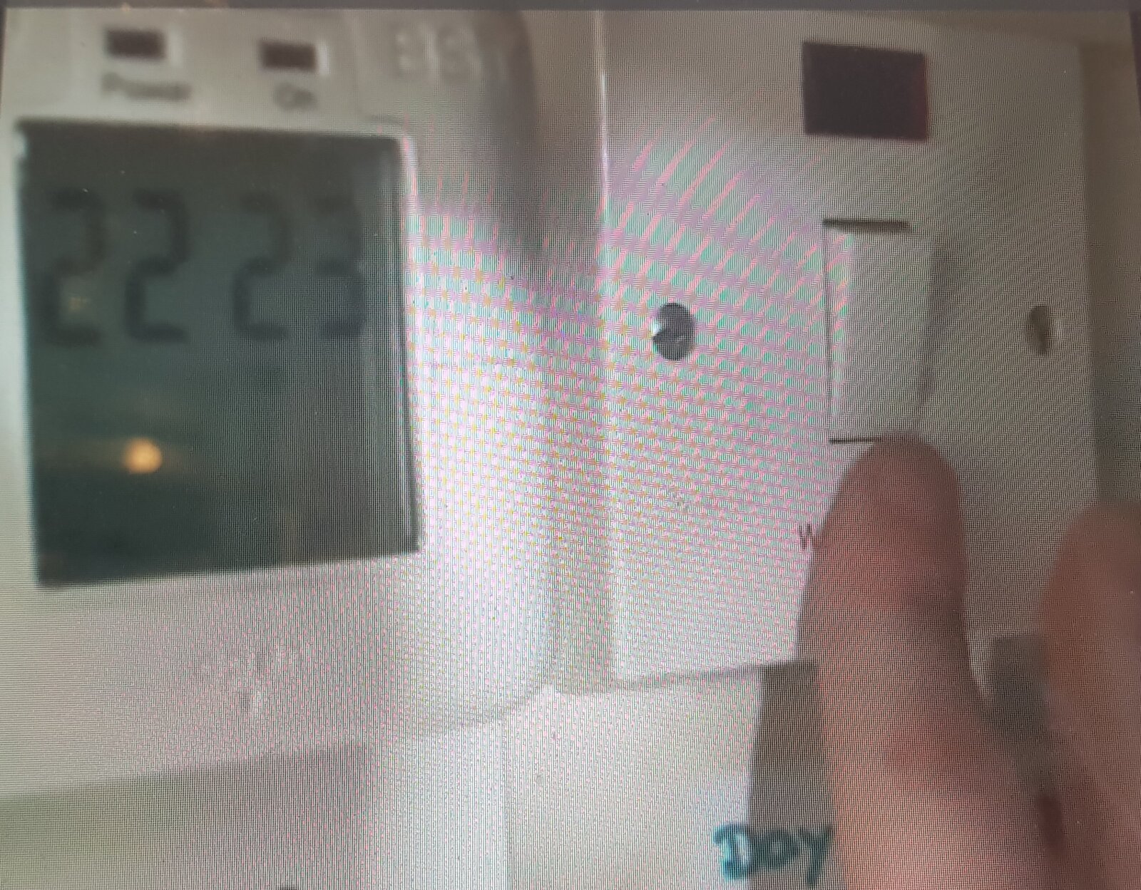

Immersion timer No power on Switch but clock working
2 Feb 2009
6
Oxfordshire
Hi all
I really hope some one can help please ?
I have a timer on my day time immersion heater switch.... the clock on the timer is working but the switch on the wall isn't (no red light when switched mis turned on)
I have attached a picture showing the issue.
I have checked the fuse board downstairs and the fuse hasn't tripped out and is showing as on..
Would be grateful for any advice.
Many thanks for any help and your time.
Kind regards
Mike

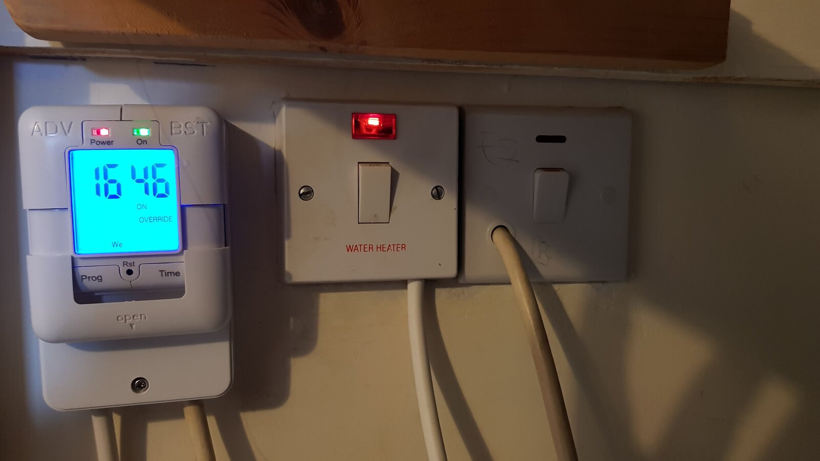

Thank you for the reply...would there be an internal fuse within the switch ?
Picture attached was when it was working :)

Oh no, my mistake - no fuse in that one.
Just used to writing that answer to similar queries.
Could the clock be battery powered? Check for a loose/burnt wire as suggested.
Neons do fail, I have seen many a neon not working, but the switch or socket is still OK. I have an easy test Testing for live.jpg my meter has a non contact test, so all I need to do is hold it close, what makes you think the immersion is not working other than lack of neon? And what have you got to test with?

It's probably just the neon indicator light that has failed. (Unless its a led in modern units?).
Need a wider picture to be sure the day switch white cable goes into timer lhs and the yellowed wire off to the immersion element... but that's the only logical way to wire in a timer imho.
That the timer lights and works would mean the immersion should work, too.
Many thanks for all the informative replies.
I think its more than just the noen light as when the switch is switched to on... the buttons on the timer like boost still don't work when pressed
Thanks again
