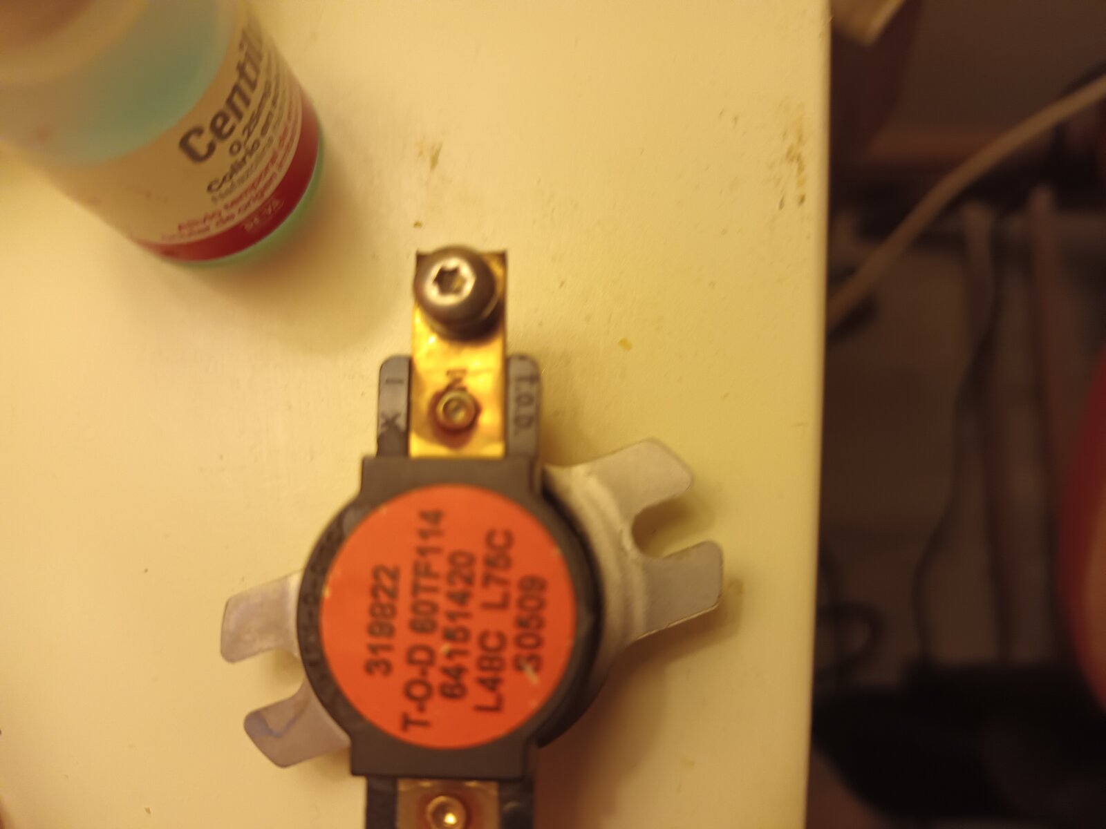

Good description here from JW of how both stats work, in case anyone is in any doubt that there isn't a separate set of contacts. A electric shower thermal cut out (TCO) use two of these discs (its called a duo disc), one, set to 48C, is self resetting, the other, set to 75C, does not reset, the TCO must/should be replaced, you can see one of the discs below, the other is behind it but I don't know if there are two separate sets of contacts.

Not sure if this should be a new thread but - It's still occasionally cutting out for no obvious reason. I left the immersion on all day last week and it was grand; I had it on for 30 minutes yesterday and turned it off at the switch, then when I went to switch it on this morning it had cut out again. This keeps happening which suggests a problem somewhere?

Do you mean the overheat protection had tripped?
yes, the thingy I had to press down to click in post #11 in this thread. Several times now I've switched off the immersion at the wall, but the next day it's tripped
If the immersion is overheating, this is very dangerous. You need to replace either the internal thermostat, or the entire immersion heater.

It's the thing with the blue top in your photo.
Actually, it does not look very old. Why would it have gone wrong? Perhaps it is incorrectly wired. Turn the pointer down to 55C and test the temperature of the tapwater with a thermometer.
The thermostat should click when you adjust it higher or lower than the temperature of the water. Use your multimeter to verify that the supply to the element goes off when the thermostat is set lower than the water temperature.

Live is fed to the immersion through the thermostat, then the incorporated overheat stat then the additional overheat thermostat.
From what you say I think
It is a new thermostat that you have fitted
The additional overheat stat keeps tripping.
Seems that this additional stat is tripping at a lower temperature than it should so I would disconnect this and put the brown wire from the heater element straight into your new stat.
