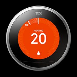

I would agree, however they never are, so does not matter, however we called it a HMI (Human machine interface) and the idea be it controlling temperature of a room or temperature of a hob is to be easy and quick to use. Easy clean comes second. So my old thermostat, ae235.jpg needed glasses and instruction book, new one Hot water boost.jpg simple easy dial and large display, same applies with cooker, it does not matter if magnetic knobs that can be removed for cleaning, knobs to side, knobs under a glass protector, you want to be able to adjust quick and easy, and also if possible easy clean. Having been use to simple knobs, I then tried mothers with touch controls, and to alter temperature you needed to select the heat area then multi touches to adjust heat setting, by which time milk would have boiled over. Also when sitting in a wheel chair the angle of one's eye to the hob resulted in the controls being invisible. The latter clearly dangerous as a short person or child could alter the settings without realising they has done so.
