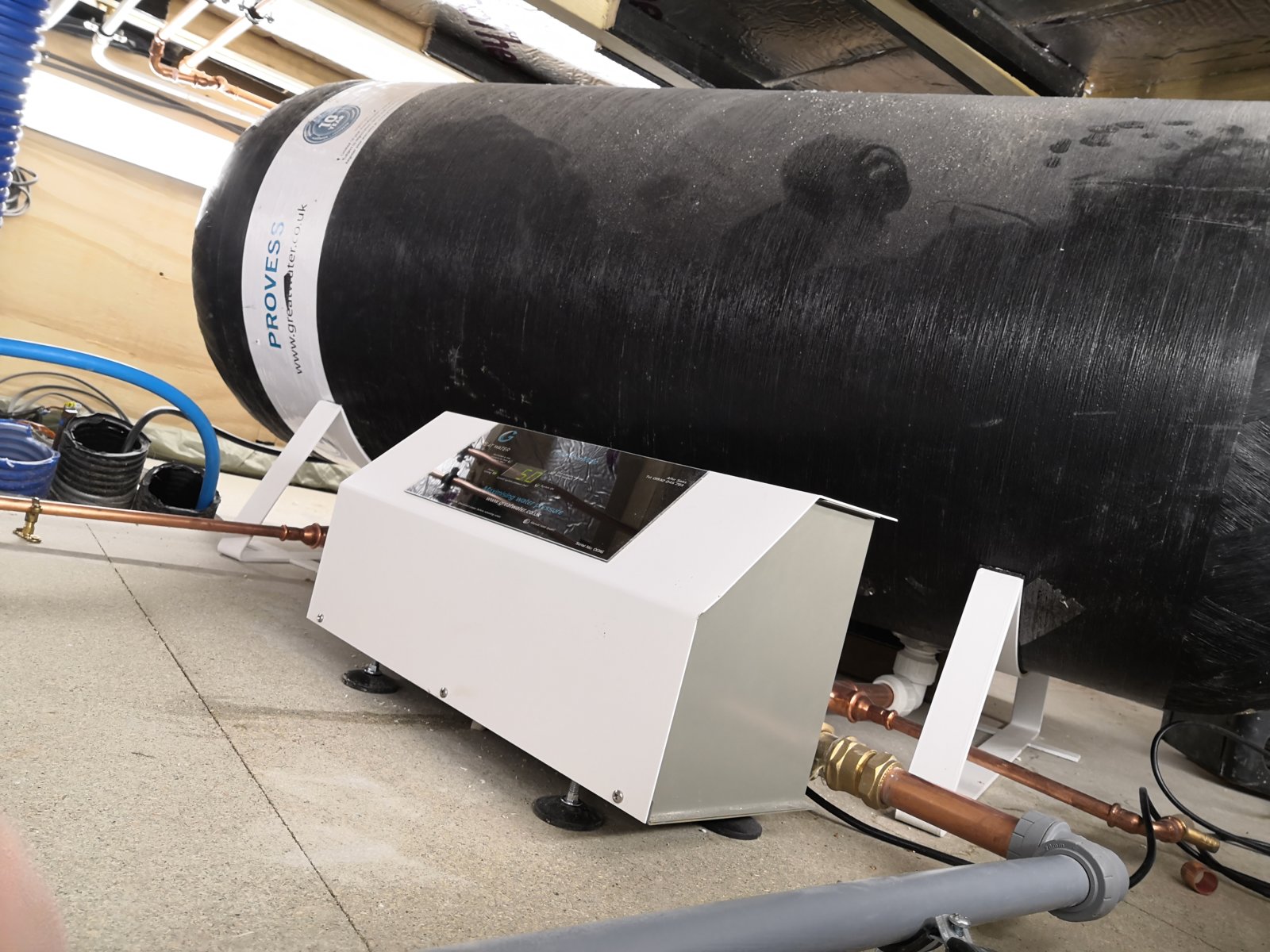

Ah OK, got it. Sounds like a restriction on your incoming main in that case. You should get your network operator to test at the outside stopcock for you, and that will establish whether a new main into the property will help. The alternative is to find space for an accumulator somewhere

Use cold water accumulator - the size of a cylinder - if cold water main flow cannot be improved. Need to test the incoming static pressure. Could be in the loft. Will work well with the combi. Forget gravity tanks, pumps, etc.
