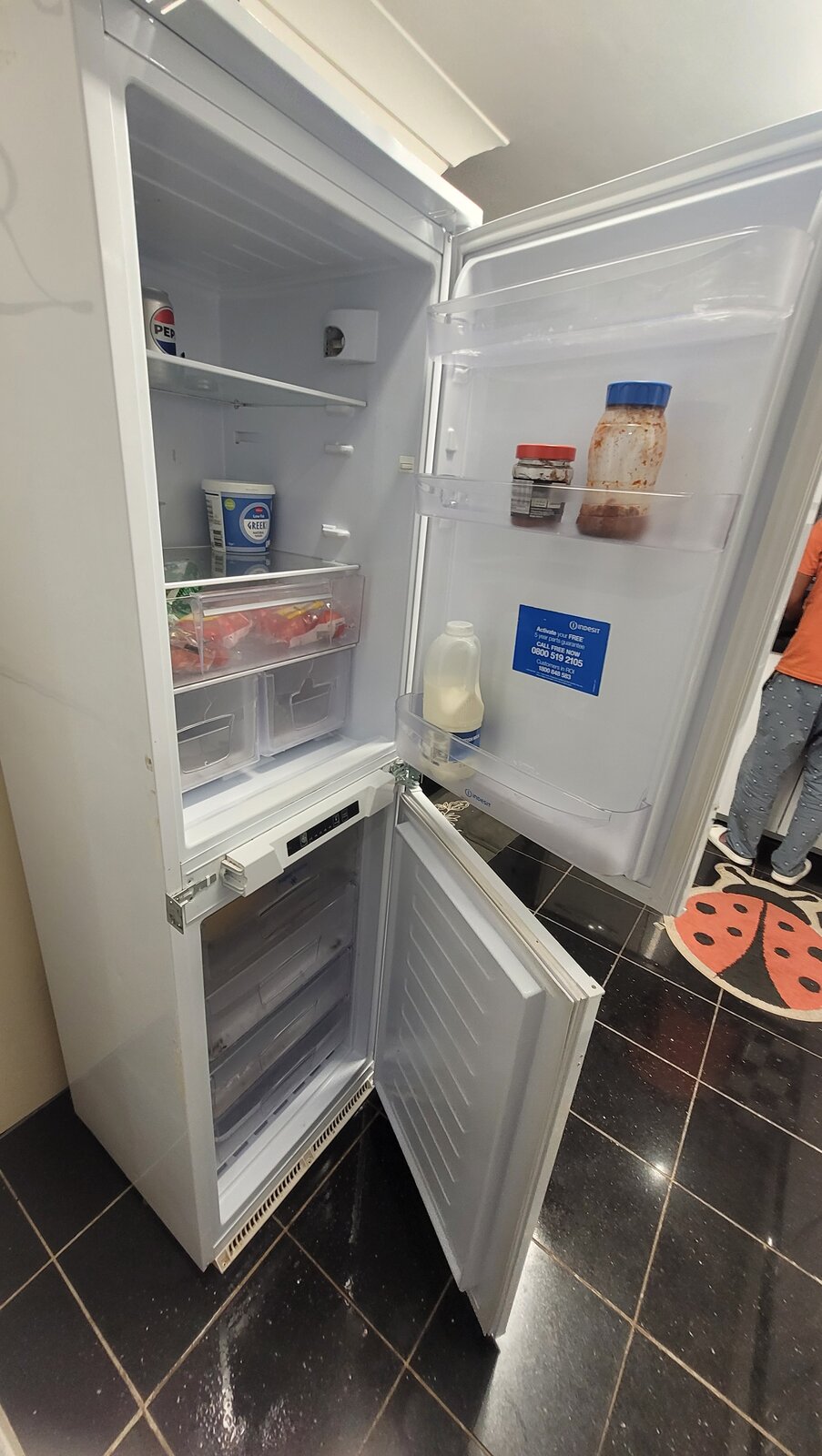

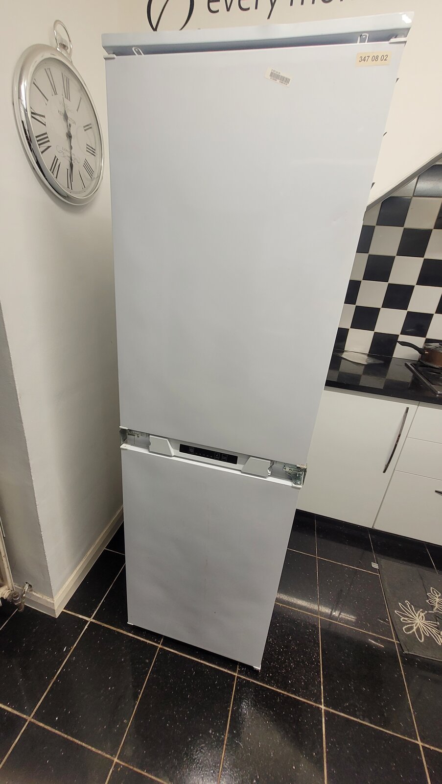

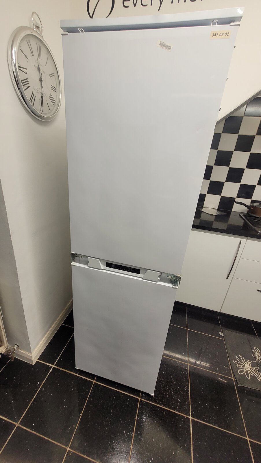

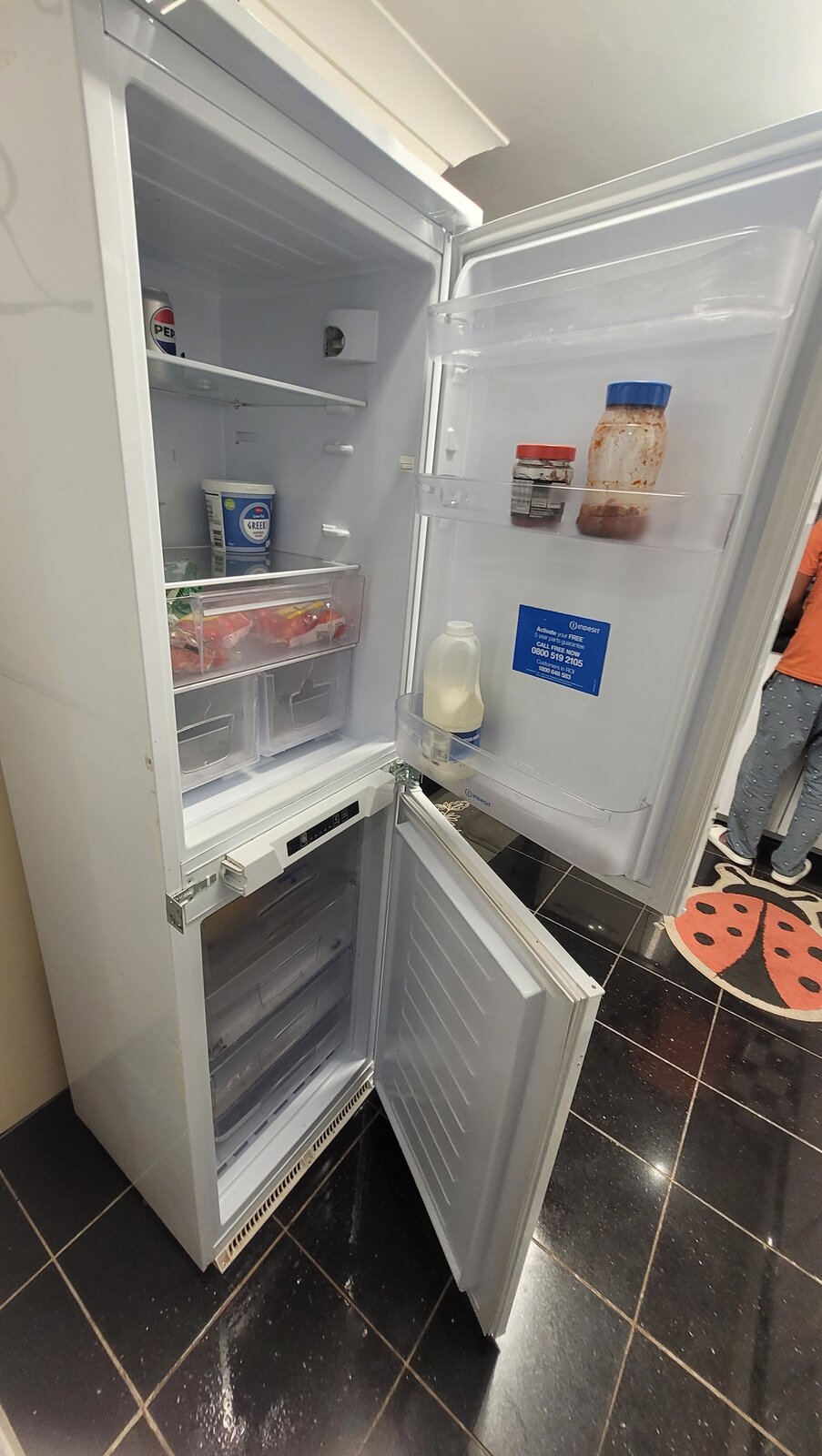

Hi, my 7 year old Indesit IC35FAA integrated fridge freezer just stopped working. Checked the power supply and fuse, deemed OK.
Anything else I can check or any recommendations for the repair job please?
I am in Basildon, Essex.
Thanks.

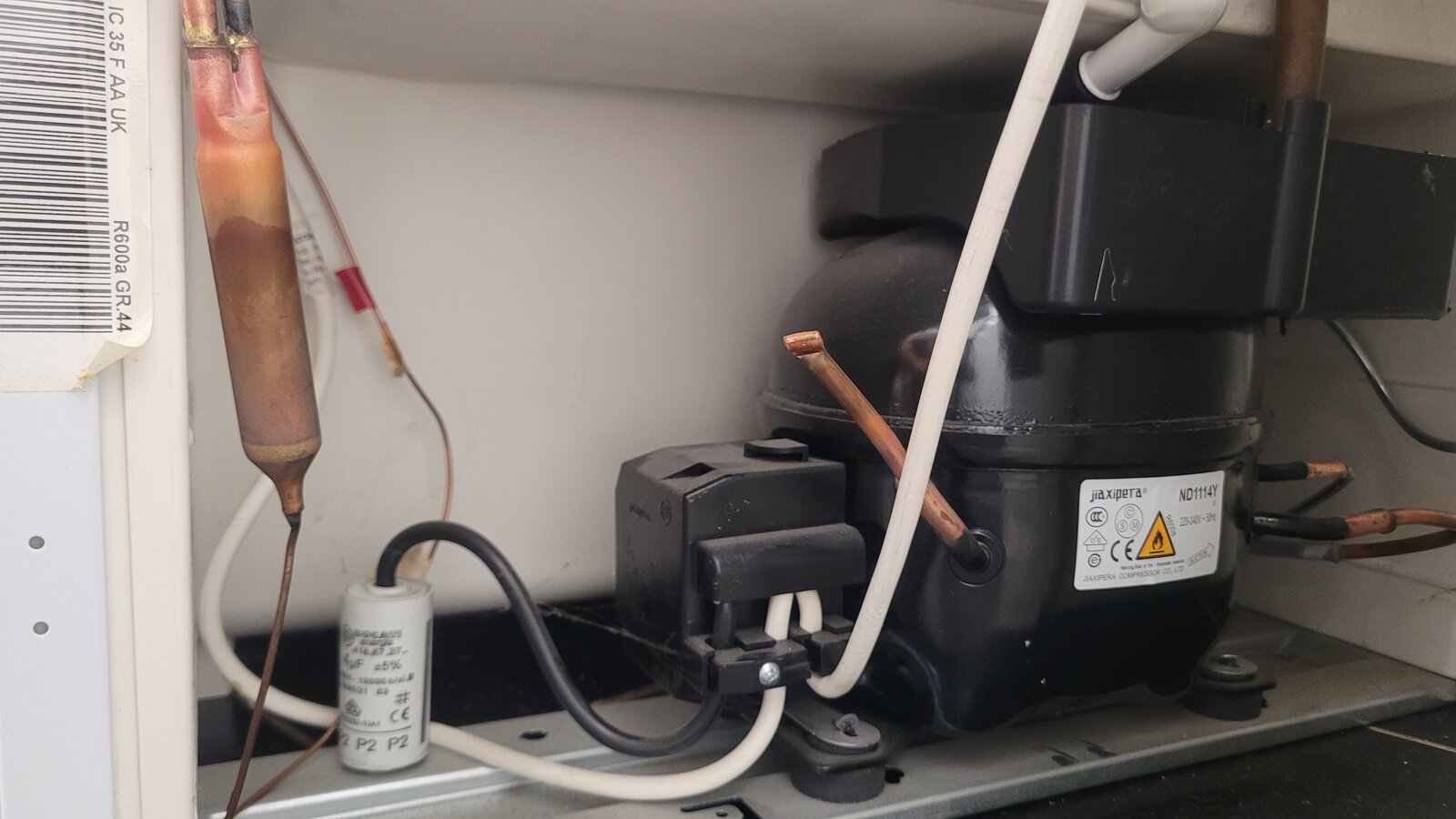

jokes apart, I am trying to fix mine, almost exactly the same model. (mine's hotpoint)
hopefully one of the following 3 is gone:
relay
capacitor
thermostat
all 3 are easy to fix, I am terrible at DIY and I was able to fix mine.
happy to answer any questions you might have. (a few days ago I knew nothing about this failure but I have spent a lot of time fixing mine in the last week so happy to help)

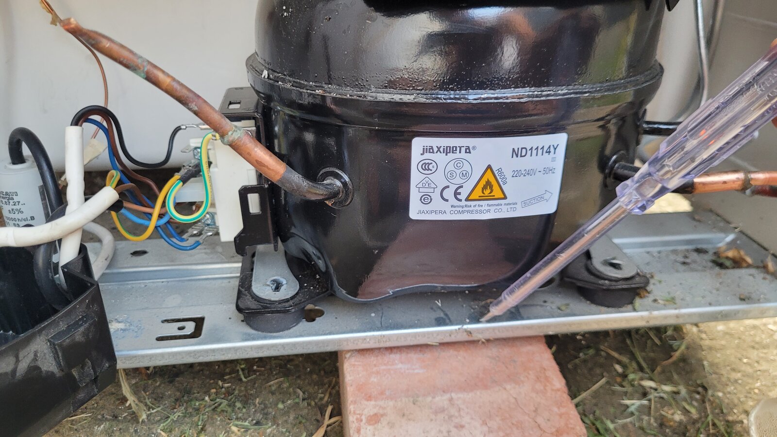

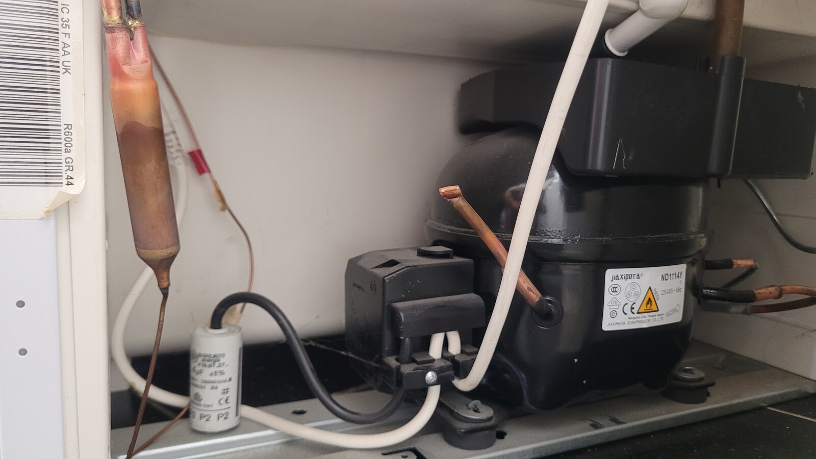

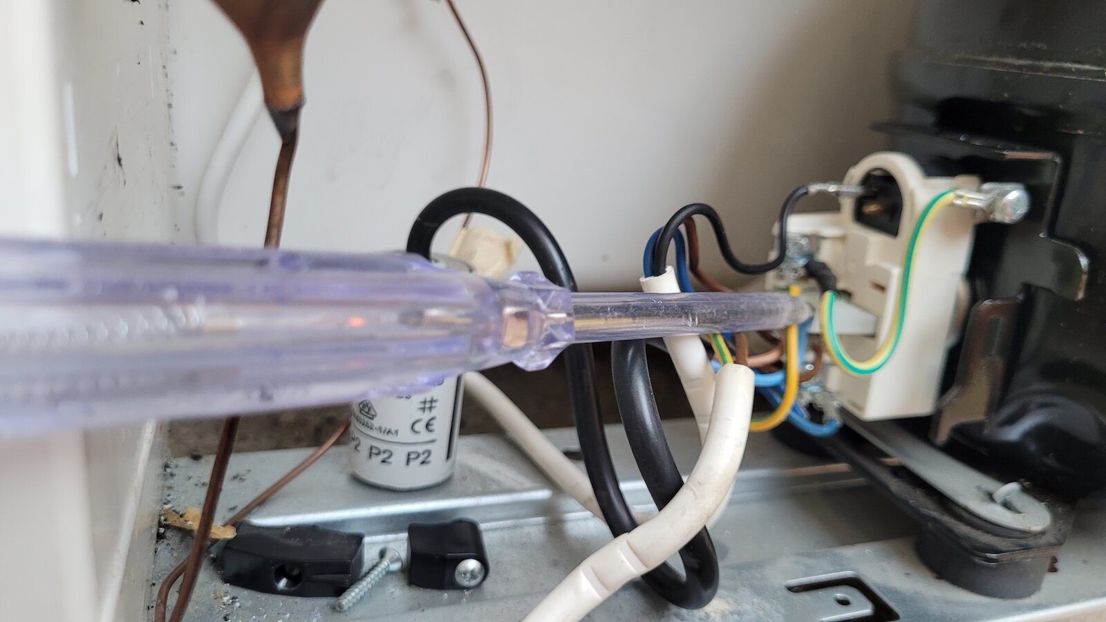

You would first check if power is reaching to the relay. If it is then proceed to checking the relay itself.
So I've checked the power source and fuse, they are both fine.
Do I start with relay next as others have pointed? Can you please share the location of the relay? Is it inside the black plastic enclosure with 2 white and 1 black cable?
The small white cylinder with black cable on top is capacitor?

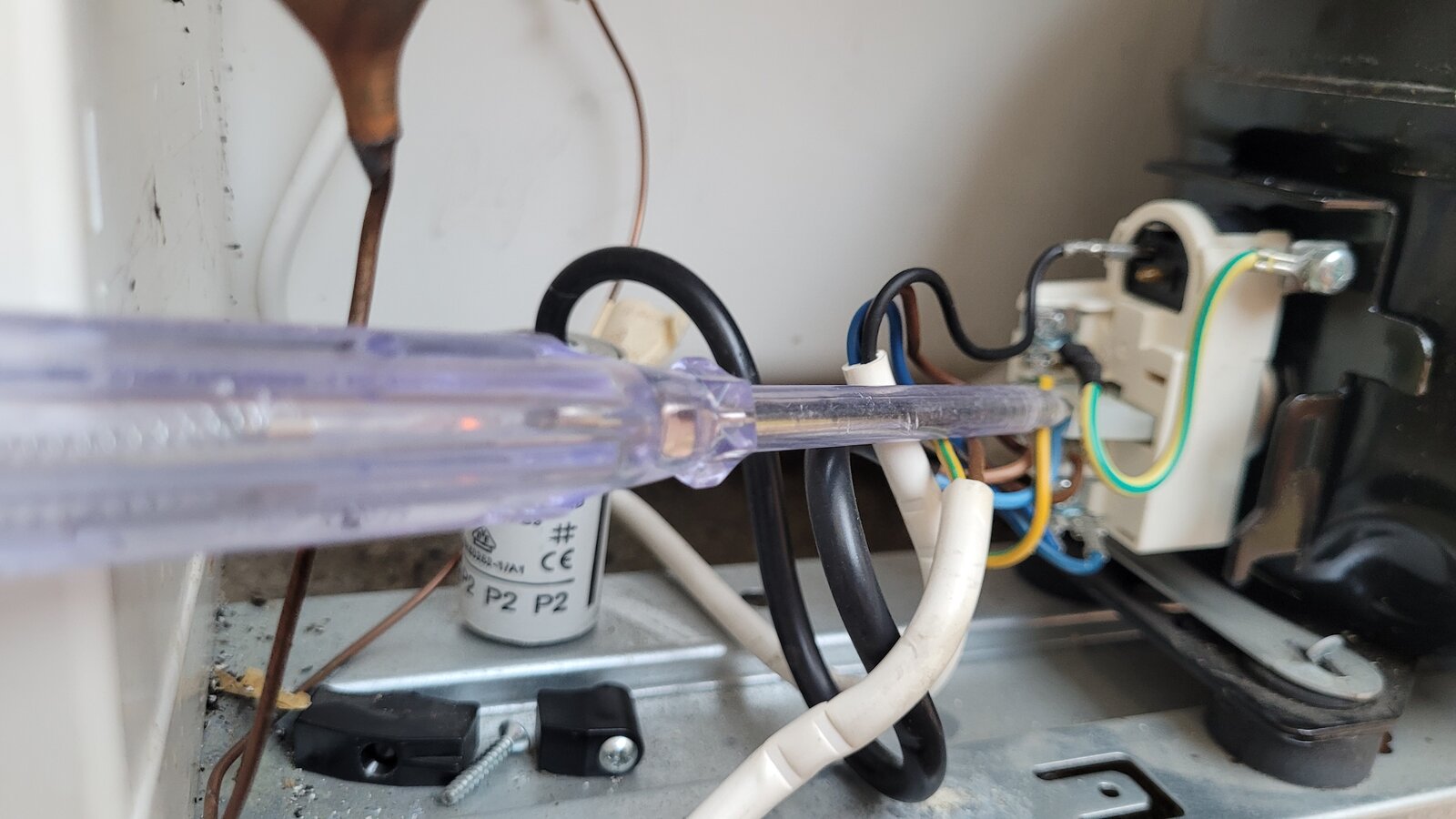

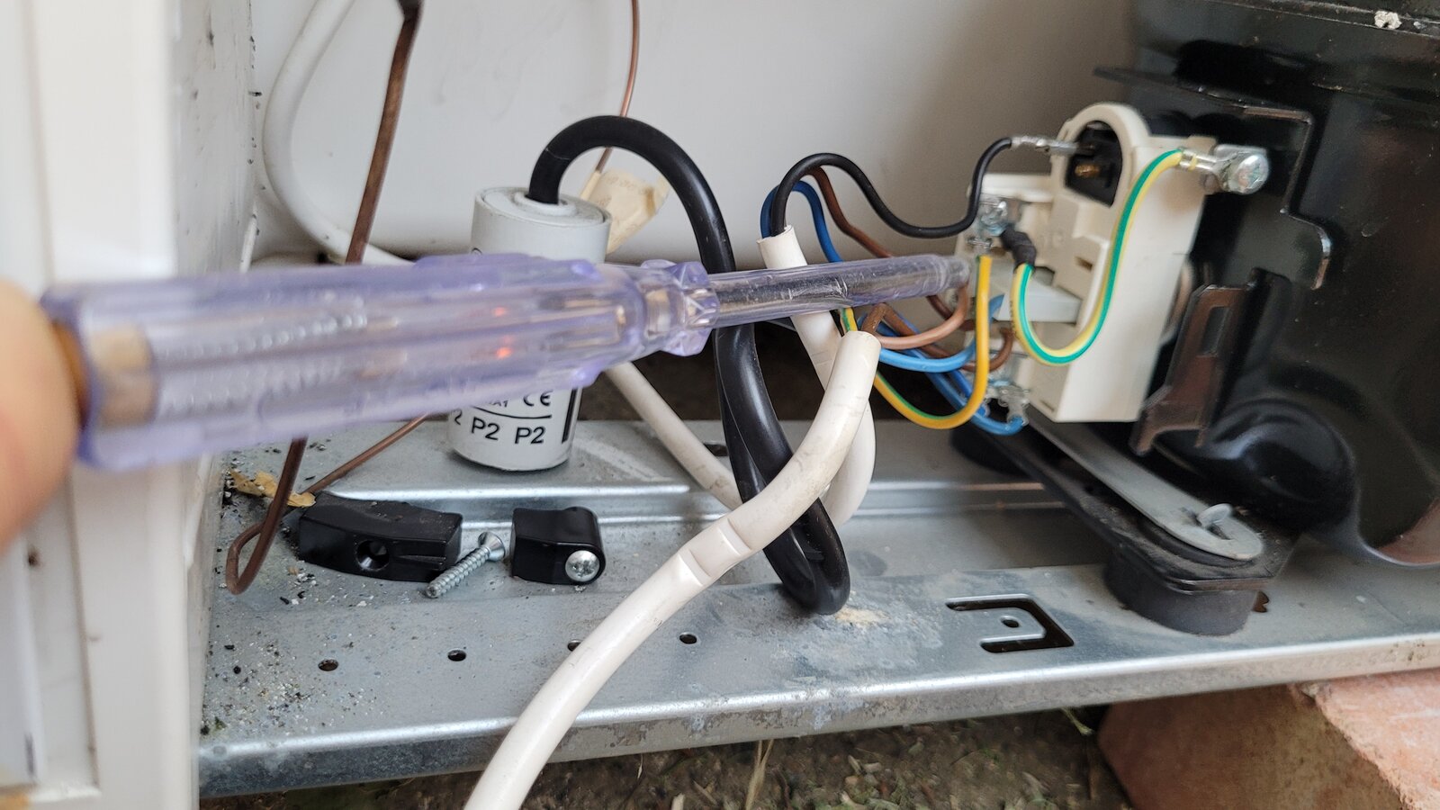

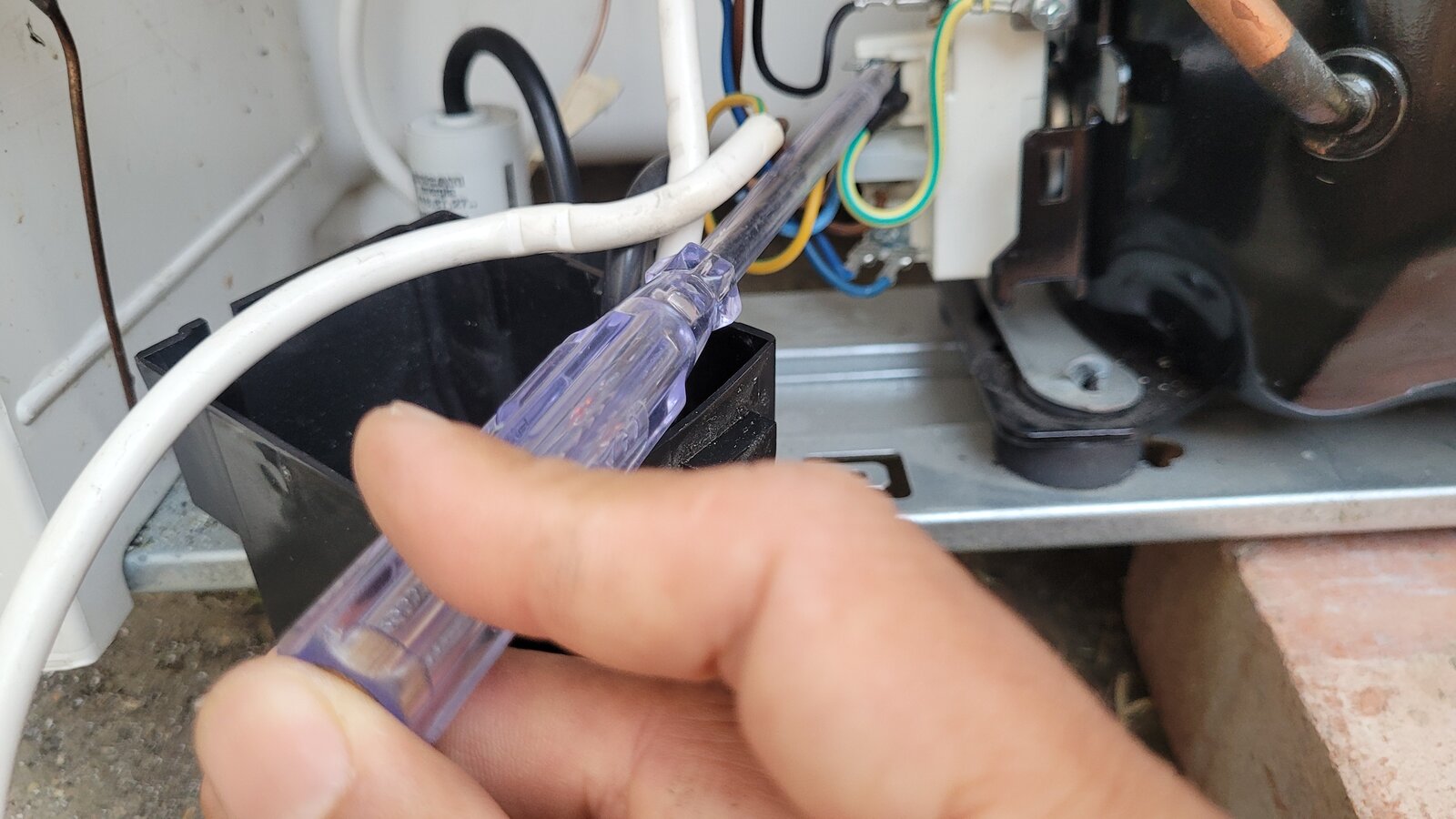

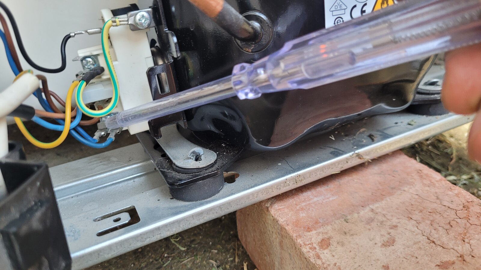

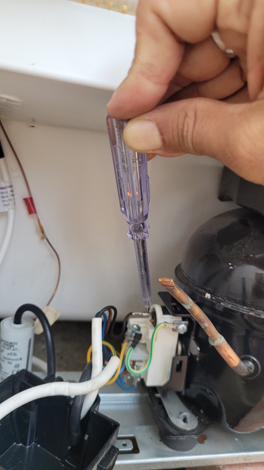

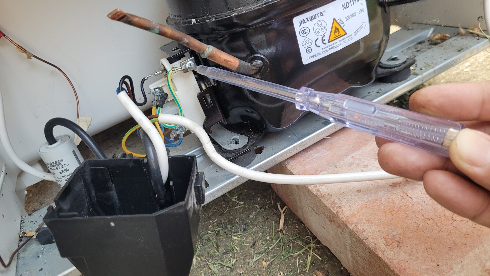

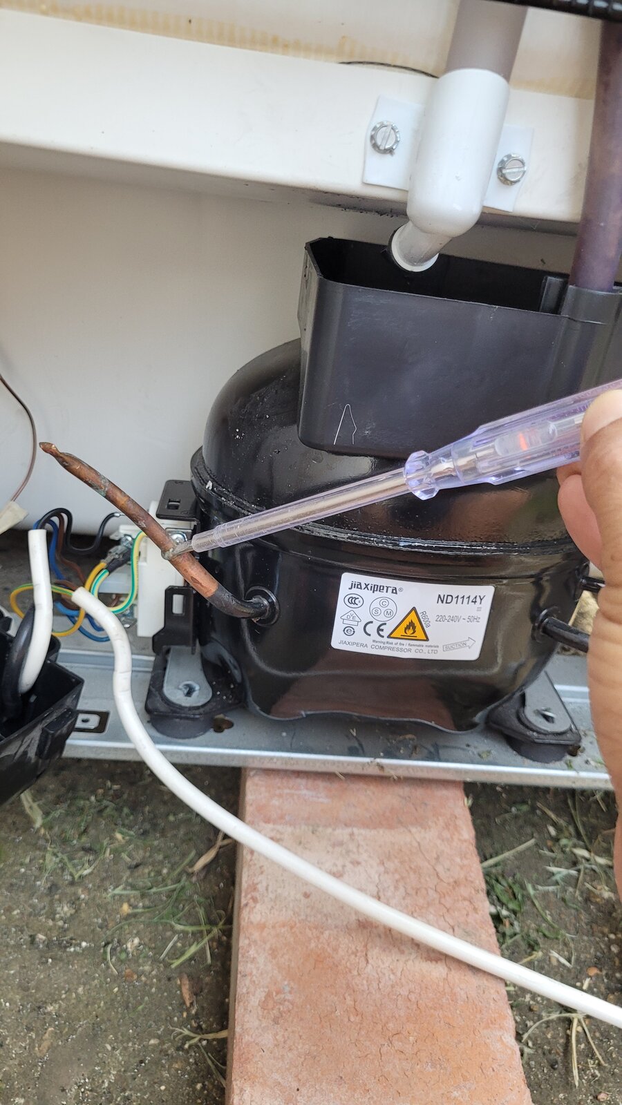

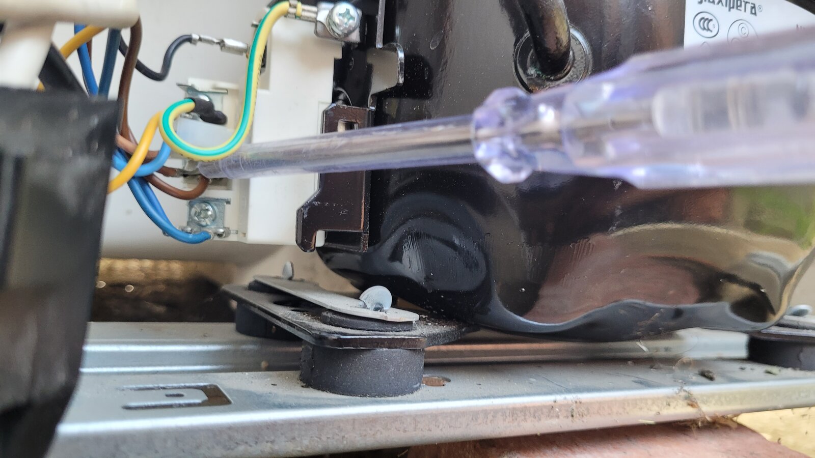

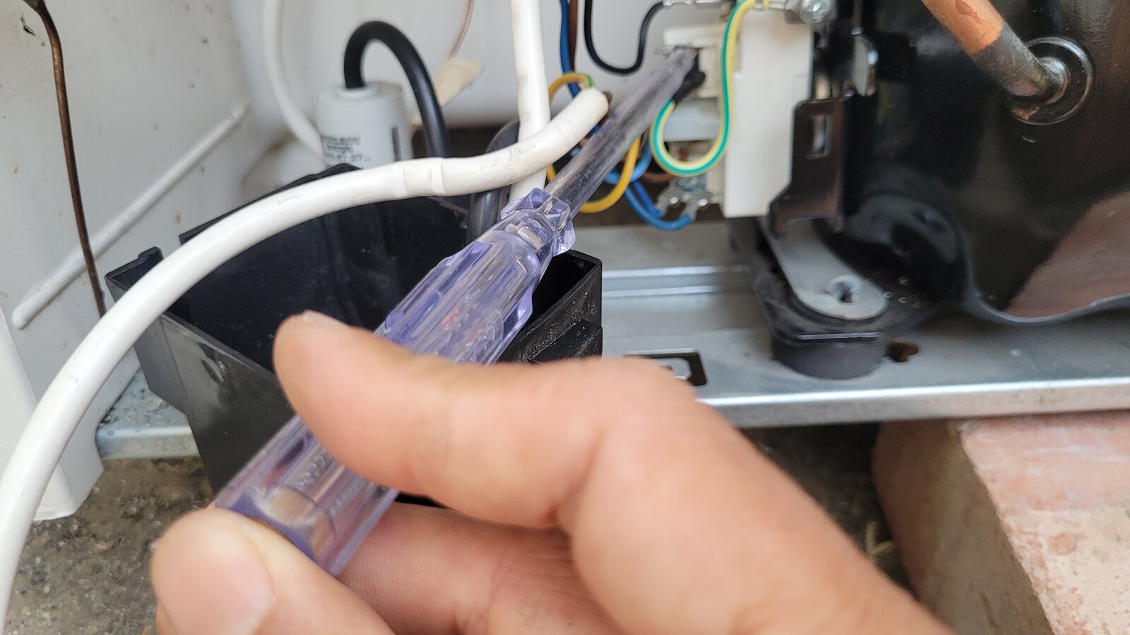

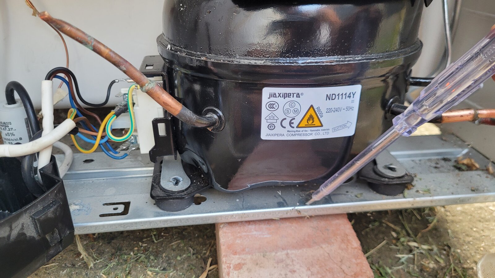

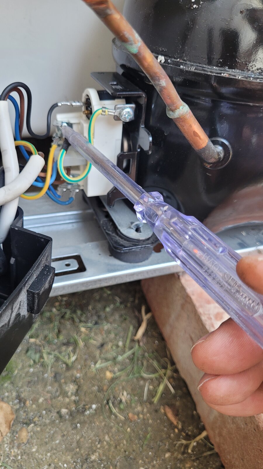

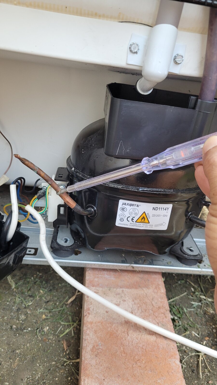

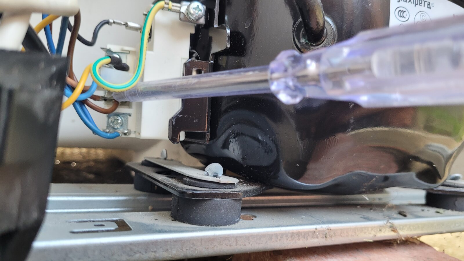

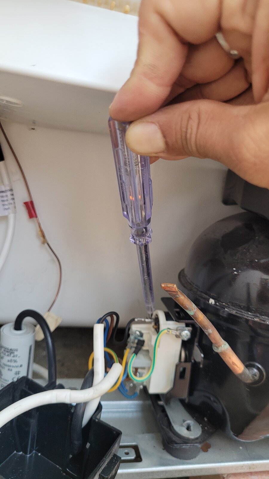

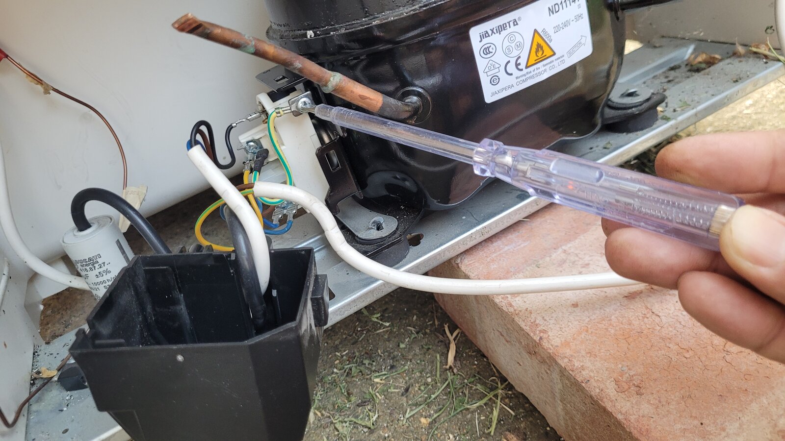

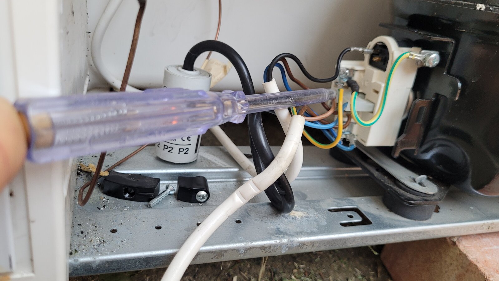

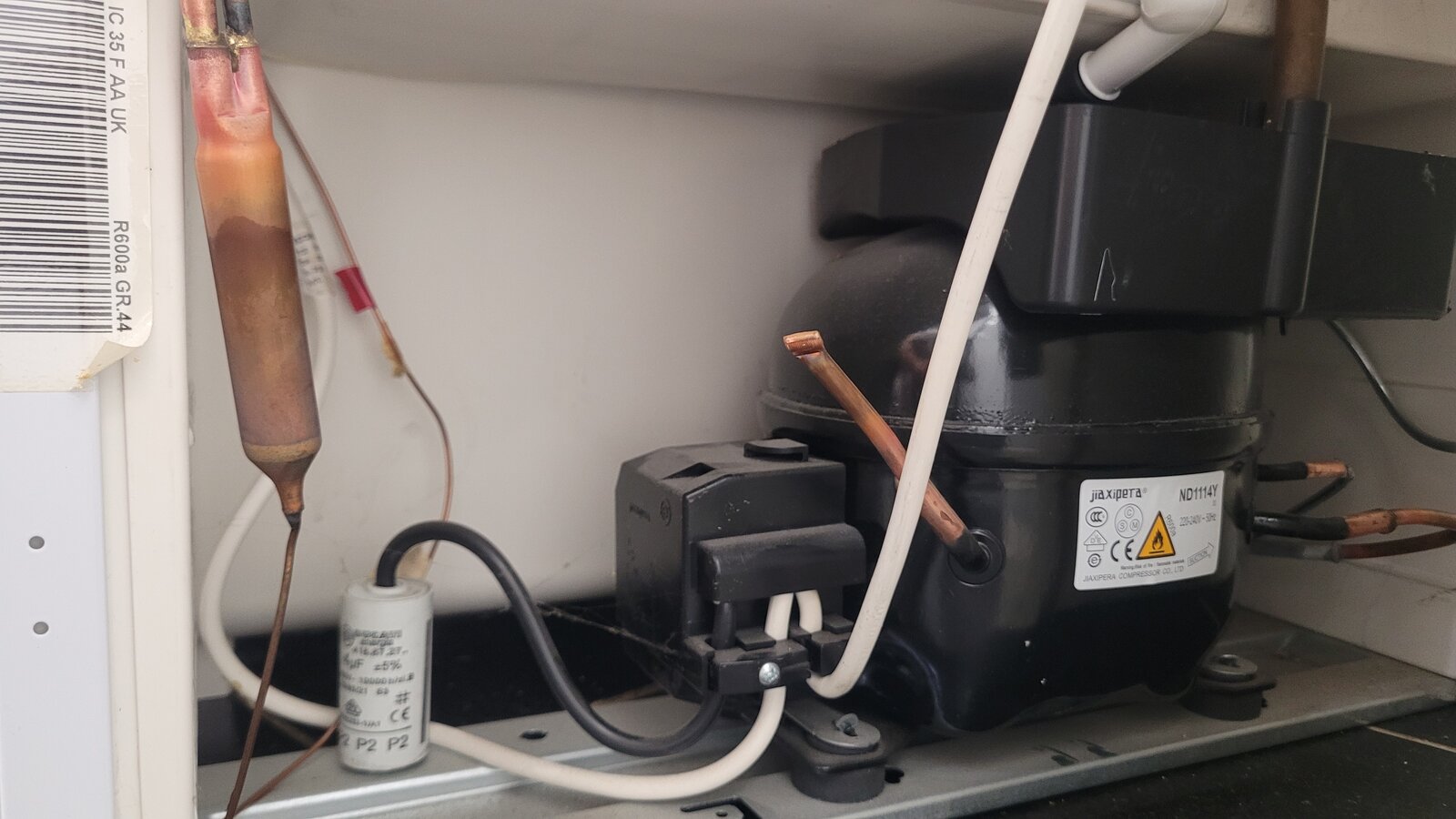

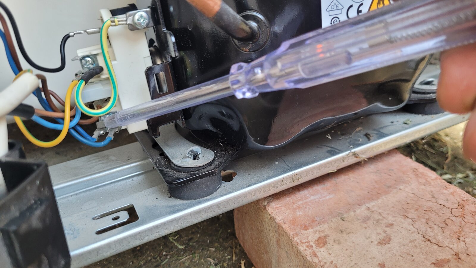

Hi, finally taken the plunge to test the relay at the back of fridge.
Please refer to the attached pics. There is power on the earth as well as exposed metallic parts of chassis!!
However, the live and neutral cables to the capacitor seem to be live.
Does that imply that the relay is gone?
Any basic tutorial on the actual desired behaviour would be highly appreciated.
Thanks.
