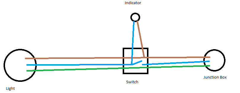

I have a light in my loft with its own light switch is located in the loft on its "own circuit" (it's tapped off the landing light mains but runs independently).
My question is, is there a way to wire in an external LED (or maybe neon) indicator lamp from the switch that I could fit to the loft hatch frame which shows if the light is on? The reason being, if the light is accidentally left on in the loft, you can see if its on or not with the hatch shut
There's unlikely to he a neutral at the switch so easiest way will be to connect in parallel with the loft light.
Or put an led lamp in the loft and stop worrying about it
If the switch has a Neutral as well as Live and Switched Live at the switch then yes you can wire an indicator from the switch using twin and Earth cable.
If there is only Live and Switched Live at the switch then you would need to use twin and Earth cable from the lamp to the indicator.

I have inherited this loft light circuit with the house. From the junction box, someone has run some T+E through the switch and for some reason switched it on the neutral wire rather than the Live. So, the Live and Neutral are running through the switch to the light. It looks like someone has done this themselves because I dont think many electricians get their switches and stuff from Wickes!
Would something like this be suitable for the indicator? https://cpc.farnell.com/camdenboss/cbpi22-230-grn/22mm-indicator-led-pilot-light/dp/MC02598
Would the below work/be safe? I'd have to tap into the Live from the switch so would a choc block be OK in there? Or should I grab the live from junction box and run the neutral from the switch?
That is NOT safe as the indicator will be Live all the time irrespective of whether the switch is ON or OFF.
The switch MUST be in the Live conductor.
That's how its currently wired (bar the indicator), I will change it as it didnt seem right when i opened up the switch.
Not to mention that the cable was lashed across the top of those metal things that hold the roof joists together, if someone put their foot on it, it would have cut through the cable!
Will a choc block be safe inside the switch back box? It's a plastic surface mount type
you would need to put the end of the light in an exclosure for it to be safe
Do you mean for the indicator light or the main light? The main light is an LED panel so the mains wires go into the driver

I wasnt very clear, on the landing where the airing cupboard door is, there is a void between the top of the door frame and the ceiling so i'm going to put a 20amp switch with neon (overkill but i havent seen smaller ampage ones with a neon unless a fused spur with neon is suitable?) there.
This way I can join the cables inside the switch and not need choc blocks. The switch would be on the landing side.
I also remember that the earth is currently completely exposed inside the switch o_O!
