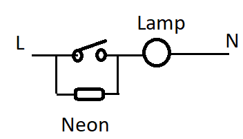

neon lit switch for loft lights.
Because the neon is wired across the switch. With the switch open the voltage across it causes the neon to light, but the current through the neon is so small that the lamp doesn't light noticeably.
That depends what you mean by 'across' the switch.
How is there current through the neon when only one side is connected?
That depends what you mean by 'across' the switch. How is there current through the neon when only one side is connected?
We're surely talking about the situation in which both sides of the neon are connected - one to each side of the switch? If so, then when the switch is open, then (provided there is a load connected to the circuit) current will flow through the neon and load (far too little current to be 'noticed' by most loads). However, when the switch is closed, the neon will be 'shorted out', hence no current through it.

The conductance of the lamp lamp allows the Neutral to reach the Switched Live,

Well, it's obviously impossible that the neon could have lit with only one side of it connected to anything. I therefore assumed that when the OP wrote "the single side of an immersion heater switch" he was referring to (both 'in' and 'out' of) one pole of a double-pole switch.
The 'obvious' (indeed, probably only) explanation for the neon lighting when the switch is off is surely what bernard and myself has suggested, isn't it?
