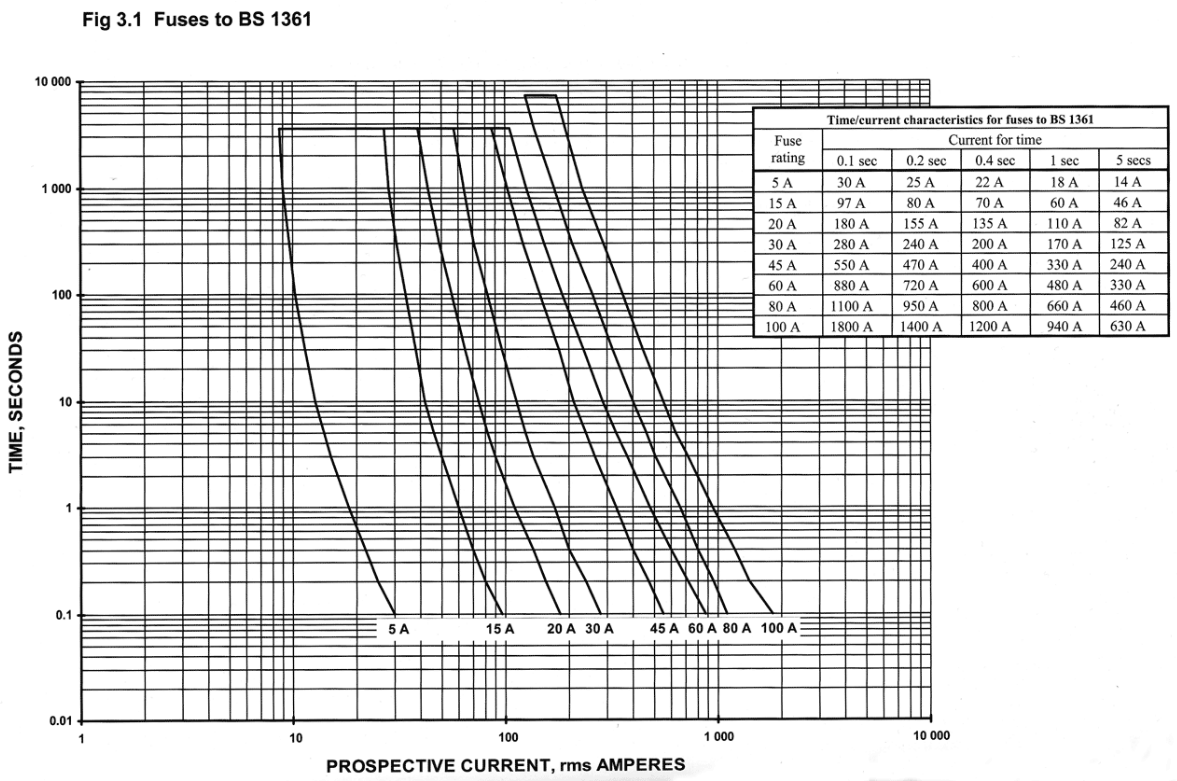

... and JohnD :) If his "pretty well instantly" means less than 1 second, then it looks as if it would take about 500A to blow a 60A fuse that quickly. If he meant less than 0.1 sec, it would need nearer to 900A!
As one would expect from the mechanisms, whilst an MCB will trip magnetically "pretty well instantly" once one has exceeded the magnetic trip current threshold (but not appreciably faster if the current is above that threshold), the speed of operation of a fuse continues to increase "indefinitely" as current rises.
