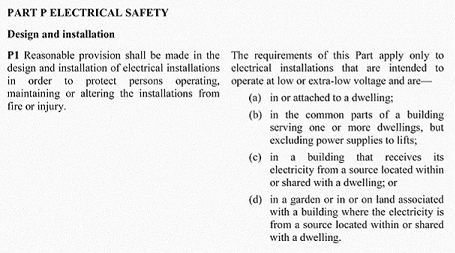

This is Part P of The Building Regulations - The Law:
That is it. There is no more.
Approved Document P is a guide that someone wrote to explain Part P.
