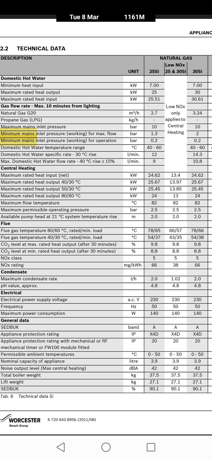

I have a greenstar 30si.... Think max flow is 12litres a min
If I remember rightly this boiler is flow limited (not sure what to, would need to check) though it is rated @ 14.3L/Min @ 30Deg rise though that would need a min dynamic pressure to attain that, to overcome the resistance in the plate, it's usually around 2bar.
You are right, 2 bar minimum to achieve max flow rate.
Max flow is 10.8 +/- 15% - so @ 2bar I should get 9litres a min. Which is what is on my commissioning paperwork for the house. (2 bar/9litres a min 50degree rise taken as 7degree cold water inlet temp - 57 at all outlets )
I have 2 bar still and 9 litres from my cold tap - but 6litres/min hot.
This surely enough to make the boiler cycle on and off whilst I'm showering (observed the boiler flame out and back on... Repeatedly)
So this would point at a furred up hex?
I know I'm on the minimum - but everything always worked at the minimum, so I guess when you work at the minimum pressure you have a lot smaller operating window for my size boiler to keep running with flame rather than cycle.
