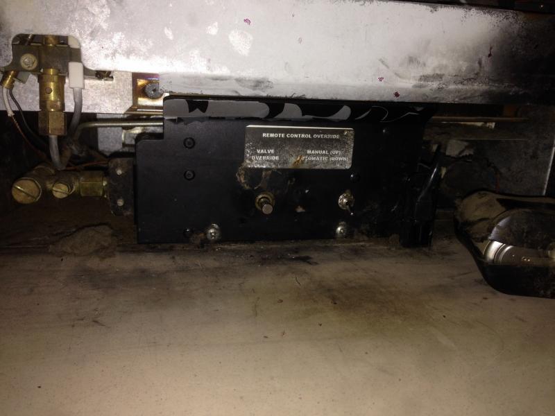

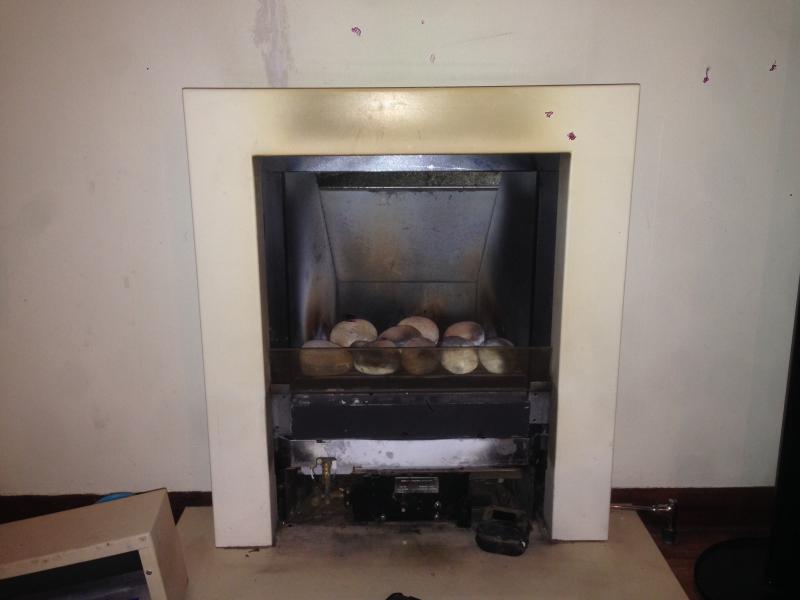

Good evening. I wounded if you would be able to help. We have moved into a new house and we have a gas fire fitted. The old owners have not left us we any details of it and are unable to use it at the moment. I believe it is a inset gas fire but I can't find and other details of it. Would you identify it but the couple photo I have attached. Hope you can help. Regards
Also I have contacted someone else regarding the same issue and sent them the same photos they are saying the fire is unsafe to use. When I ask why they didn't say
From those pictures I would not be using that fire!!!
Get it checked first hand by a registered engineer with the appropriate accreditation.
Gas Fires are crap anyway - consider having it removed.
Apart from several other points, the singe marks on the frame above the fire proves the fire exhaust is spilling into the room.

It is in a very poor condition! It looks like a Flavel or a Kinder, but I don't recognise what looks like a glass section at the bottom of the coal set. It might even be from a comoany called LFE Fires, who went bust years ago. If it is a Kinder / Flavel, it is probably obsolete.
The battery pack is Lithium, and cost about £45 each - and struggle to last a year! Have you got the remote?, it is very awkward to use without it. Contrary to Dan's assertion, not all fires are carp, but I fear that your best course of action would be to replace it. I would certainly not use it in the current condition.

I wouldn't use that! Time to get it replaced by a Gas Safe Registered engineer with a qualification in gas fires

No we haven't got the remote. That is the main problem as if we wanted to get it tested to see if it safe. We probably can't without been to operate it.

With respect Welchy, if it is a Kinder, I probably would find a remote for a nominal fee, but I wouldn't do anything to encourage you to use it! The staining above the fire is a worry, so you absolutely need a pro in to sort it.

You could get a local RGI to service/maintain the fire, and he should be able to do it without the remote. He would then be able to tell you if there is any point in pursuing it - but you will stand the cost of labour to assess it.

Dude - You have been told by several registered engineers that that fire is fooked. It might be repairable, but the cost of anew one will be cheaper - probably.
Why move into somewhere and then kill yourself? It might not be on top of your list, but FFS don't use that fire.
As has been said Welchy, the telltale signs of singing on the fireplace above and the blackening of the coals shows that it is not working correctly and is potentially very dangerous.
As Dan and Fireman state, it's a fair bet (99% sure) that it WILL be condemned by any competent Gas Safe engineer and will need to be removed/replaced or at least it won't be financially economical to fix.
