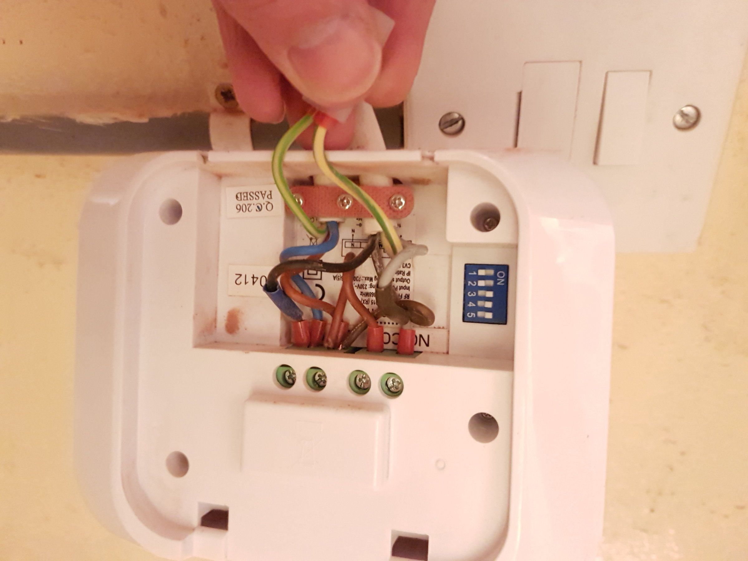

I've got a Next 3rd generation and would like some guidance on the wiring for the Heat Link as I'm struggling to follow the wiring diagram in the manual.
Existing thermostat is Drayton Digistat SCR - wiring is shown in the attached picture.
Can someone tell me what wires goes where? Does the common from the SCR go to the common on the Heat Link? Do I need to join the L and N wires for the Heat Link in the same way as the SCR?
Also, the wiring diagram shows a link wire between Live and T2 on the Heat Link so I'm confused! Thanks.
You're looking at the wrong diagram, if you connect it as per that diagram you will destroy your boiler pcb. Follow the Dry Contact diagram with black and grey in 2 and 3 on the nest. Ensure the earth wires are still connected together.
Thanks so much for the guidance.
So just to confirm - I'll just connect the two Lives and two Neutrals together and run them into their respective terminals on the heat link, black wire to T2 and grey to T3. There's no earth terminal in the Heat Link so should I just join the two Earths and wrap some insulation tape around the join?
