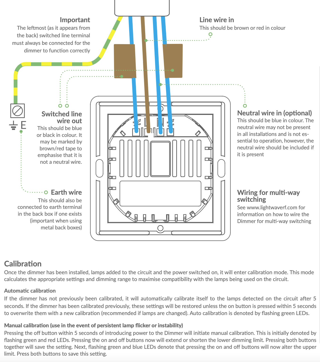

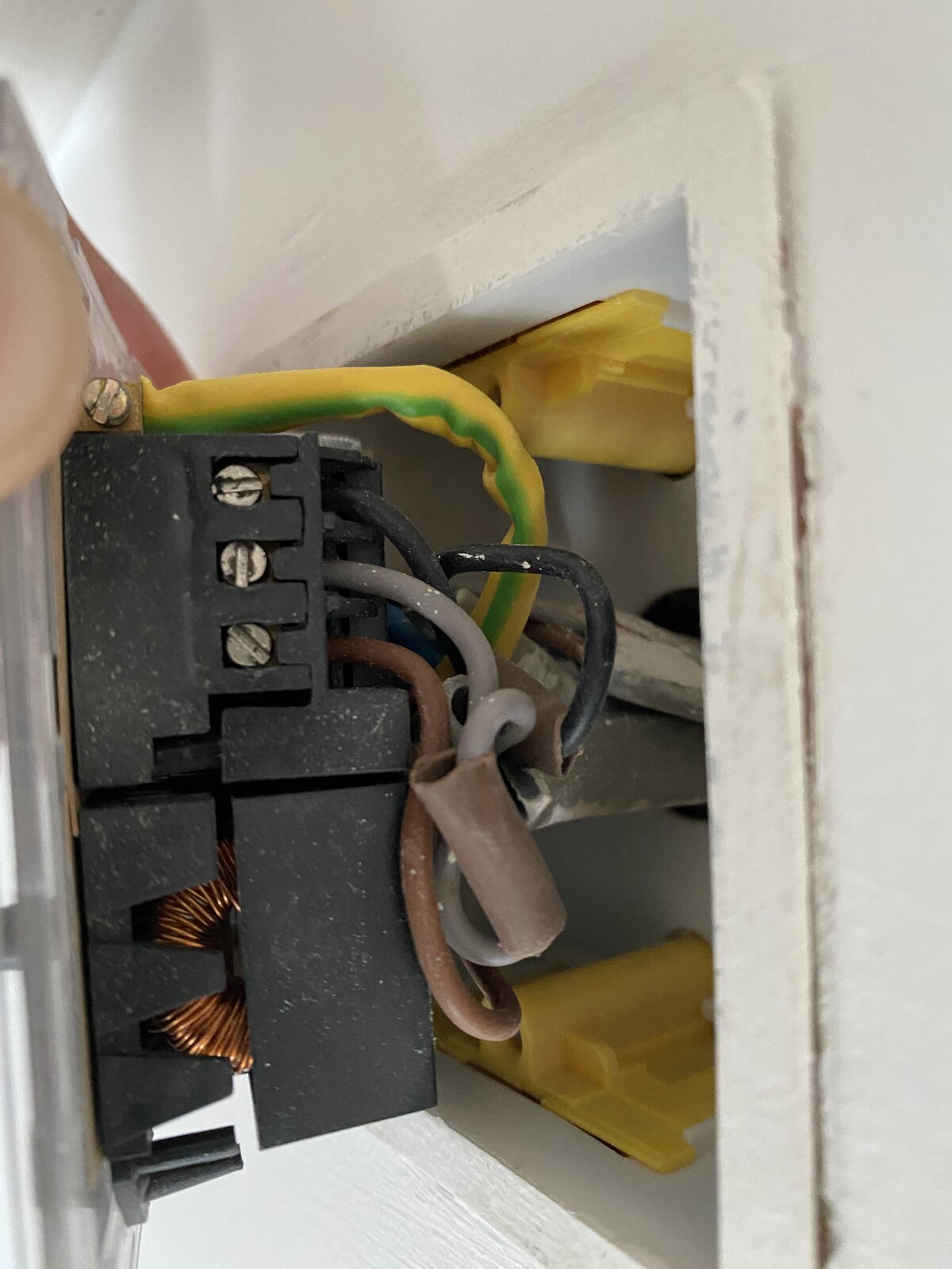

If you have a look at the U-Landing-A-1 and B-1 images, you'll see how the old switch is wired up. I have taken one picture from the top and the other one from the bottom.
It has L1, L2 and C terminals (left to right).
From the lightwave website (the new smart switch brand), they say to move all wires from the L1 terminal to the L port and from L2 to the X ports on the new switch, while capping the C port off.
Code:
For both switches, move all wires fitted to the L1 to the L terminal on the Lightwave switch. Move all wires fitted to the L2 to the X terminal on the Lightwave switch. Wires in the C terminal are not required and can be safely terminated or removed altogether.

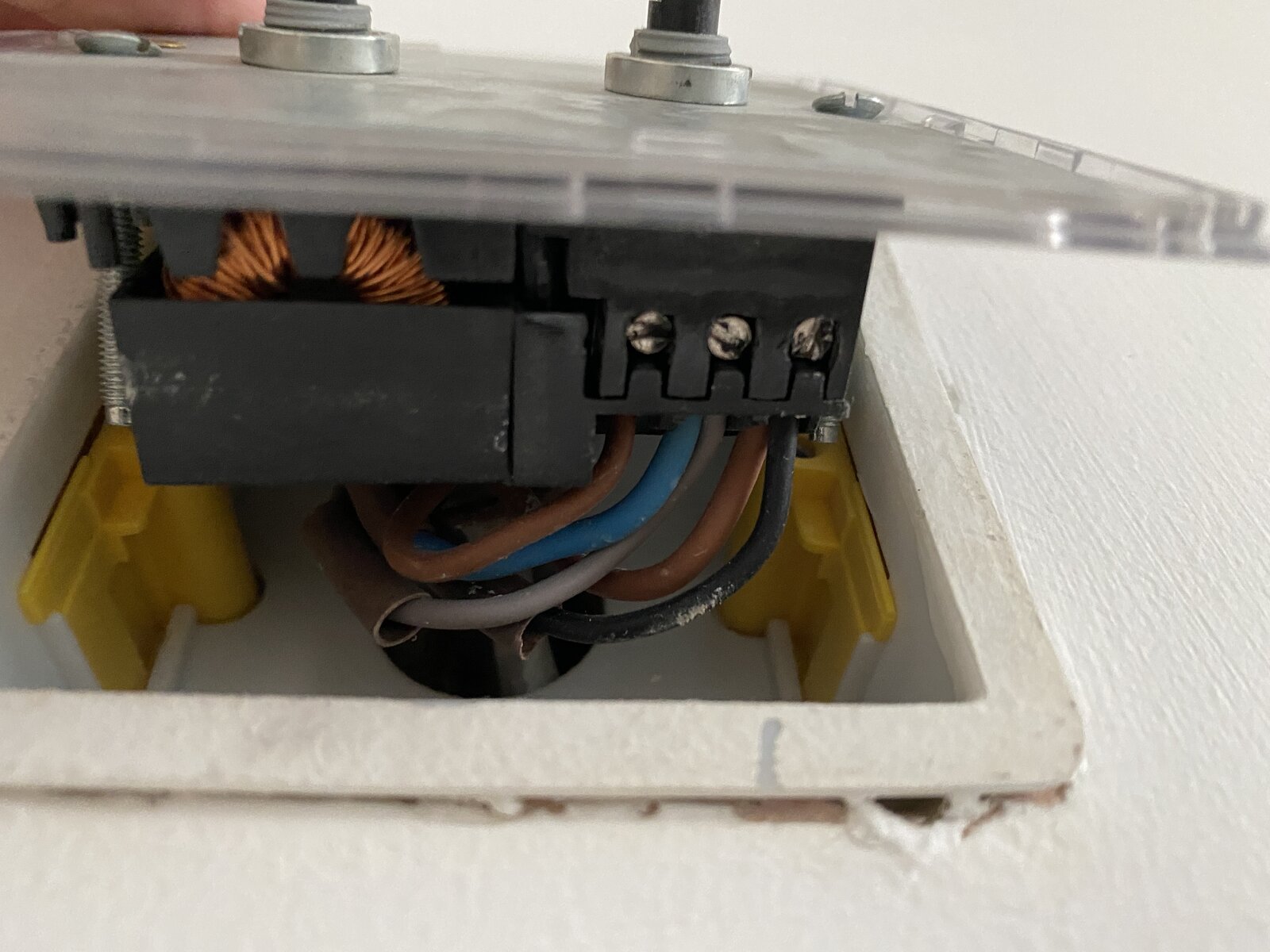

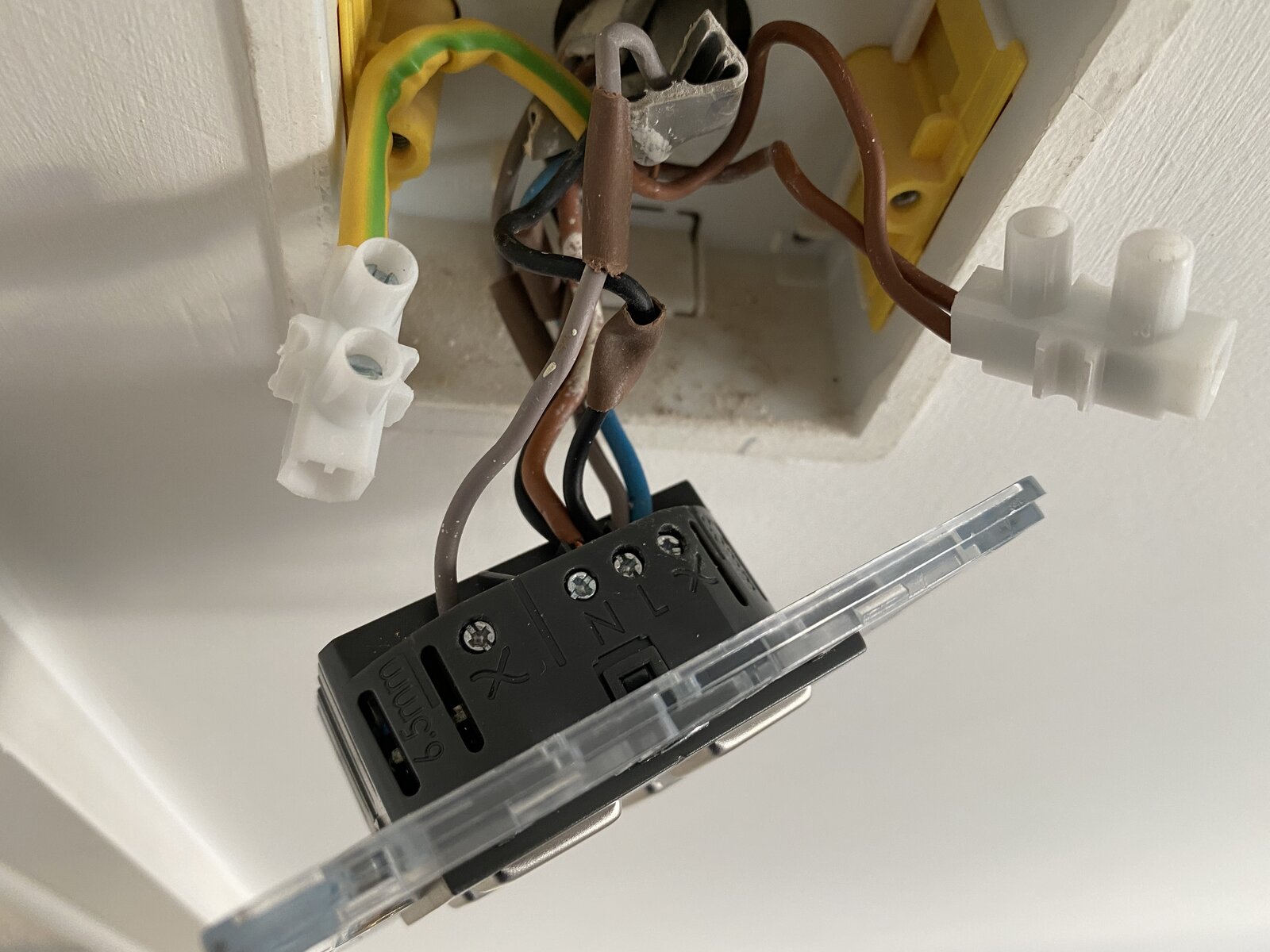

So this is what I did as shown in the "Initial Wiring" image.
This tripped the breaker in the fuse box when I switched the power on.

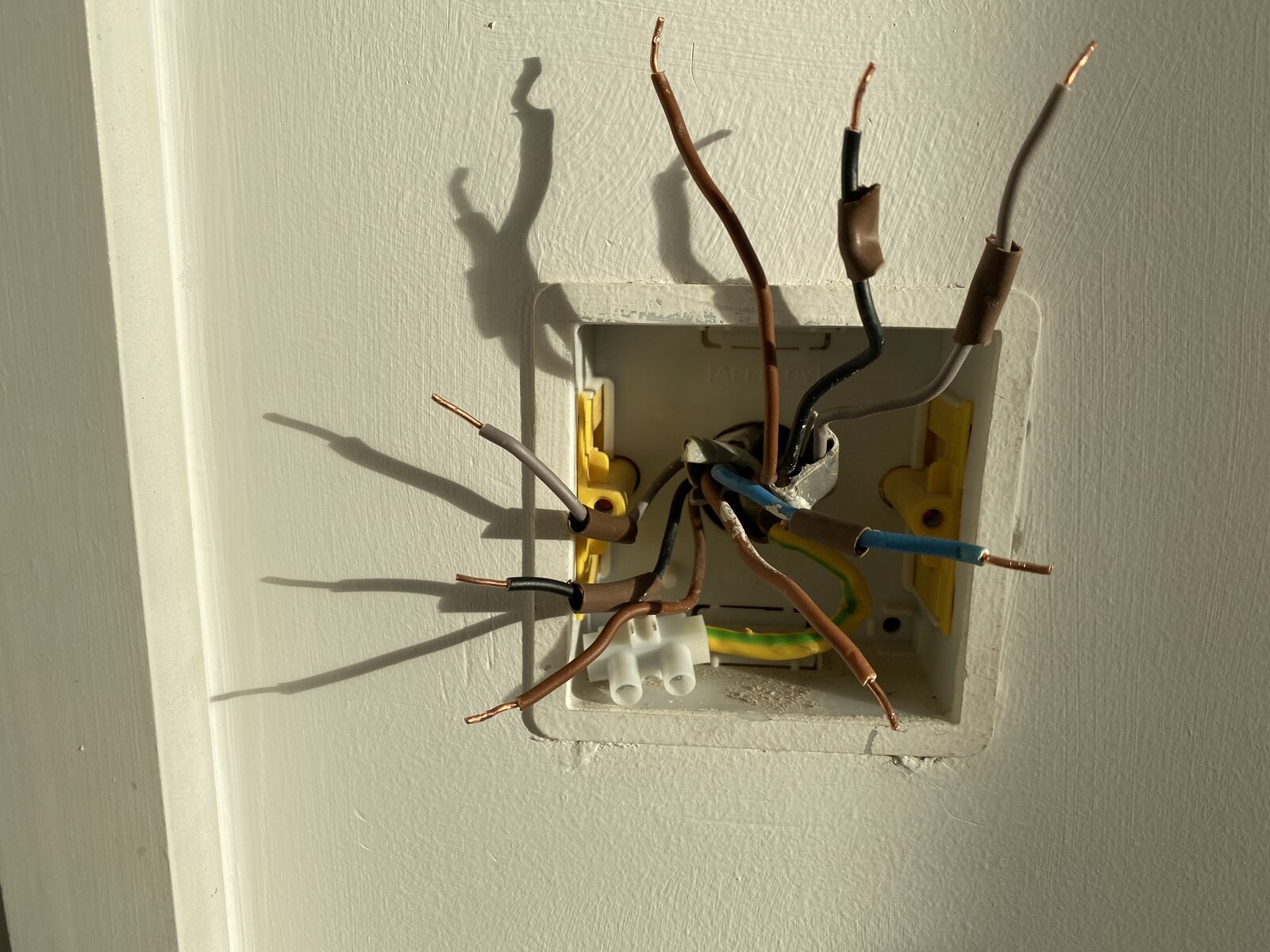

So I disconnected everything ("Separated Wires" image) and decided to test each wire to see which was live with my multimeter.
There are 3 main sleeves coming from the wall. You can see I have separated the wires - left, top and right according to which sleeve it was coming from.

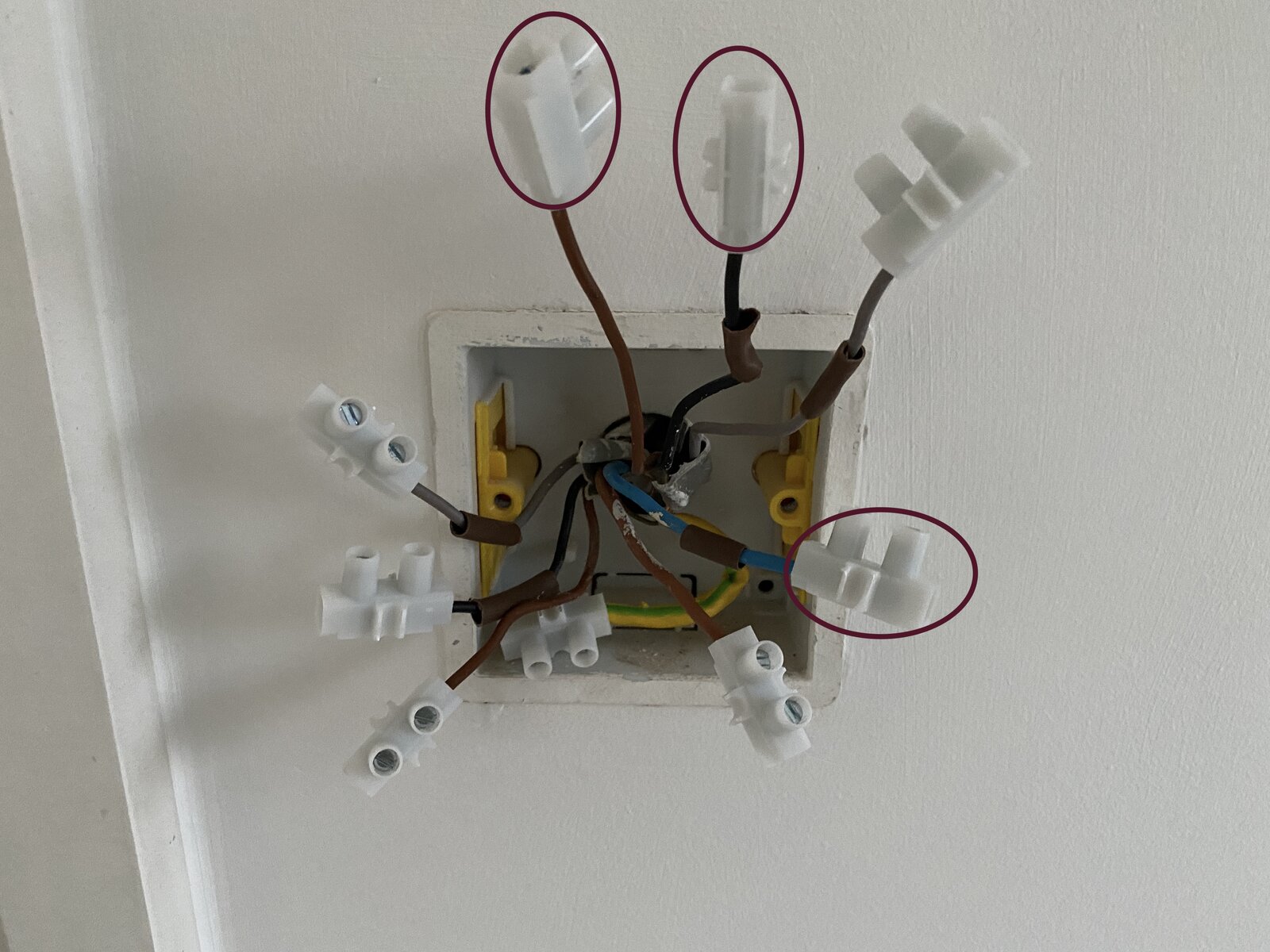

Anyway, have a look at the "Separated" image. I have put connector blocks on all of them and I have determined that 3 of these wires are showing about 240v on my multimeter. I have circled the ones which were showing the voltage.
I think the small brown sleeves are put on the wrong wires. Shouldn't they be on the switched live wires only?

So pictures of wiring don't help much, for non smart switches the on/off go com to L1 where in two way often L1 and L2 but colours mean nothing.
Is your first pic ( initial rewiring) a two gang ,two way switch ??
It looks identical to the two gang ,one way ,switch of your other thread ???
If the wiring is from two circuits , it's surely going to trip an RCD or RCBO ,if the wiring is interconnected ?
First off. If the two circuits are on separate lighting circuits, they cannot share the same Lightwave switch. If you try and common the lives or neutrals from different circuits all this will do is to trip any RCD in the circuits. You will probably need two separate one gang switches, not a combined two gang smart switch.

I am afraid you have gone way outside of changing some light switches and have created a potentially dangerous installation ,by interlinking 3 circuits. I too must advise you to engage an electrician to undo what you have done and re instate the safety of the installation .As soon as possible.
Thats what the guy at Lightwave told me to do. Because of the single L terminal on the Lightwave switches, it had to be interlinked.
JH
You can't use that Lightwave switch safely on your installation. Full stop. The installation would require significant modification. If you carry on you may get it to work but will compromise the protection provided by the MCBs in your CU.
Best advice is stop now. There would be significant work required to make it work safely and correctly (translates as significant costs to pay someone else to do it).

I was reading the Lightwave instructions, and it says
The Smart Series dimmers do not use a signal cable for multiway switching so they have to be linked together using the Link Plus app.
So if there is no wired connection, why work it matter where the switch gets power from?
I use a remote control temp.jpg but in essence the second switch is no more than a mains powered remote control. But myself and @Taylortwocities have given links to the set up, and I will admit I did not realise they worked in this way, and since reading have been considering also fitting one.
