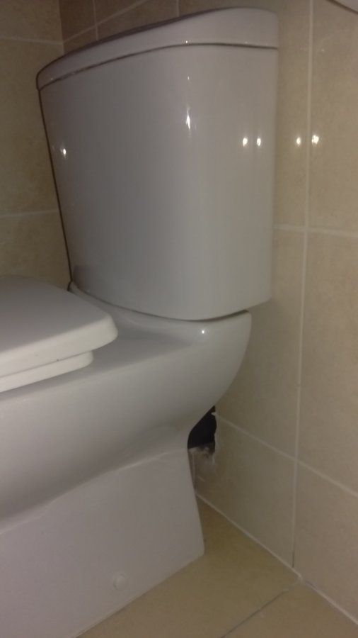

Hello ,
Sorry for the late response. I have attached the photos of the toilet. The black pipe is a new addition after the leak. I think that he has reused the pan connector though. Would a close coupled toilet which sit flush with the wall fit with this new extended soil pipe?....

Probably not in that you wouldn't get a flexi short enough to fit in the space BUT cutting the black pipe closer to the wall should work.
