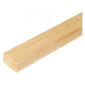

I agree a 3x2 is 70x50 but cls never has been it's planed to 63x38 finished size
Thats not a finished size Madrab ,no CLS actually measures 75x30mm.Apols it should have been 75x50mmPremium CLS Softwood Studding 75 x 50mm (3
Buy PEFC certified 75 x 50mm (3in x 2in) CLS softwood studding at Selco. Available with Click & Collect or next day delivery.www.selcobw.com
Just as well I'm not a joiner, I'm obviously still not on par with metric ... What's the point of calling it 3x2 then, @ 63x38 it's no where near 3x2Thats not a finished size Madrab ,no CLS actually measures 75x30mm.

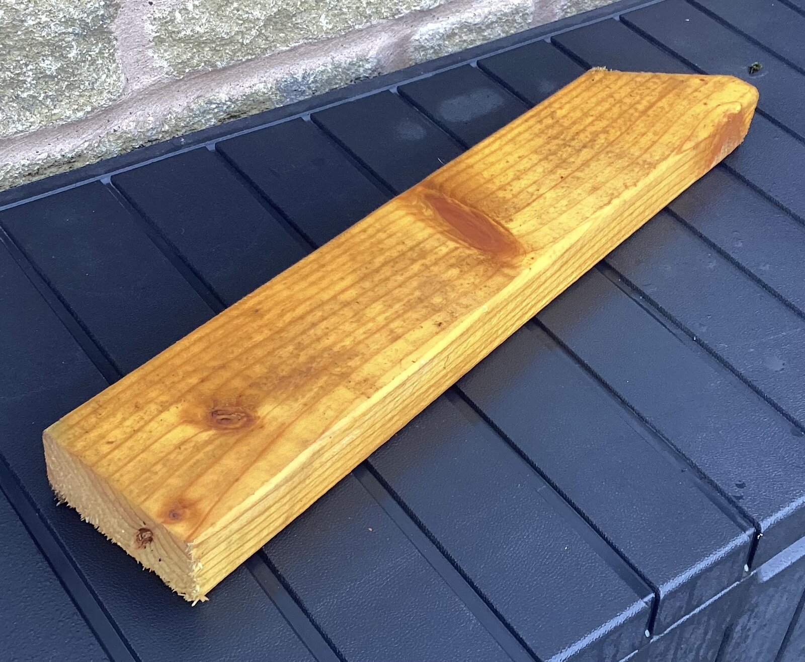

Given that I live a long, long way from the nearest building materials supplier, is there any reason why I shouldn't hang the radiator using wood I already have and shown below? For all i know it may well be cls, I only know that it's treated. If it is suitable, I could easily cut the depth to 33mm leaving 3mm for filler. The wall is completely internal.cls-softwood-studding-75-x-50mm
Absolutely no reason not to.is there any reason why I shouldn't hang the radiator using wood I already have
