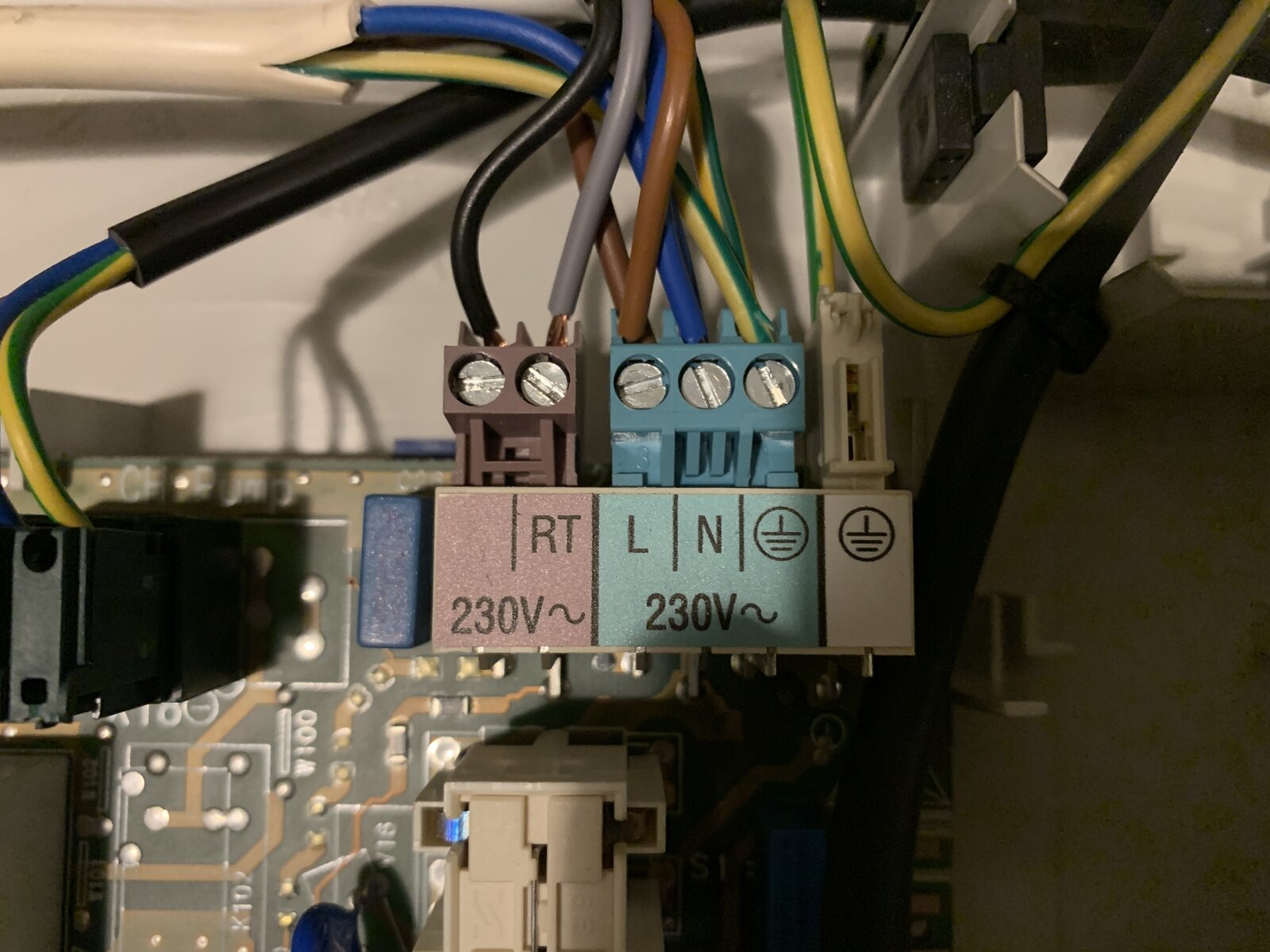

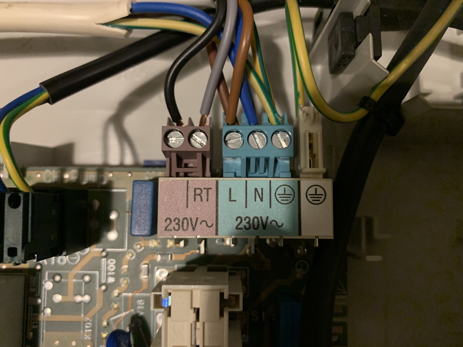

Installing hive reciever in vaillant eco tec 24
if you have another timer somewhere or built into the boiler that will have to be set to constantly on
It was always set to constant on as heat was just called when ya turned the dial, the hive clicks and turns green when ya call for heat. But sounds like it’s not closing the switch.
Current set up, gonna take the left rt230 out and in the hive reciever, put a loop from common to live ?
