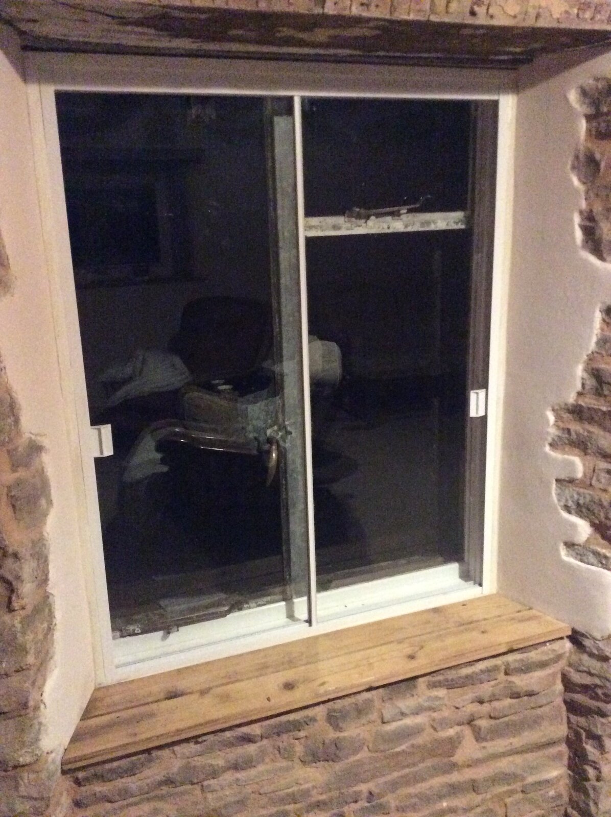

Ive fitted some secondary glazing inside some Crittal windows because I didn't want to disturb the stonework and they are small so didn't. want light reducing with thick frames. So far this winter theres been no condensation at all F461F23F-FD3A-4661-ADC4-3E56F8B2B055.jpegF461F23F-FD3A-4661-ADC4-3E56F8B2B055.jpeg
Yes secondary glazing will fit BUT not on a brand new , being built extension. It would be a building regulation fail to put old single glazed crittal windows in
