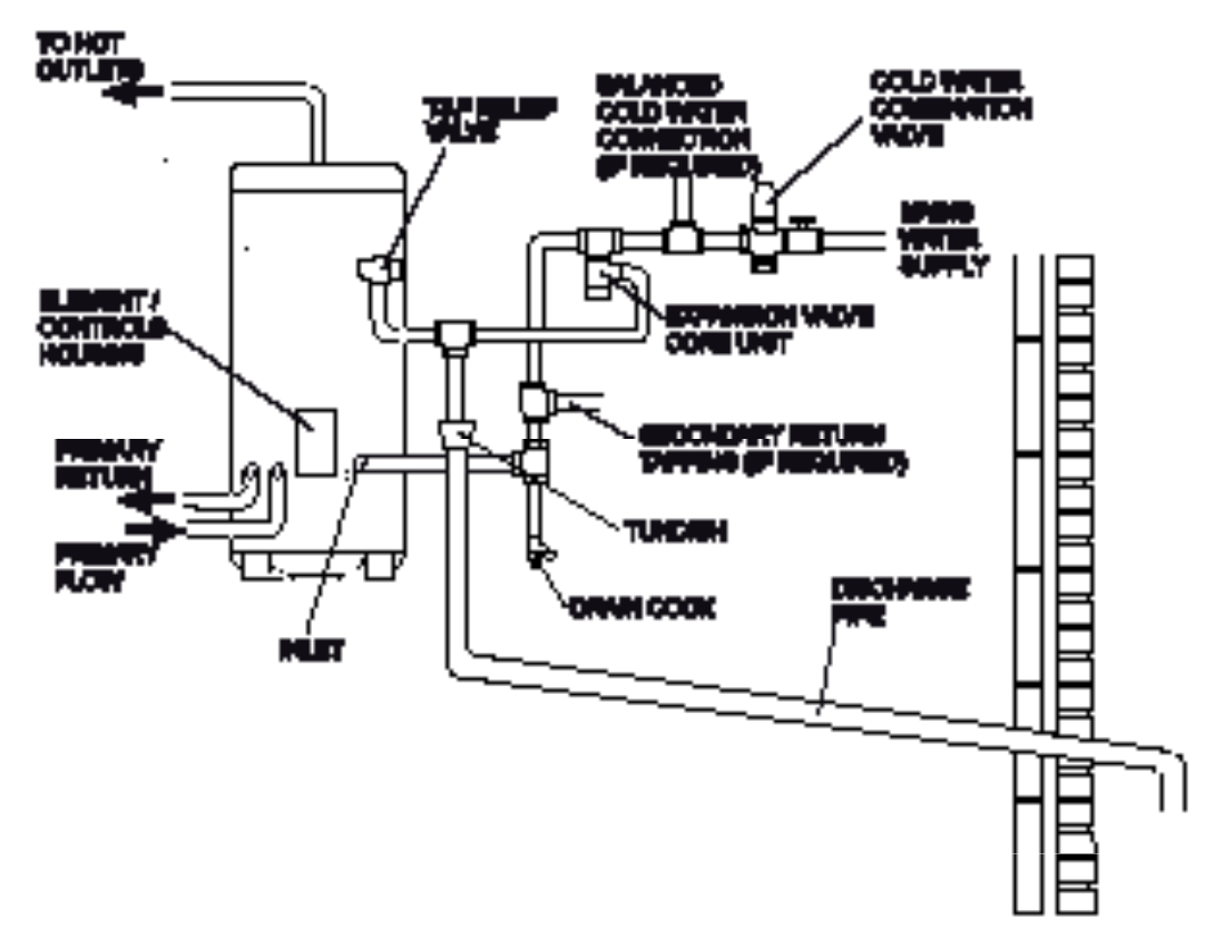

What excellent diagrams that document has

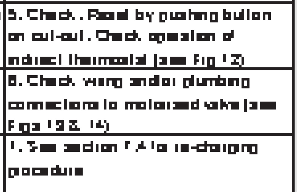

Some of the accompanying figures and tables of the manual are a bona fide scandal!
