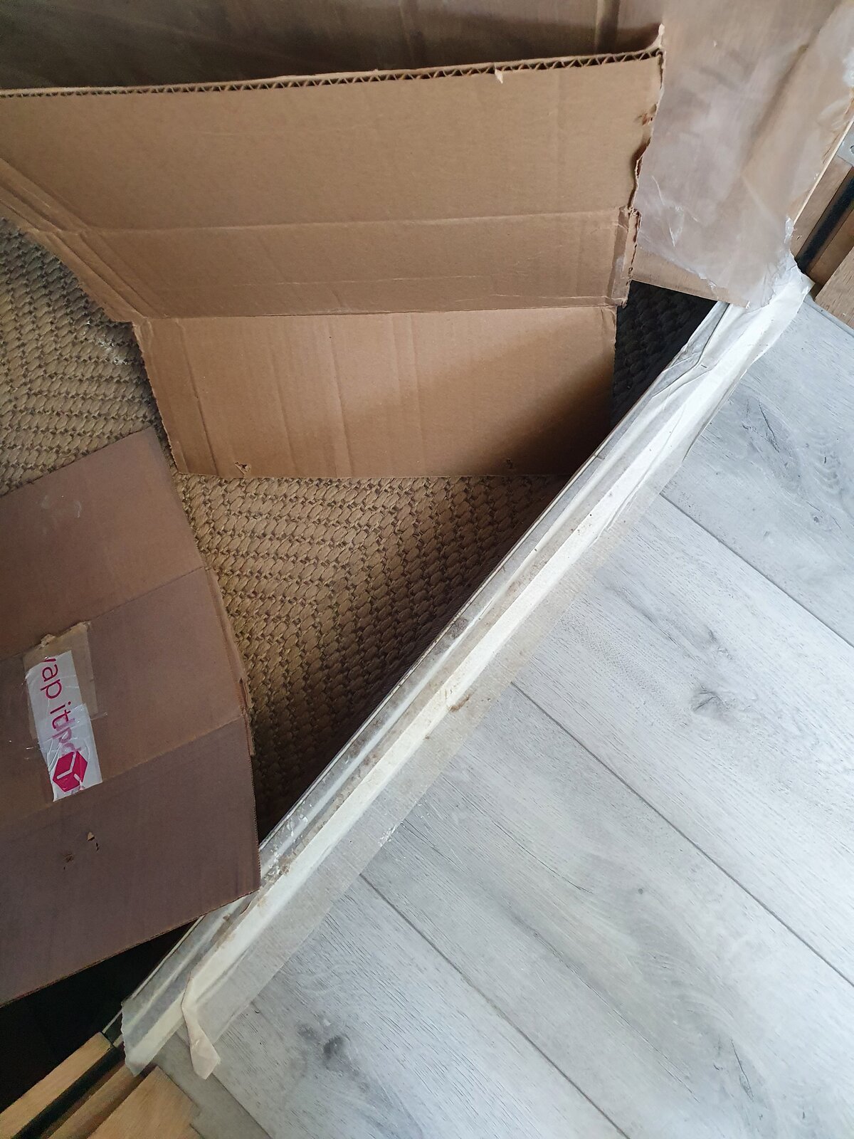

The kitchen has direct access to the garage by way of a fire door with self closing mechanism and strip etc. I can't see any gaps around the top and sides of the door between the door stop but there is a slight gap at the bottom, the flooring has bowed slightly which means the gap is not completely parallel to the door.
At this time without any heating or cooking, the temperature in the kitchen is 11-12 degrees, outside it is about 5 degrees Celsius. It's bloody cold. I have turned the underfloor heating on but before I address the cold issues I'm just wasting the energy.
Has anyone successfully insulated a door to the garage? With what method? Regarding the gap at the bottom of the door, I'm not sure what the best solution would be if the floor is bowed slightly. I'm also thinking of putting insulation under the cabinets, although I can't feel any draughts, the cabinets are freezing on the inside. Basically I just want to attack the cold from all angles. Please help :cry:

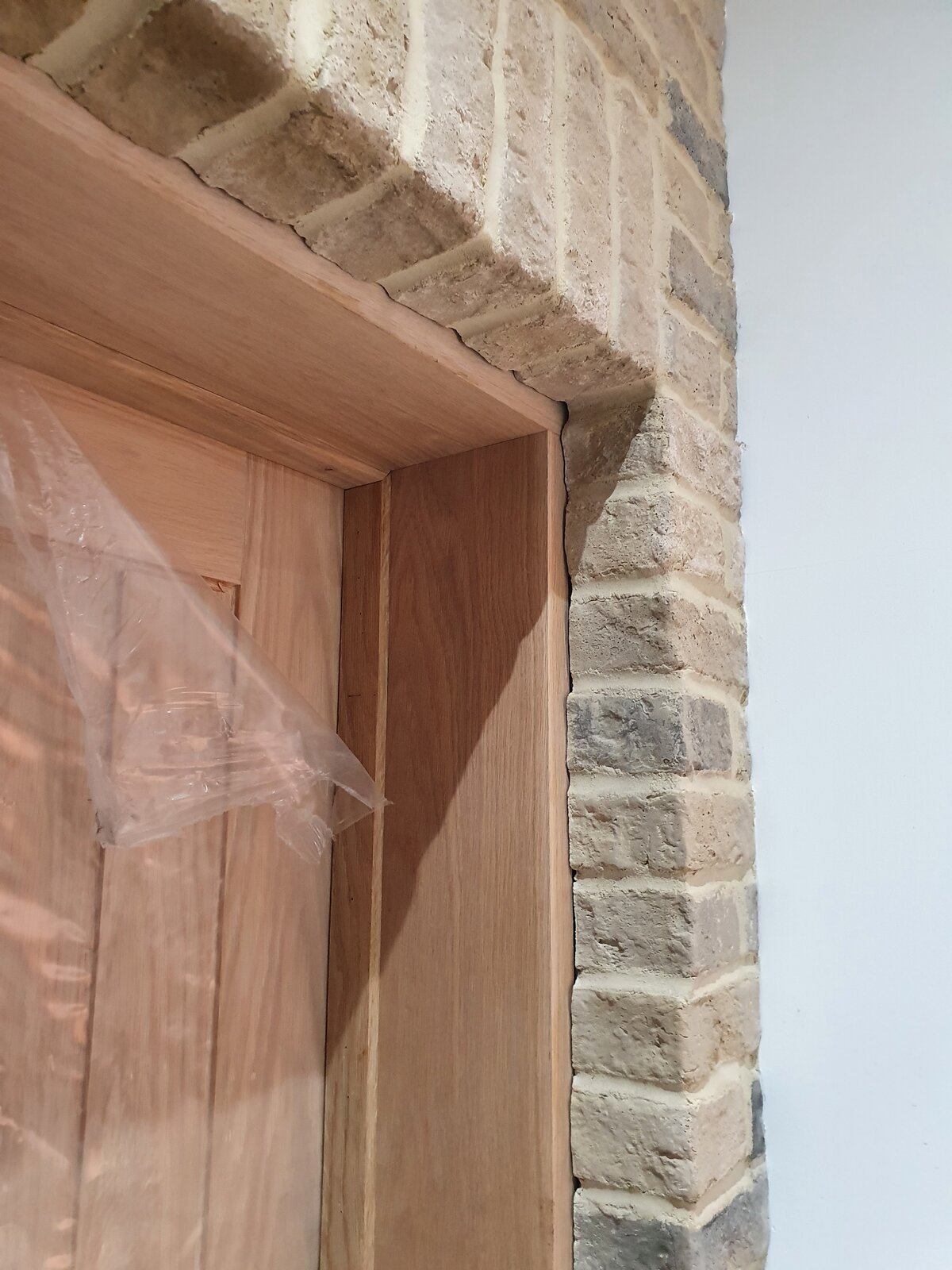

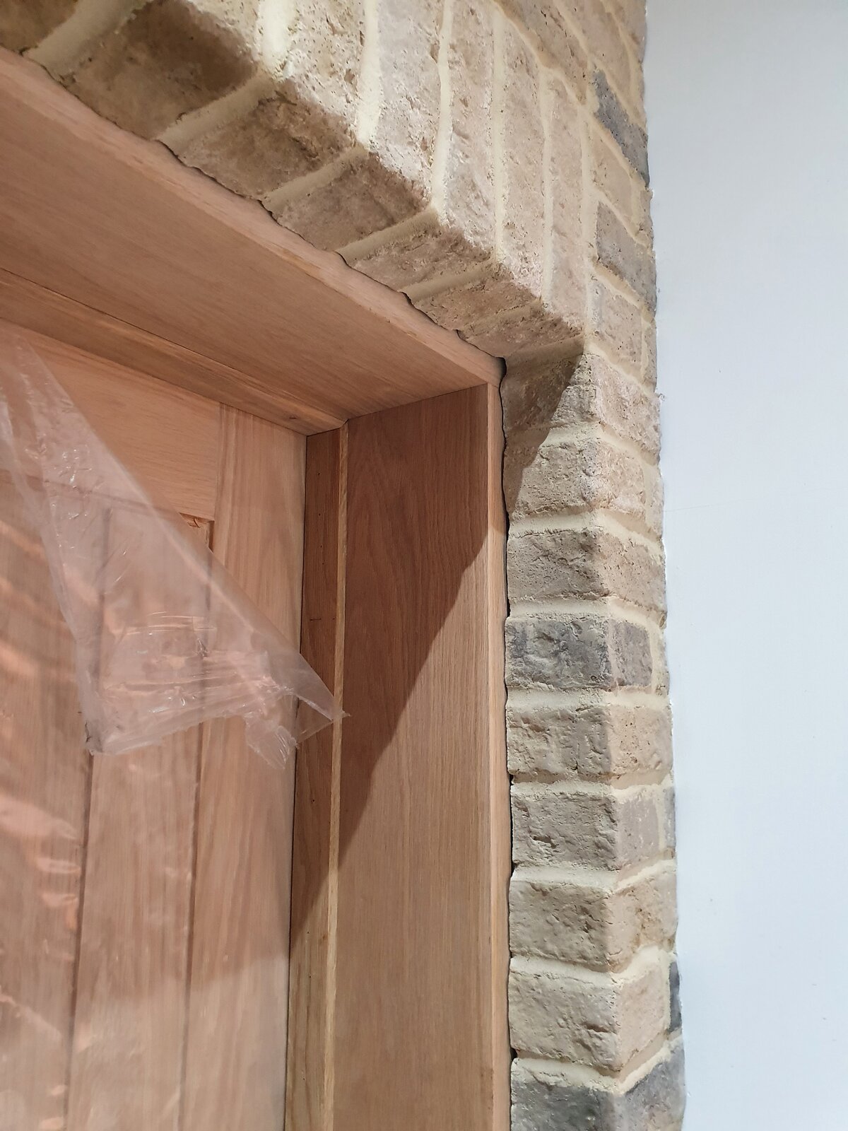

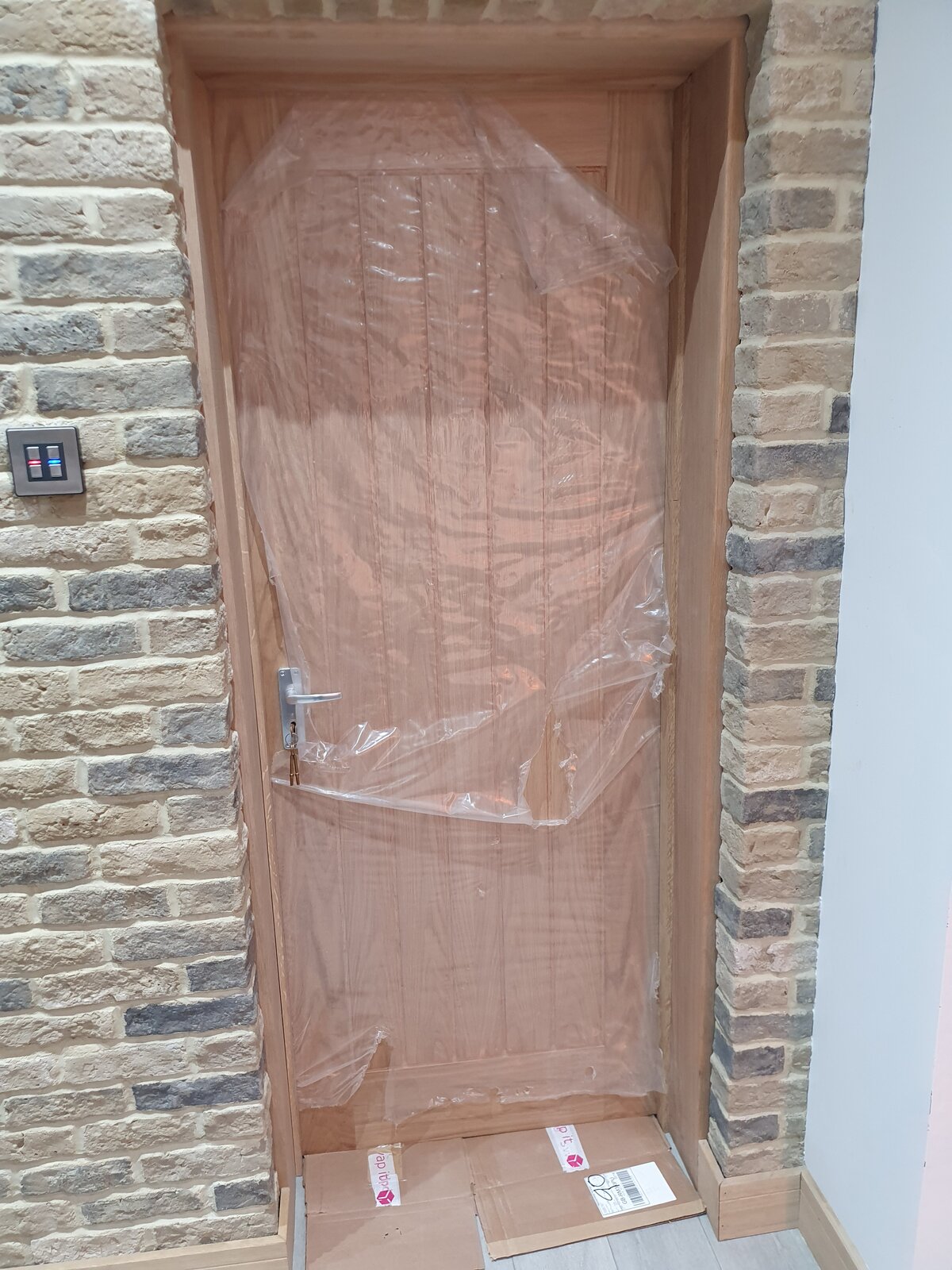

Some pictures. If I just stand in front of the door I can feel the cold air.
The draught under your door won’t Solely address the cold temperature inside, I suspect your under floor heating won’t be man enough to heat your room properly on its own.
You’ll need to provide more pics of the interior, and sizes etc to see... regarding the door, is there any seal on the bottom of it, rubber or brush strips?

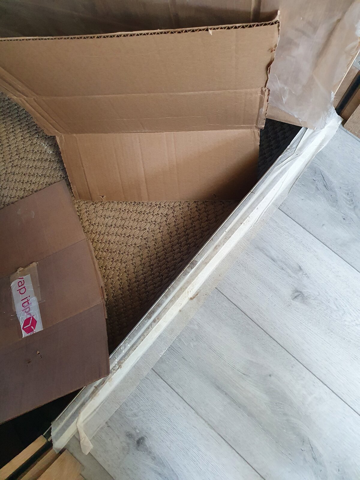

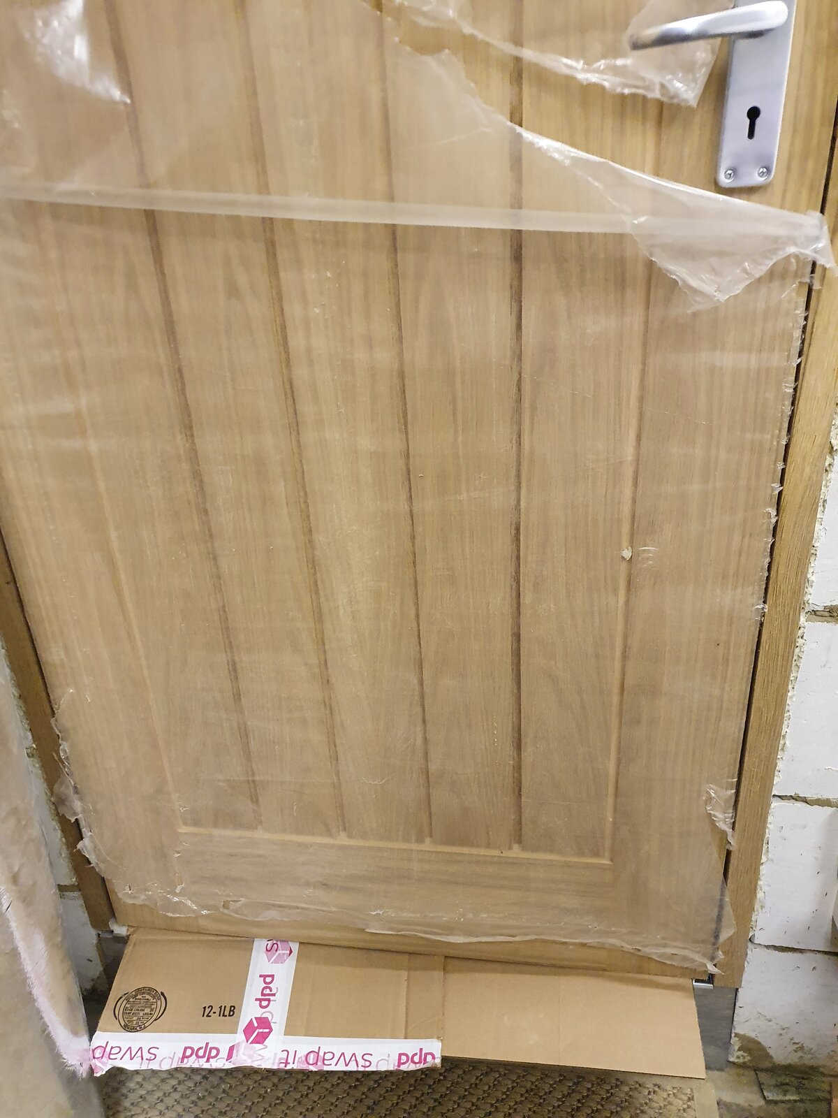

Please open the door and take a pic of the door threshold/cill area.

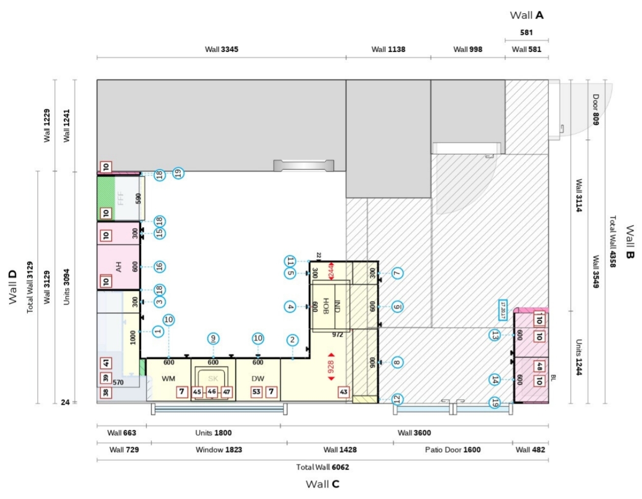

It just has a corner threshold with two rubber strips that are not in contact with the door. The kitchen area is not huge. The garage door is the one at the top centre left.

so what does it add up to for the room?

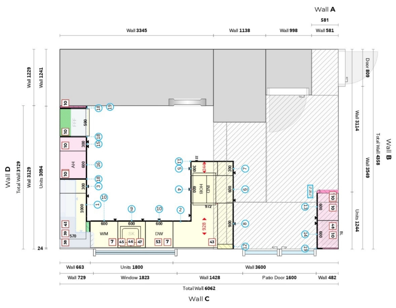

thanks. 1680W. And it's about 3 metres by 6 with a vaulted ceiling. External walls on 3 sides? One window plus patio doors and the skylight?
How high is the ceiling, and how many hours do you run the heating for?
1680w, the mat is 12m squared which is heating the area that is not covered by the kitchen units.
Not much heat input, for such an area and an expensive way heat too. See if you can add a wet kick board heater.
You asked about alternative solutions for the door - could you perhaps add a second door, a few inches from the back from the original? Also check that large skylight for drafts, might you be able to add a second seal to that - a glass or perspex series of panels, to help keep the heat in?
The vault is around 10ft at highest point. 7.5ft at lowest. The vaulted ceiling is only in front of the garage, the rest (original) Kitchen has a normal ceiling. There are external walls on two sides, garden and neighbour, and then one side has an insulated cavity wall to garage (not sure if this is classed as external?). One window plus bifold plus 1x2m skylight in vaulted area. At the moment I seldom run the heating as I need to fix the garage door issue. Normally I would like to run it for several hours in the evening, mainly winters.

I was wondering if the boiler was in the kitchen, but I can't see it in the plan
a fan or plinth heater would help warm the room, but a wet source would be much cheaper to run than electric

To insulate the door I was thinking of something like this:
https://www.amazon.co.uk/Magnetic-I...cphy=9045006&hvtargid=pla-1036614061411&psc=1
We also have an induction hob that has a built in extractor to outside. Yesterday I spent the day insulating the cabinets (loft insulation) that are joined to the external walls from below and it's made a difference of 2-3 degrees so there must've been some draught coming through.
Today I had to leave the garage door open because I was oiling it and didn't see much drop in the kitchen temperature from yesterday, which leads me to believe that it's 90% garage door issue. I have some spare foil underlay that I may place behind the door to see if it makes a difference. Worth a go I think.
