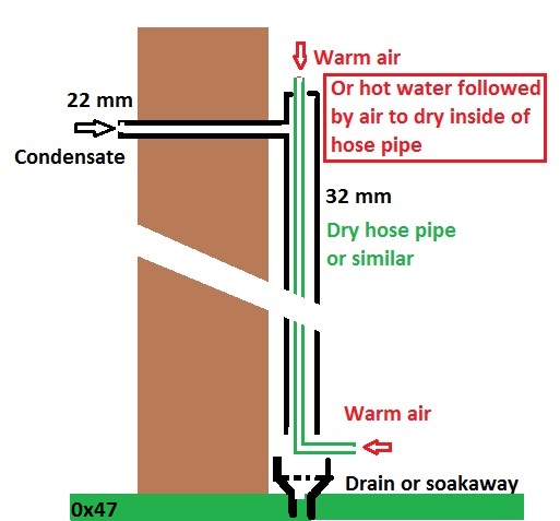

Insulation will not prevent freezing, it merely delays freezing. In most cases the delay is longer than the cold spell.
If freezing is possible then trace heating and insulation is advisable.
Using a pre-installed pipe within a pipe can be effective in thawing out a frozen drain / overflow pipe. The inside of the inner pipe must be kept dry before use and then dried after use if hot water is used. Warn air ( from a hair drier or warm air gun ) from either end is slower to thaw the pipe than hot water but more convenient. Beware water from melting ice getting onto the electrics
No reason why in theory it would not also work for high risk condensate pipework. But regulations might outlaw it.
