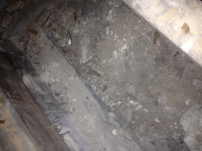

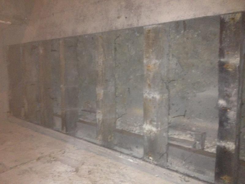

I did a bit more investigating today and removed a few boards.
My void is only 22cm deep measures from ground to the bottom of the joist. This is less than a foot, is this sufficient?
The joists look ok considering they are over a 100 years old although some have signs of woodworm and some are a little rotten but they feel dry. See pic below.
In still undecided on celotex or a mineral wool but which ever I use I'm worried there will be insufficient space to run elec and plumbing above the insulation so can I run this beneath the insulation in the sub floor and then up through the insulation? Wound this cause a fire risk as it would be coming through insulation.
