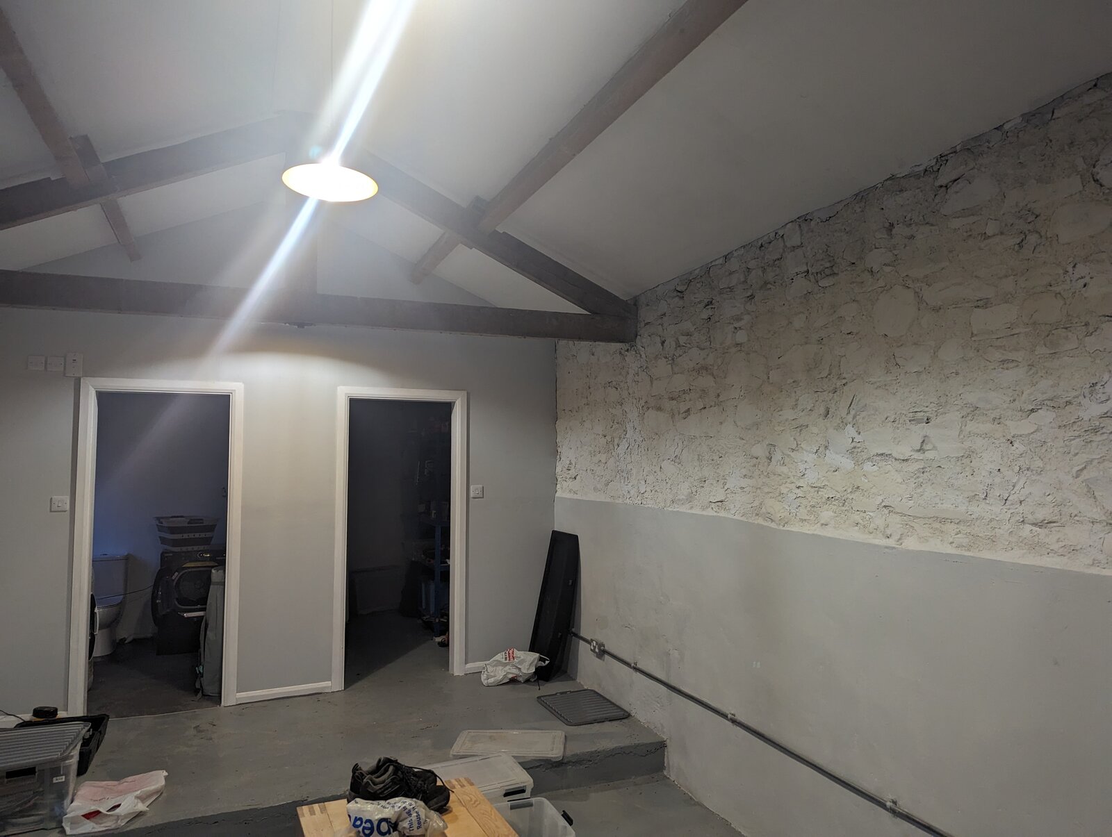

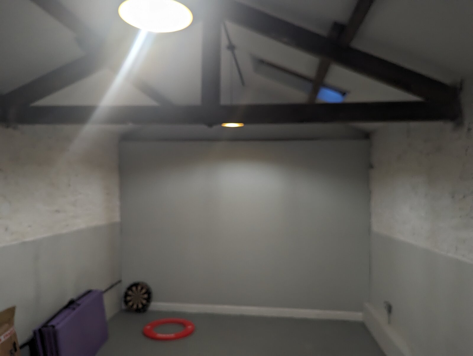

Ive spent a couple of weeks coming back to this thread and re-reading it. A few people suggested what you said, but I hadnt quite understood it until I re-read yours.
Im attching pics this time as I think it better helps to show the room.
As you can see the ceiling is vaulted, so I wouldn't really be able to create a frame that is attached to the ceiling and to the floor....not without it getting quite complex anyway.
I realise now that having insulated plasterboard is going to be overkill....but it sounds like I really need to create a gap between the battons on the wall....rather than just screw to the wall.
I suppose i could drill in supports along the wall to support a floating stud wall structure, as well as fastening to the floor. But can I just confirm, the end result would be;
Layer 1.100mm Insulation dot/dabbed to the wall
Layer 2. Sideways battons secured to the floor/ceiling (as described above)
Layer 3. Plasterboard.
And between layer 2 and 3, place electrics and plumbing, and full with some more insulation?
This methods differs from the method I was going to use, in that the battons arent touching the wall.... which I guess is a positive?
Thanks again for the advice.
