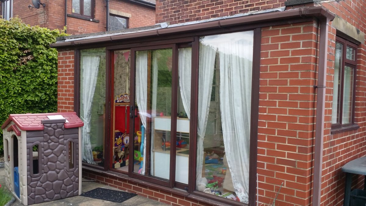

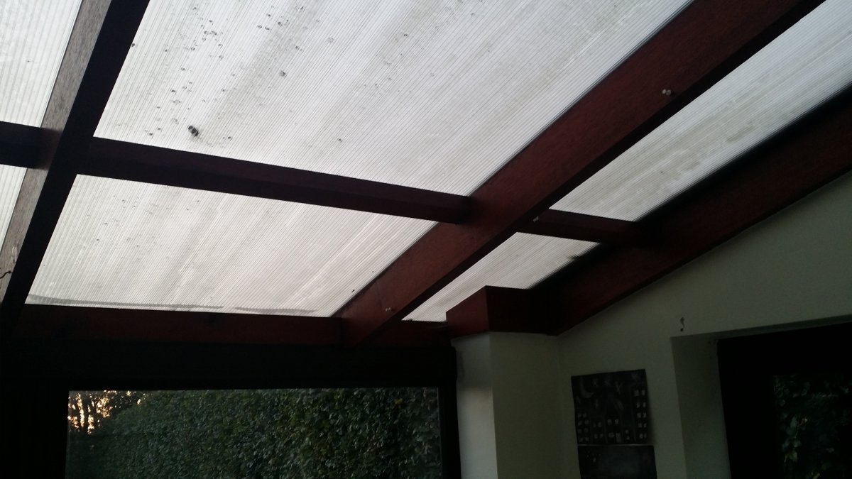

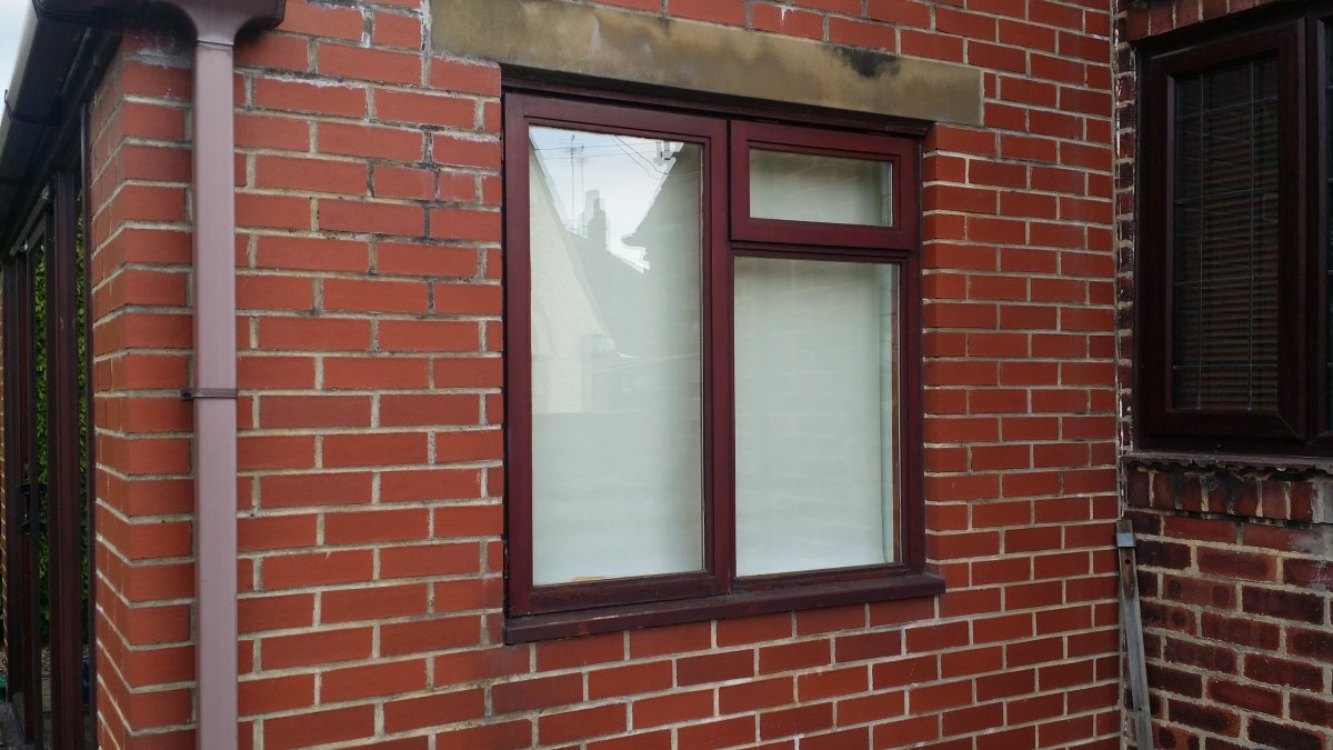

I've attempted to add photos in its current state. The existing roof is awful and needs changing.
I've had an estimate from a structural engineer of £200 to check it out. The local roofer says it will be fine so I'm not sure where to go.
The pitch of the roof is about 15 degs. I do want to plasterboard it and I want to add noggins for this also.

Ok - I'm no structural engineer, but a couple of observations.
- Light, have you covered the roof up to see how much light you are going to lose going for the solid roof?
- spacing, you'll need quite a bit of timber to cover the plaster board spacing.
- the side walls are solid brick, but what kind of lintel is over the patio door, how will you stop the roof pushing that out.
- 15 degree tiles are fairly specialist.
Some end beams to make a triangle would make a difference and possibly retro fitting a couple of tie bar cables.

There is a thick wooden joist running above the upvc windows at the front. I'll double check how this is secured at either end as I hadn't considered the frame being pushed out.

Its the outward forces of the roof that you need to consider, though the house wall helps..
You can buy tie wire kits fairly cheaply - alternatively if your extra timbers can be secured to the wall and beam above the door, then the timber acts as a tie bar.
