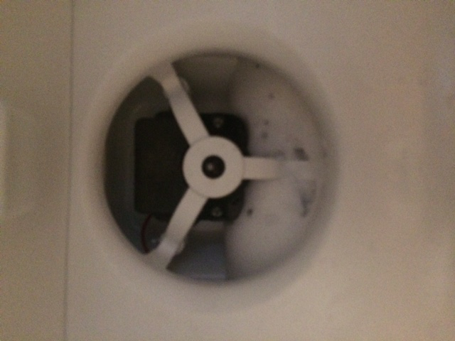

The back panel inside the freezer seems to consist of four pieces; the top one has a metal slotted bolt, the others look to have plastic fittings which look they could be turned with a screwdriver.
As the appliance is integrated, it would make sense if the works could be got at without taking it out of its cab - in fact it would make so much sense I can't believe it ;)
Don't know if there is likely to be anything worth a look behind these panels?
Terry.
jj4091, guys,
Right, we've taken the top panel off and there's a fan behind there :
took fan off its spindle and the area is half full of ice !
Photos are tipped on their side, top should be to the left.
Once we get the ice out of there we'll take a view. There would be a case for taking the remaining three panels off and looking for more ice - e.g. if ice is stopping air getting to the thermostat sensor. But this might get us into disconnecting / reconnecting wires depending on how much slack there is.

jj4091, yeah we found plenty of ice, all concealed behind those panels. Removed some chunks of ice we were able to get at, had to let the appliance stand overnight until no more water came out , so presumably all ice now gone. Re-started and fingers crossed it's now on it's way down to -18 with a gentle purring sounds, passed minus 10 a while ago, as I mentioned above never seen lower than -9 recently The previous horrible noise is gone. Maybe that was the air circ. fan hitting the ice around it dunno. Fingers crossed as I say ... will report back later or tomorrow.
- Terry.
I've never seen a frost free freezer yet & would be interested to know how they can achieve this
they blow the cold air through ducts, where any frost may form, then periodically melt it with heaters, and it drains away. If ice starts to form, it can build up fairly quickly enough to block the ducts, as probably happened here. The ducts are not easily accessible so it's common, when they block, to leave the FF open, turned off, for 24 hours or until all dripping stops. You may need to pull the appliance out from the wall to empty the drip dish.
Sometimes the heater elements, or the control circuit, fails. It might be possible to change or repair the electronics (usually under the top panel) but more often the appliance gets binned. Sometimes it happens if the door is accidentally not closed tightly.
IMO it's worth trying the manual defrost twice, after which you'll know how much of a pain it is and how often it's needed.
