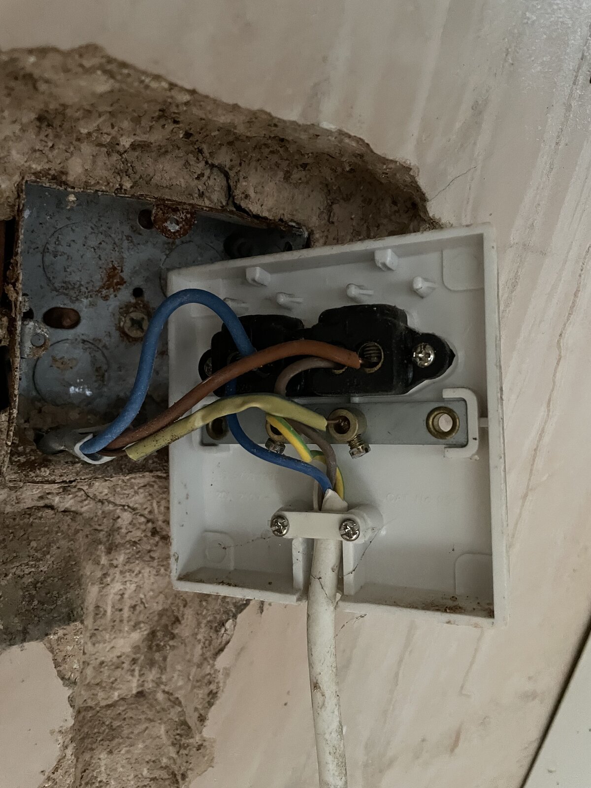

Actually I was wrong- half wrong as it is hard wired but there might be sufficient space to fit a plug at the back. I think that I’m better off using the existing wiring and it also means I can shut it off at the isolator rather than having to pull out each time.

I think the standard size is 60cm deep. Maybe you have a pipe behind it.
That looks like it is just a blanking plate, which someone has repurposed as a rough flex outlet. Behind it will likely just be connectors. Were it me, I would simply replace that, with a normal 13amp socket, which will make it easy to just plug the machine in.
I think you’re right but i would have to cut out a deeper hole for a socket i think.
Thank you for the replies! I ordered an integrated dishwasher as non integrated was going to stick out too much. The dishwasher has a plug so I’ve either got to cut that off and wire in to the existed unswitched spur or replace that with an unswitched socket.
I think the unswitched socket is the best route as I have the isolator switch in an easy to reach location but I’m guessing (with the power off) I remove the current wiring and swap them out. I’ve already removed the old dishwasher lead.
If I can I might replace the back box too as it’s years old and looking worse for wear.
